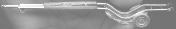

Hunter Tow Bar
Start by cutting and cleaning up the four parts that make the ladder spacer. A sharp knife is important to prevent bending or otherwise damaging the frail brass components. It is very likely that some of the sprue remains after removal so out with a needle file and pair of small pliers. Everyone has their own techniques but I use a combination of the following. For large parts that can be hand held I use the needle file carefully running along the brass rather than across it as this is likely to bend it. Alternatively hold the brass in the pliers so that a minimal amount of required brass protrudes, as well as the area to be removed. Careful slow filing should not cause damage.
Where parts are to be fixed to the flat side of another part the designer has thoughtfully etched a groove so either apply glue to the edge of one part or mate them together and apply glue to the join.
The ladder section requires that fine brass rod be used to create the three required "rungs". Fit overlength pieces of rod into the predrilled holes and adjust the width to match the die cast extension. Then glue and leave to dry. The excess can then be trimmed and filed flush. I found that the ends of the ladder required filing to ensure that when assembled the whole unit is straight. Now glue the "fishtail" section, I found that a bit of twisting and tweaking was required for a fit with the minimum of gaps. You may find it easier to tweak the cast rods before assembling into the ladder. Ample use of thick superglue filled the small gaps left by my construction requiring only a clean up afterwards. The two piece hooks now require folding and gluing. Fixing the other few parts completes the assembly into a nice looking towbar.>

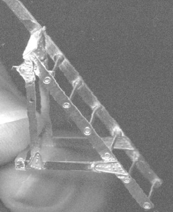

Hunter Access Ladder
This requires the cutting of 6 ladder rungs from the same rod used in the construction of the towbar. Cutting rod to 11.25mm is a bit tricky so instead I cut one over length and filed it down until is matched the length of the top rung now use this one to cut the other five. For easier construction the side pieces are made of two plates glued together to give the required thickness. The inner pieces have holes to locate the rod rungs, making assembly much easier and the outer pieces have the correct detail. The construction diagram has been simplified by only showing the nearside supports. This does require a little bit of thought to get the correct angles and how the pieces fit. Its not too hard but dry run the positioning before hitting the glue. I carefully scrutinised the few photographs that I have showing the real thing and soon decided that at least three designs were prevalent in use. The only real disappointment was that I was unable to line up some of the holes taking one of the rods on the attaching mechanism. (This ladder was mounted into a hole covered by the small oval panel under the left side of the cockpit) If you are intending to fix the ladder to your model, cut this panel out and fix a false cover above the hole. Fix a block of filler on the inside and prepare for drilling the hole taking the fixing rod. The photos I have do not show the detail behind this panel, presumably some kind of locking device on the mounting tube. This is inclined upwards from the aircraft at a slight angle. For extra authenticity build the ladder and leave the supports off. Fix to the drilled mounting hole and position the ladder. Now you can set up the supports for best fit. It's a bit fiddly but the result looks fantastic. A choice of colours is also available for this item, being painted red, blue, yellow or green in later service.

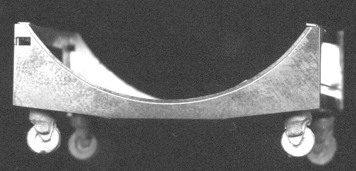

Hunter Gun Pack Cradle
Very little needs to said regarding the construction of this part other than it uses the two parts un-numbered on the sprue from the Trolley section. Also don't glue part one to it, as this is the base of the gun pack itself.

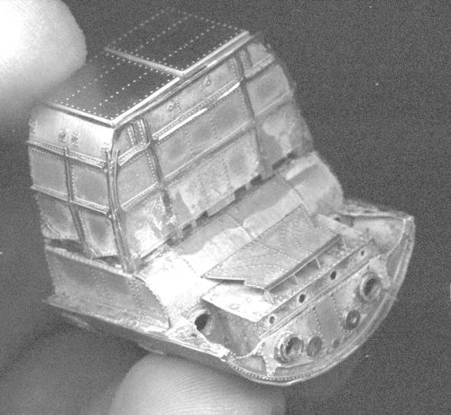

Hunter Gun Pack
The most daunting piece of construction is now upon you. With many complex folds required, careful planning is necessary before you bend your first bit. I started on the Ammo box covers, these two small parts require very fine bending, and I used a pair of very small pliers bending progressively down the edge and back a small amount at each time. Once bent to 35 or so degrees the bent bit can be placed on a hard flat surface and bent to 90 degrees, giving a nice hard edge. Now flatten out any wrinkles with pliers held side on. Construction can be continued leaving all the fine detailed bits off until after the main construction has been completed. The fine detail parts are so fine that they may easily be damaged if fixed before the heavy duty bending is completed. (the lifting rings are so small that they were positioned dry with a pin through the hole and glue added from behind. I added them just prior to fixing the ammo box to the gun housing.) Build into two main parts, the Ammo Box and the Gun housing. When assembled the design leaves a largish gap where you would expect to see the ammunition folded neatly. To fill this space up I constructed a simple rectangular box from plastic card to fit inside and behind the gaps. This will be painted a darker shade once the airbrushing is completed. I also found that part 22 seemed to detract from the overall appearance so was left off. Now for the gun housing, great care must be exercised when folding the main part as the diagrams are simplified and do not entirely clearly represent the finished configuration. Also the bits are very fine and fragile until attached to the outer panel. Piece number 1 should be curved to the radius of the hunter fuselage and unfortunately the manufacturer has etched grooves on the inner surface to make fixing to the inner workings better. I wish they hadn't because as soon as you start to bend the curves these weak points bend into v shapes, aaaaaaarrrrrrggggghhhhhh! Your best bet is to clamp one end to a Tamiya paint jar or similar sized round tube and then bend around it. This will result in a curve very slightly to large. But this makes fine tuning the curve a hand held job, being careful of those grooves. Now after carefully fixing the curved panel to the gun housing and this to the ammo box you can start adding the really fine detailed bits. To create the tube like fixings that represent the attachment collars to the gun barrels and spent case chute first remove all the rings and group them as only one of each size is numbered. Place them over a needle file in order will line them up then remove tightly held between finger and thumb and add a drop of glue, voila they can be added after allowing to dry. This item was bare aluminum as the wheel wells but should be dirtied down a bit as fumes from the guns could stain the unit.
