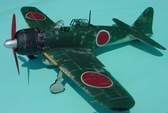

I used the three Eduard detail sets for the interior, exterior and engine. Also used their new photo etch set for the seat belts and canopy mask.
I masked off the canopies and temporally glued them in place. The model
was then sprayed with Alclad II Aluminum paint then painted with Model
Masters Japanese green and grey. Decaling was done according to instructions.
I replaced the Tamiya red dot decals for some CAM decals because the thickness
on the Tamiya was way to fat. The CAM decals where much thinner.
After waiting a few days I then broke out my Pasche Miniature sand blaster and
attacked the model to give it the weathered look. A coat of Scale Coat
II flat sealed everything. I then washed the panel lines with black wash
and airbrushed streaks and stains with Floquil Grimy black.
A nice model, a little expensive, but well worth the final results.
