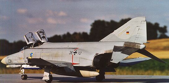

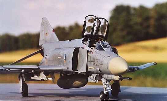

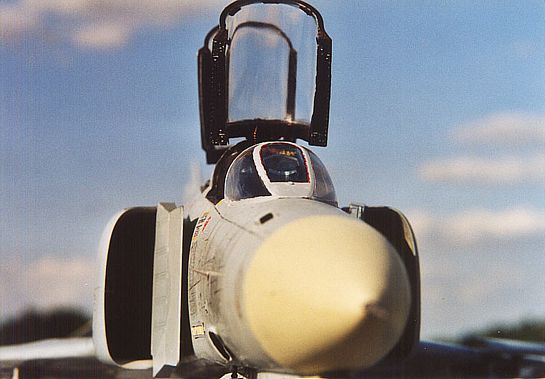

Introduction
In the first article about the F-4F we took a look in the history of the F-4F and the very interesting camouflage scheme called NORM 81, that make this Phantom variant a most attractive one.
In the '90s the German Bundesluftwaffe began a program to improve their F-4F and extend its service life beyond 2000. The reason why, was the delay of the Eurofighter program.
The new F-4Fs KWS (Kampfwertsteigerung ) or ICE (Improved Combat Efficiency) is one of the best of all Phantom update programs (the more advanced Peace Icarus 2000 program for the Hellenic Phantoms is principally an improved version of the ICE program).
All of the ICE Phantoms carry a new camouflage scheme called NORM 90J. It is a combination of three gray tones (RAL 7030 for the radome, FS 35237, 36320, 36375 for the fuselage and wings). You can easily recognize an ICE Phantom from its tan nose.

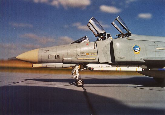

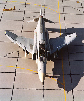

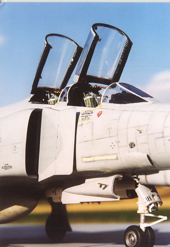

Image 02 Image 03

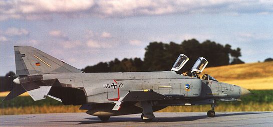

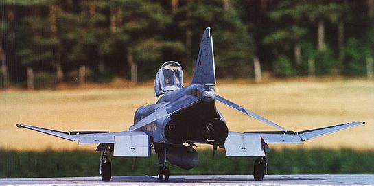

Once again I used the Revell F-4F kit, because I think it's simply the best alternative for building an accurate F-4F ICE in the 1:32 scale. I'll not write again about the goodies and the problems of that kit, just take a look at my previous articles to take the information you need.
But here are the major changes I made for that particular kit:

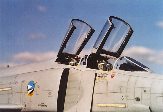

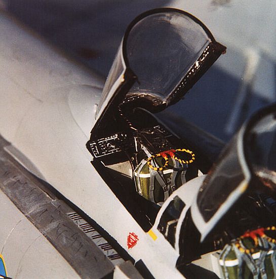

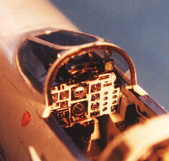

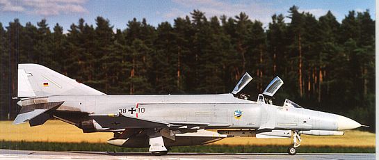

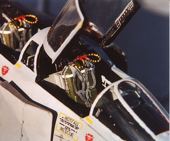

1. I used the Eduard set for the cockpits and for the formation stripes around the fuselage

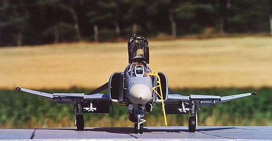

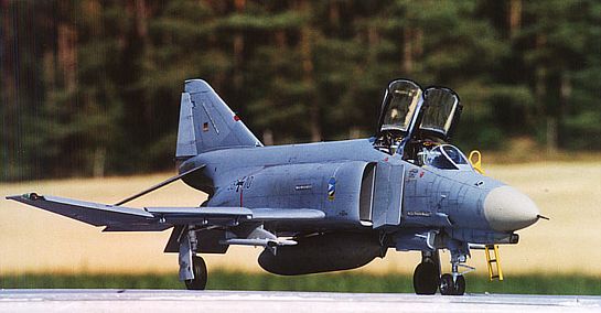

Image 04 Image 05

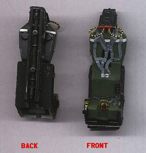

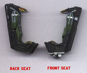

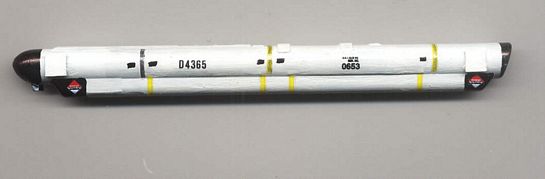

2. I used the kit seats, because they are accurate (German version of the MB-H7) and I only put the harnesses (Eduard set) on them

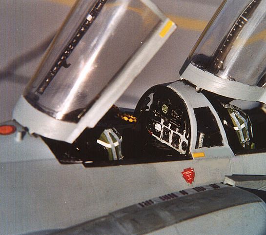

3. I made some changes for the WSO instrument panel (cut the upper panel extension and glue it separate under the upper edge of the middle canopy)

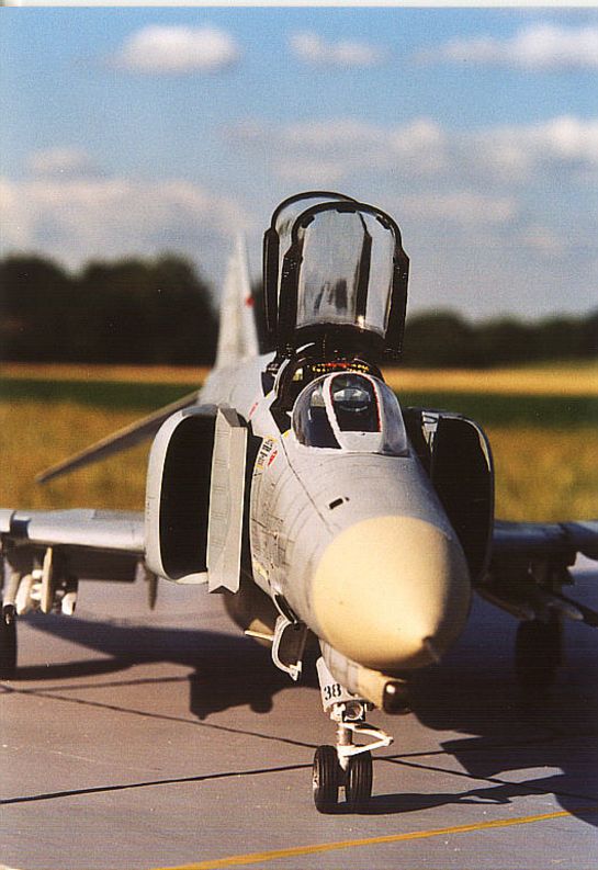

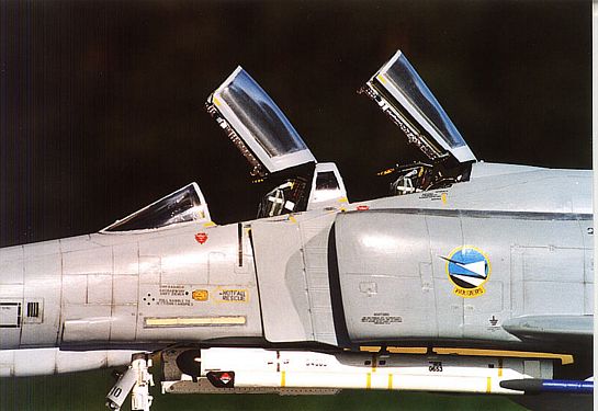

Image 06
4. I changed the depth of the cockpit tub, cause it's too deep

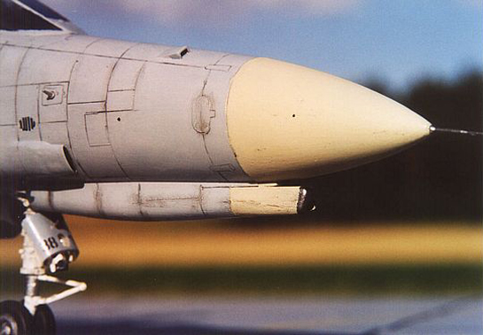

5. I reshaped the contours of the radome to make it looking better
Image 07

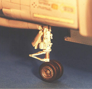

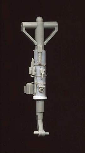

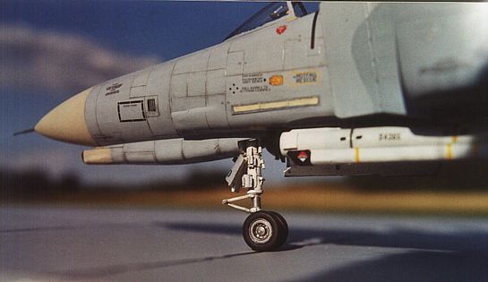

6. I build the whole nose gear leg from scratch
Image 08 Image 09
7. I used Tamiyas oleo for that leg
8. I used the Tamiya rubber tires for both front and main landing gear and only the Tamiya main wheels, the front gear wheels are from the kit (I removed the styrene part of the tire)

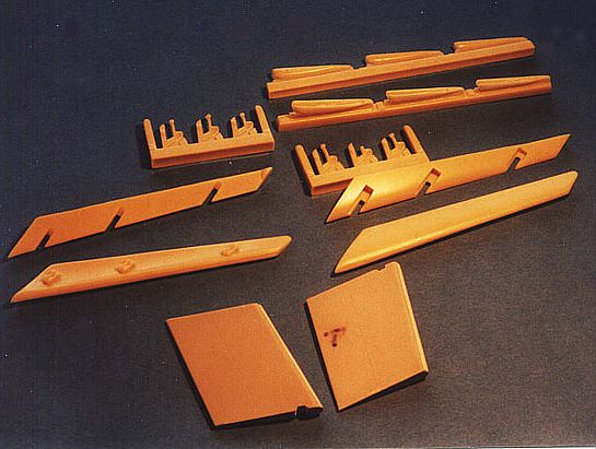

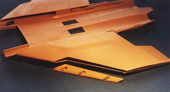

9. I cut off the kit slats and used the Paragon set to show them in the open position.
Image 10 Image 11 Image 12
10. I cut off the flaps and glue them "down"
11. I put some details inside the canopy rails.
Image 13 Image 14
12. I put some details behind the seats for the front and the back cockpit
Image 15
13. I make the nozzles much deeper
Image 16

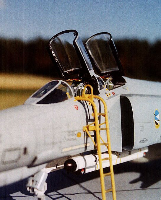

14. I used the Tamiya boarding ladder
Image 17

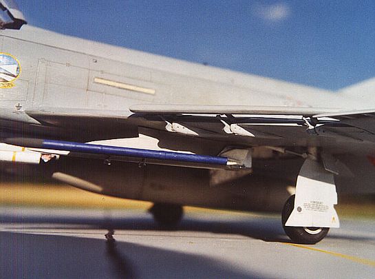

15. I used a telemetry pod from Revell's F-16N
Image 18

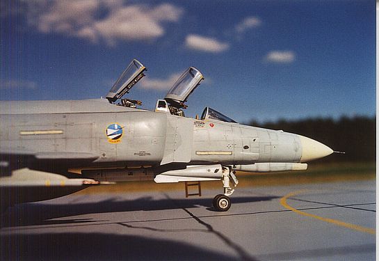

Last but not least the painting scheme. It was a fun to paint the ICE in the new NORM 90 scheme. It gives the Phantom a really striking look and a high grade of low visibility capability.
Image 19 Image 20
I used enamels from Humbrol for the painting job. I had to make all gray colors much lighter by mixing some white with. Take a look at an ICE Phantom and you could hardly see a difference between the tones of the medium and the light gray.
There's one more point that you have to look after, if you want to build the ICE. The gun muzzle is painted also with RAL-7030. Only a small front part of the gun nose is left unpainted (steel).

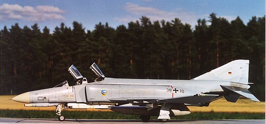

The unit I chose for this F is the JG74 "Moelders" one of the units to receive soon the Eurofighter. I chose to build the 38+10, because I have some good pics of that aircraft. The decals I used, are all from the Revell kit.
Image 25 Image 26 Image 27
