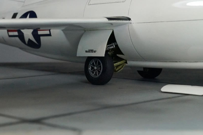

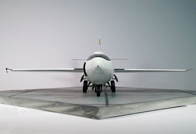

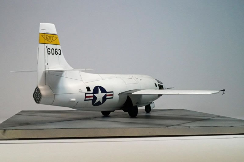

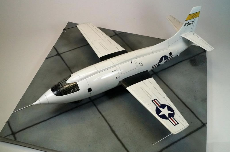

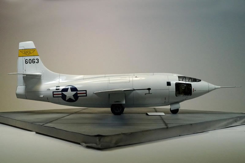

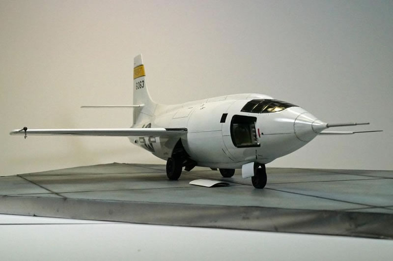

Here are photos of the completed X-1 operated by NACA during 1949.

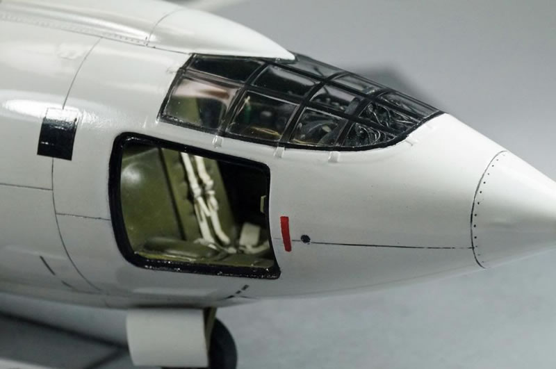

Modifications/additions:
- RB productions seatbelts
- Airscale photo etch bezels
- Airscale decal instruments

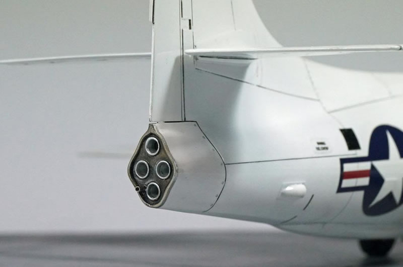

Scratchbuilt:
- 3 x pitot tubes
- 2 x scoops aft fuselage
- Re-scribed
- Rocket nozzles
Decals:
- Kit insignia etc
- MH Models stencils
I used Mr Surfacer white 1000 spray to paint the aircraft, followed by Tamiya clear for the gloss coat. Polished to a high sheen using Tamiya compounds and wax.
