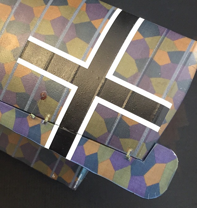

All of the sheets are printed on a clear decal paper without a white base, and this gives the modeler a few options to achieve the desired effect: Preshade your wing and then paint a base coat of gloss white before applying your decals, or paint a base of gloss white on your wing and then apply your decals, followed by sealing and then post-shading the wing.
Varying base coat colour also allows you to simulate lozenge that had been toned down by ground crews with a brown glaze by using a light tan. This is the approach I used on my Fokker completed last year; Tamiya Buff was used as the base coat on the wing, and white was used as the base on the aileron

Enter Aviattic, who came onto the scene within the last two years with carefully researched and beautifully-designed lozenge decal sheets. These sheets have a fabric effect printed in them and what many will argue are the most accurate colours for the dyes used to print lozenge onto the fabric used to cover so many wings and fuselages of German aircraft. The original decal offerings from Aviattic focused on a series of custom-shaped decal sets for the Wingnut Wings Fokker D.VII series of kits. In late 2014, Aviattic followed up these products with sixteen separate custom decal sheets for the Wingnut Roland D.VIa and D.VIb kits. Like the D.VII decal options, there are sets available for both 4-colour and 5-colour lozenge, available in "factory fresh" and "faded" effects, with linen or lozenge print for the rib tapes.
Why clear-backed decals? The answer is simple - this allows the modeler to pre-shade the surface and spray gloss white over this. Once the decals are laid over this surface, there is an instant effect of depth similar to the appearance of 1:1 scale fabric applications. If the modeler chooses, the base colour can be varied between white and another very light gloss colour to simulate
