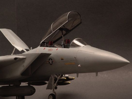

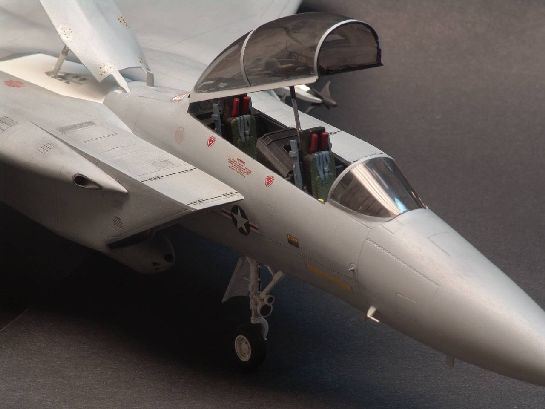

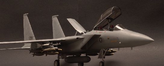

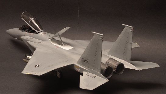

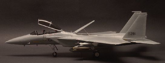

I bought this kit over 15 years ago shortly after coming to work for McDonnell Douglas. At that time the E model was just starting to roll off the assembly line here at the St. Louis plant. I had every intention of finishing this plane and proudly displaying it on my desk at work but time, family and other obligations caused me to put it aside. Only recently have I gotten back into scale modeling and after its having survived all the years and several moves I thought now is the time to finish the Eagle up.
I came to realize during the build that Revell’s Strike Eagle is not a true F-15E. I had never realized until recently the history of ‘291’. Originally I had wanted to finish the plane up in the Lizard or European 1, three toned green, color scheme. However, since this bird was a demonstrator it had gone through several different schemes and configurations. I opted to build the kit with the two-tone ghost grey scheme like other F-15 models.

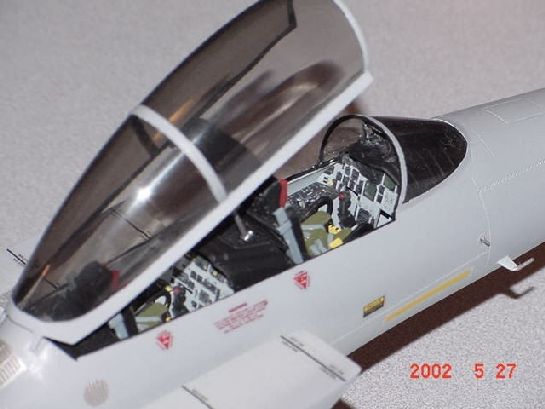

The kit was built stock out-of-the-box. I decided to leave the CFT’s off since the documentation I had showed the ghost grey scheme without them. (I’ll wait until I build my 1/48 Pro-Modeller F-15E to have one with CFT’s) There was quite a bit of putty needed on the joint between the forward and center fuselage joint. The hump of the ECS exhaust duct, aft of the canopy, also need some re-shaping to make it fair into the canopy mold line better. The bombs took the most time to sand and prep. I had made all sixteen initially and that’s a lot of seam lines to fill and sand. The model is painted with Humbrol light ghost grey and dark ghost grey. I free handed the camo pattern with my airbrush. The engine section was painted with Testor’s MM buffing titanium. I know it looks a bit dark but from photos I’ve seen of older A models in service the titanium seems to darken with age. The model was then sprayed with Future and decaled. The kit decals held up well after all those years. After the decals had time to dry a final spray of Testor’s dullcote was applied. I then removed the masks from the cockpit area, finished installing the seats and completed some last minute detail painting.
This was my first model completed after a 15-year hiatus from the hobby.
