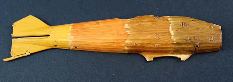

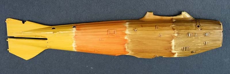

I am going to use 4 different oil colours out of the tube to show the different tones that you can achieve using the different base colours. I will be using Raw Sienna, Burnt Sienna, Raw Umber and Burnt Umber.
The oil colours are applied in the following order - Raw Sienna, Burnt Sienna, Raw Umber and Burnt Umber.

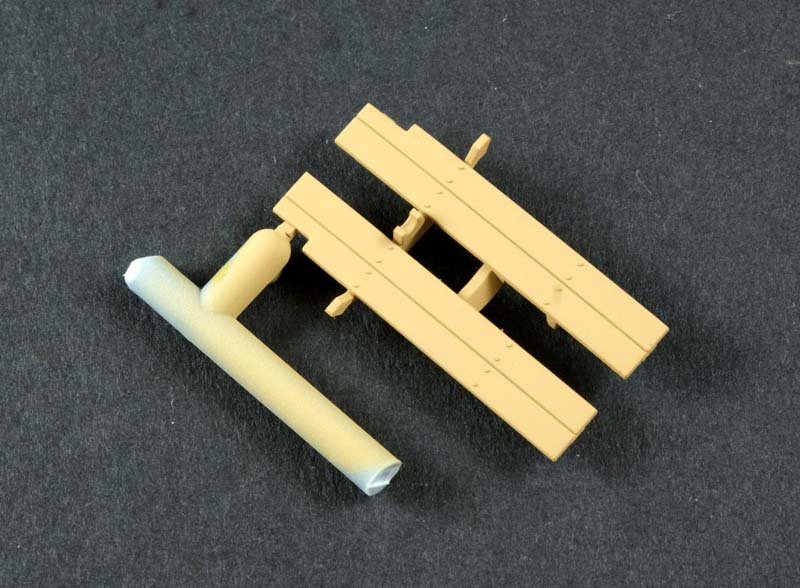

XF-57 Buff base:
XF-59 Desert Yellow base:
XF-51 Flat Flesh base:
XF-3 Flat Yellow base:

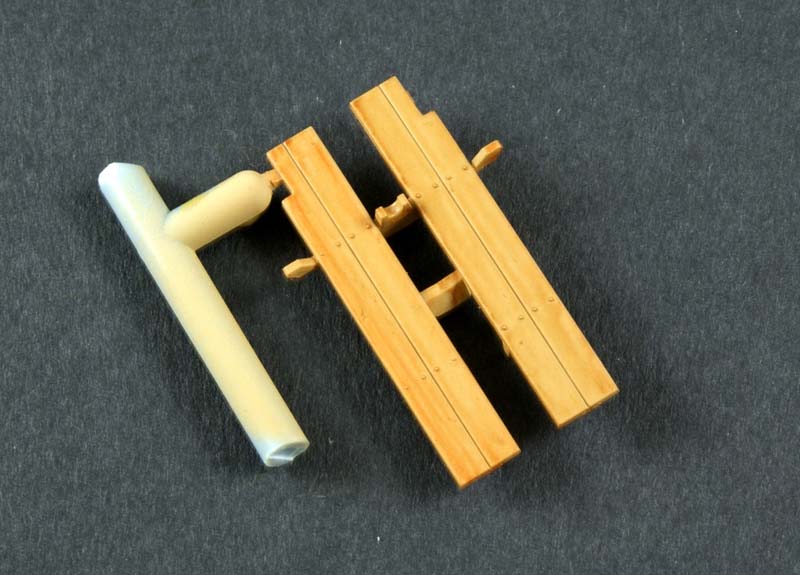

My technique for wood graining is pretty simple and very easy to do. Its very similar to a technique that armour modelers use for weathering.

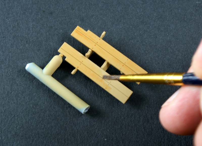

I start off spraying the base colour to the part/s, this case I have used Tamiya's XF-59 Desert Yellow.

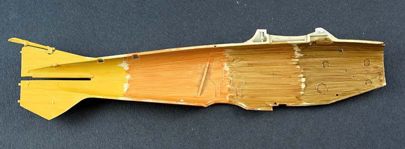

Next I thin down the oil colour with some turpentine to a very watery thinned mixture:

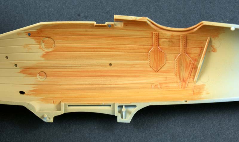

I apply the watery mixture the to the part to tint the base colour.

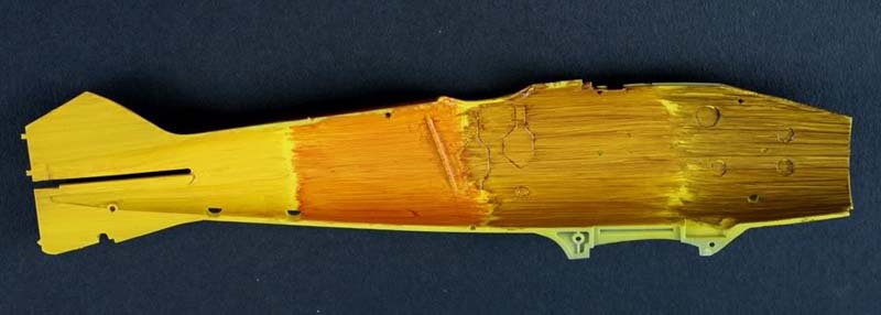

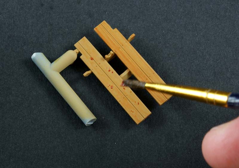

Then I apply dots of the oil paint onto random areas of the part and brush them back and forth to get the grain look onto the part. You can add different colour dots of oil paint to achieve dark grains.

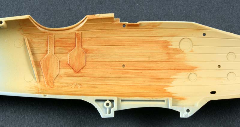

It should look something like this one you have finished:
Since the oil colours have been thinned drying time is a lot quicker. Normally I find that it is tacky dry in 15-30 minutes and 24-48 hours dry to handle. You can also cheat and use a hairdryer to speed up the drying time. I normally do this method and will spray a clear varnish over the parts to seal them in around 4 hours after using the hairdryer.
