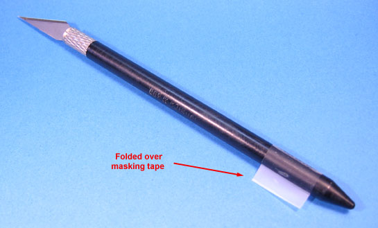

2.) Avoid the old problem of hobby knifes rolling over the table to your lap or foot. There are many ways to do this. Some modern hobby knifes comes with a triangular shaped handle to avoid rolling. You can also plug some sort of anti-roll device to them. The simplest method is to add an ´ear´ to your hobby knife handle out of a stiff masking tape or electrical tape. Here´s how:
A simple anti-roll device for your favorite knife.

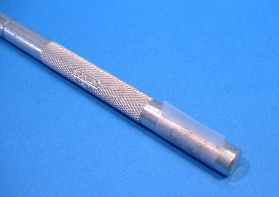

Another view, another knife.
