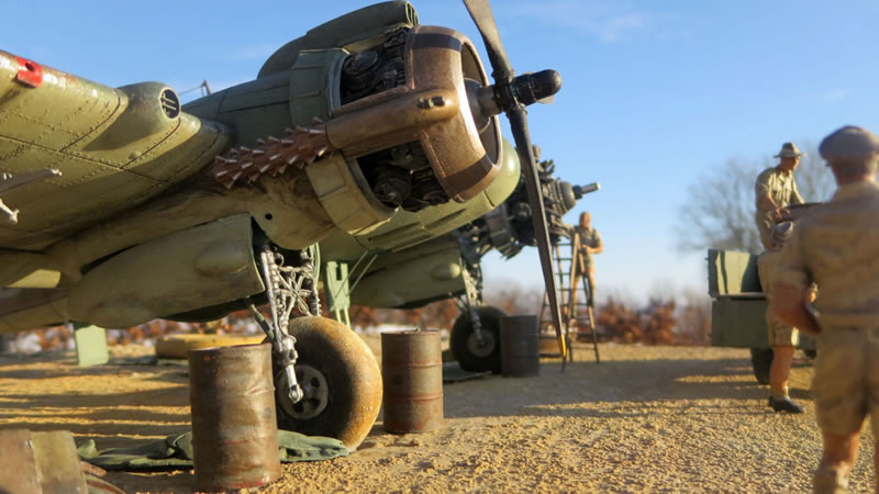

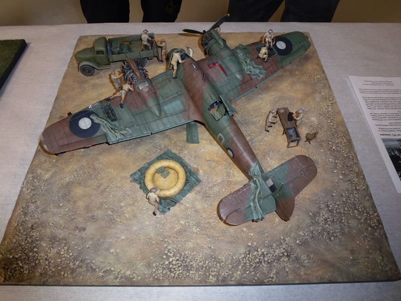

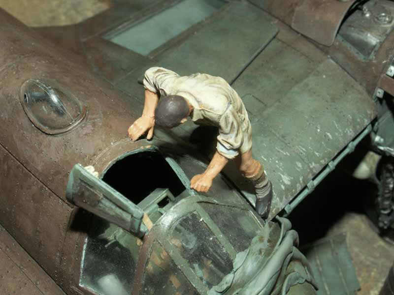

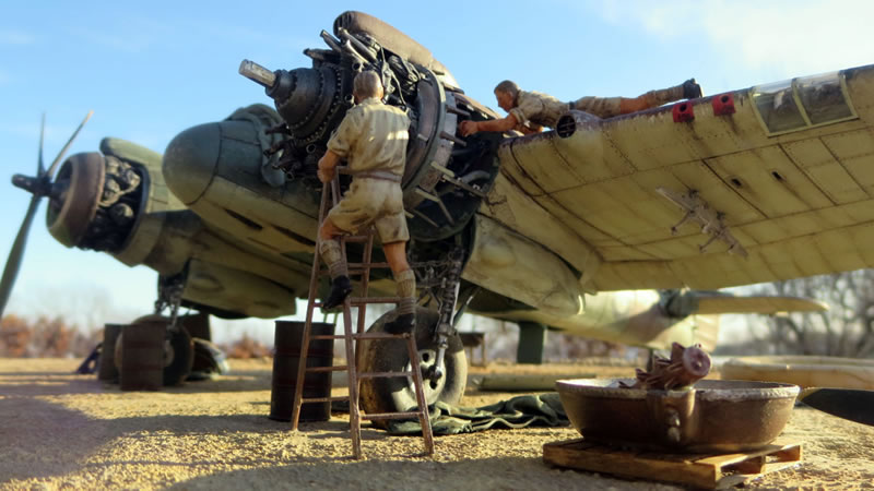

Diorama: 1/32 Revell Beaufighter + Ford 2000 Converted. Airfix Multipose Figures converted with Ultracast Heads...

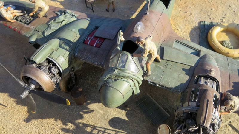

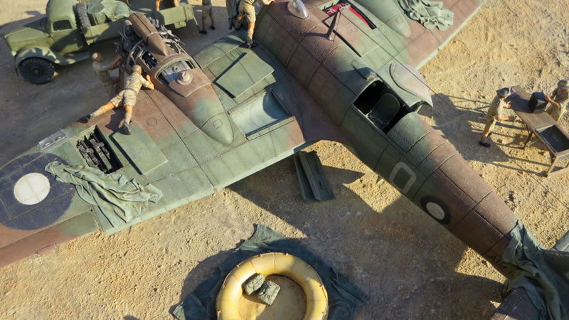

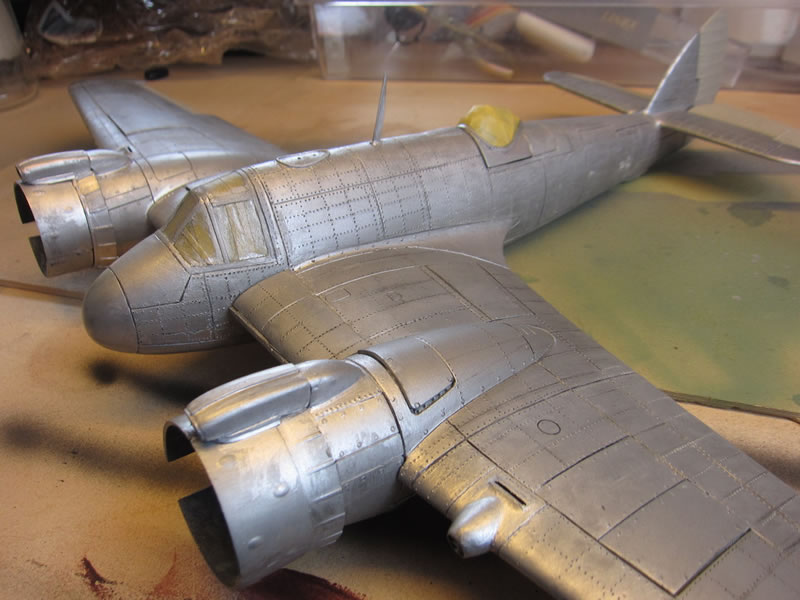

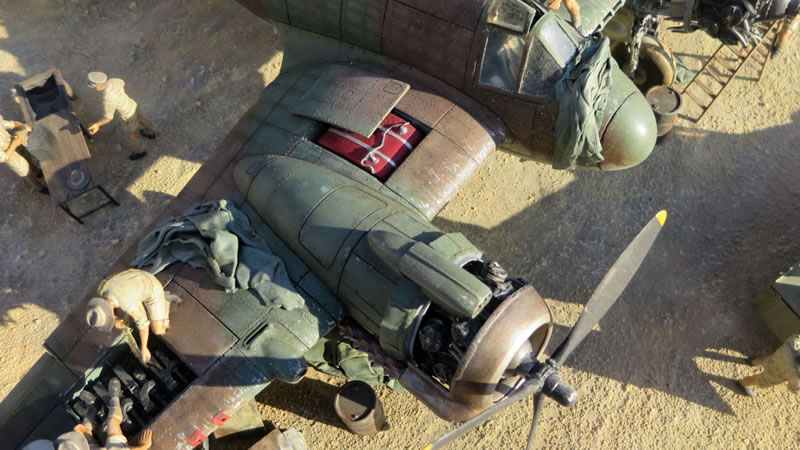

The kit was taken apart and sanded down, cutting open gunbays, fuel tank and rubber dinghy compartments. New panel lines were rescribed, using Tamiya scribing tool. Rivetting was done by hand, one by one, as I didn't have any rivetting tools back then.

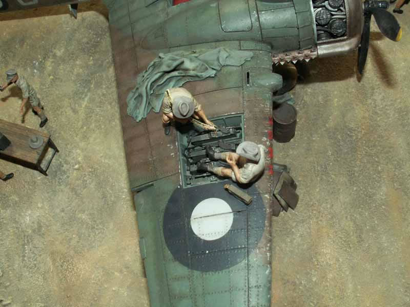

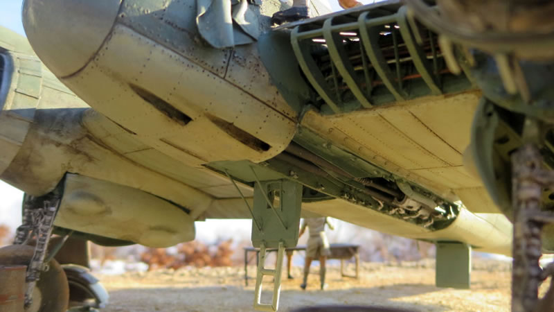

The wheel bays were rebuild from scratch, as the old kit ones are completely wrong. Wheel bay doors were detailed. I also wanted to display the Hispano 20 mm cannons, so this compartment was also build and detailed.

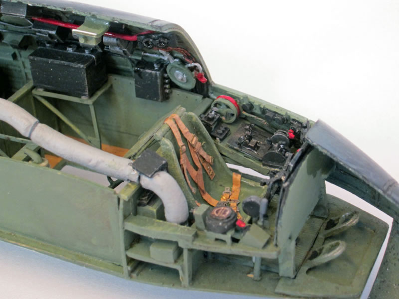

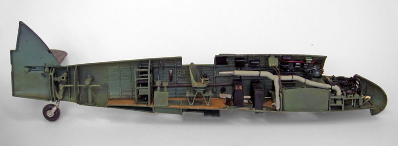

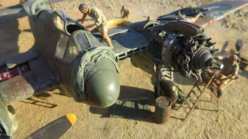

There's almost nothing usable in the kit interior, all of it had to be build from scratch, instrument panel, radio equipment in the navigators station in the back. The large 20 mm Hispano cannon ammunition magazines and a lot of other details were build. Including lead wiring.
Only Aftermarket parts used were RB Productions 1/32 Sutton Harness, Quickboost 'Porcupine' exhausts, Ultracast .303 wing-mouted Browning .30 cal guns. The gun bays were detailed with ammo boxes etc.

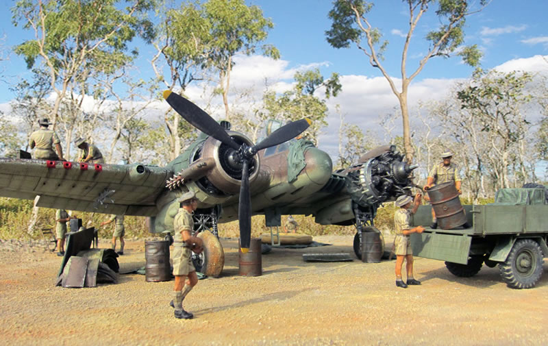

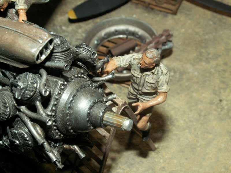

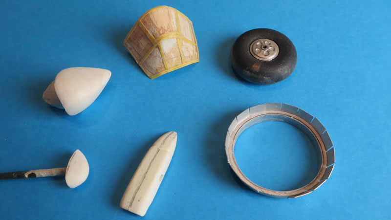

I could have used the very nice Vectors Hercules engines, but they were a little too expensive to me. So I went on detailing the kit ones, with Lead wires, building the very special manifold and cooling ring of the Hercules engines. Oil tanks were added and also the cowling ring 'flaps' were replaced. Wing mounted RAF Universal Bomb Carriers were build from scratch.

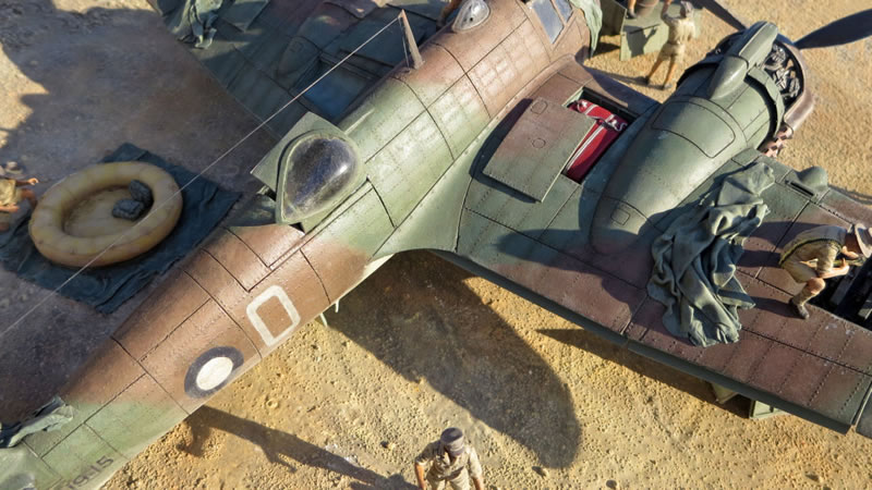

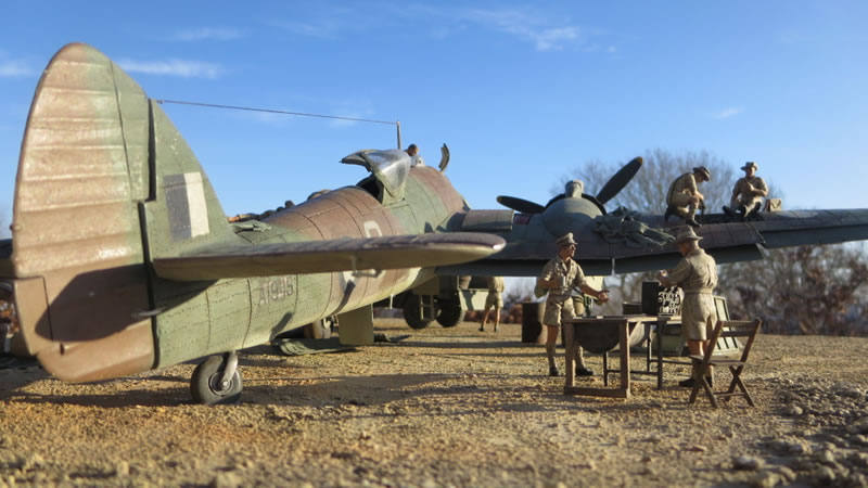

My airbrushing skills are non existent, but i did try some 'salt' weathering. What a mess! But I'm quite happy with the result. Markings and lettering were painted, using masks and printed serial numbers. Further weathering was done with my own mix of dark oil washes.

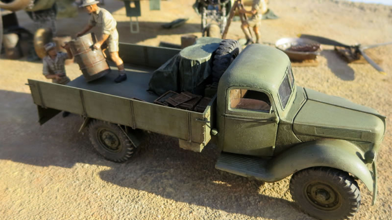

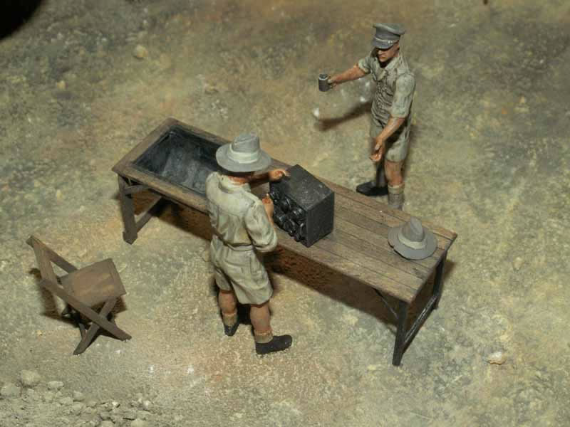

For the diorama, the Ford 2000 of Revell was converted into a Australian build Ford, cab converted and larger truck wheels. The rubber dinghy was made from Magic Sculp, as were all of the tarps. Wooden workbench with the half oil drum a wooden chair, ladder and pallets.
This started out as a project, with no expectations, as to the result. The object was to get to know a lot of new modelling techniques, getting into the modelling work again, and it ended up, being a tour de force of 'trial and error'.
