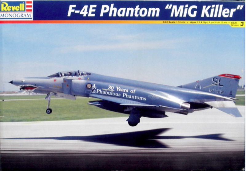

Revell-Monogram 1/32 F-4E Phantom II USAF
By Ben Brown & Thierry Laurent
![](/articles/images/2735/2735-1.jpg)
- TYPE: F-4E Phantom
- SCALE: 1/32
- COMPANY: Revell-Monogram
- KIT NUMBER: 4668
MOLD CREATION DATE:
- 1994 (Revell Germany) RF-4E sprues
- 1995 (Revell Germany) F-4F sprues
- 1998 F-4E sprue
NOTE: This kit shares no part with the non-slatted wing F-4E kit released by Revell USA in the sixties.
