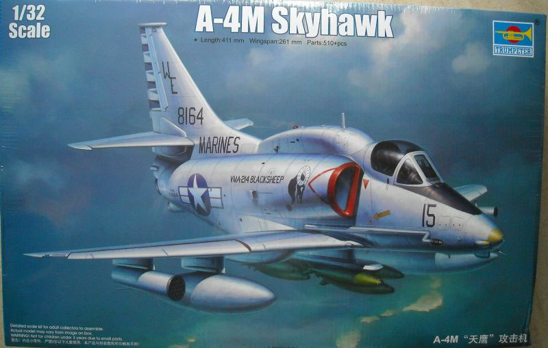

- TYPE: Douglas A-4M
- SCALE: 1/32
- COMPANY: Trumpeter
- KIT NUMBER: 02268
- MOLD CREATION DATE: 2012
