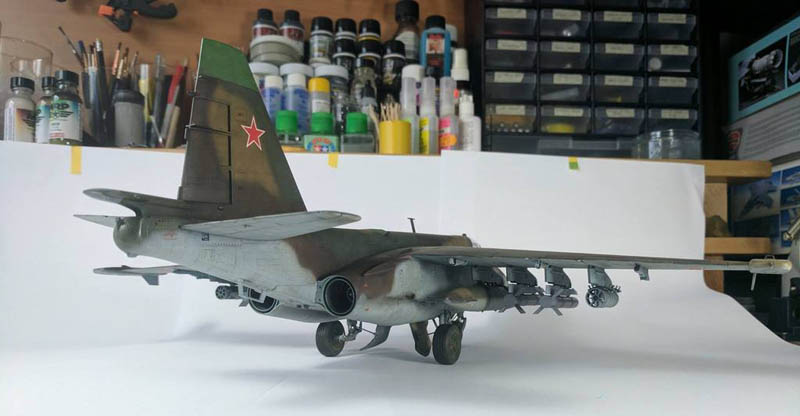

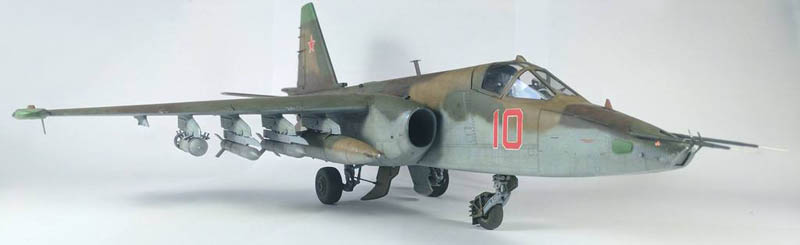

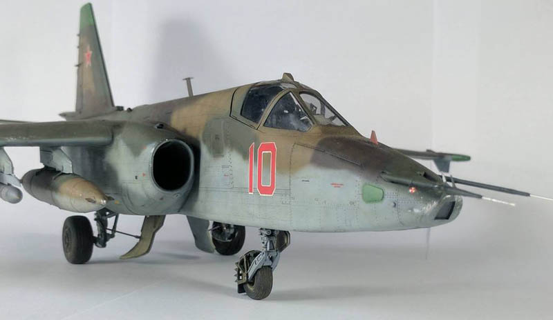

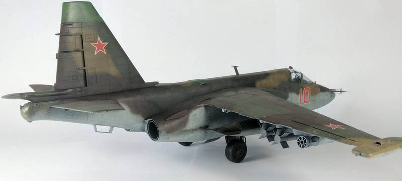

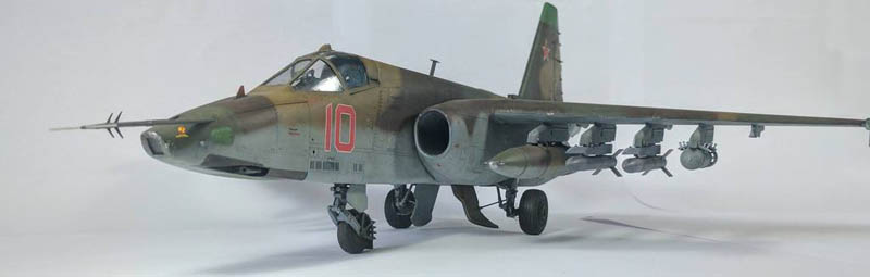

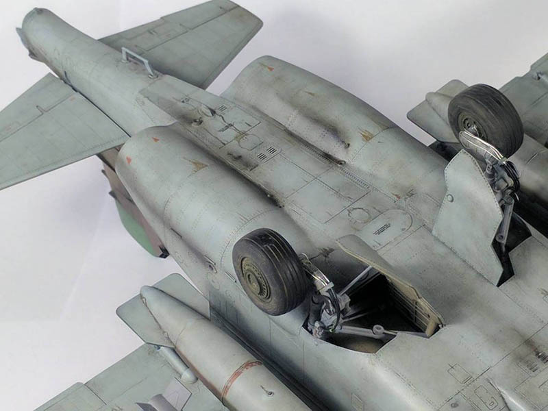

My first completed model for LSP, as well as my first 32nd scale completion! I’ve used the Trumpeter kit along with a kitchen sink type attitude to aftermarket, if I could buy it, I bought it!
First off, I hate the fact the canopy doesn’t fit right, I ended up leaving it loose so I could display the cockpit off as well as keeping the normal lines of the plane.
Without diving into accuracy comments as I’m not qualified to evaluate, the kit was very good. Fit for the major parts if built as instructed was excellent with the overall need for filling quite low, however with the amount of modification I put into it the project ended up stretching over 9 months with plenty of mistakes to slow me down. One strong negative was the kits stencil decals, there were too bright and a bit clumsy. I decided to omit the majority of these to match what references I had.
One of the hardest tasks was finding colour photos of the plane in Afghanistan which is where I wanted to model the aircraft as being. With a few references to go on, I ended up basing my weathering on ‘in service’ photos of any air force I could find.
Some of the alterations to the kit I did make were:

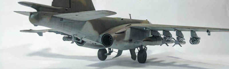

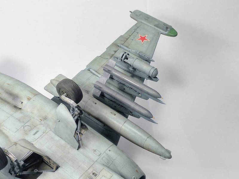

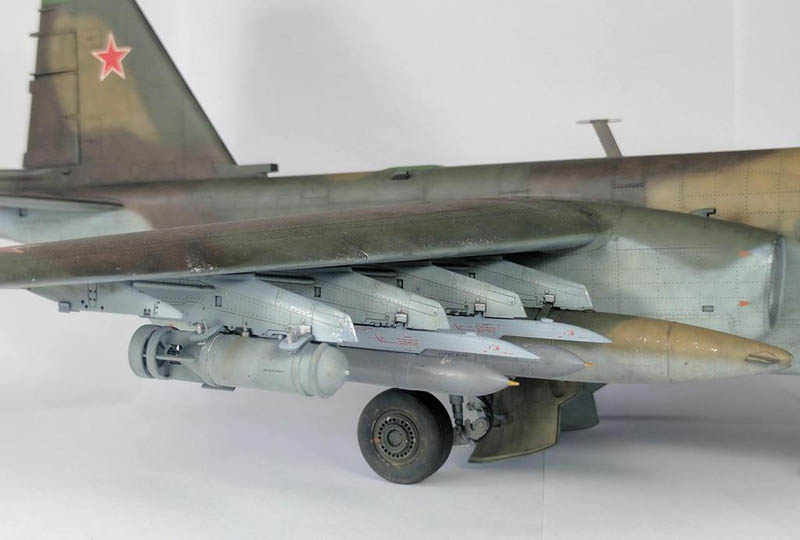

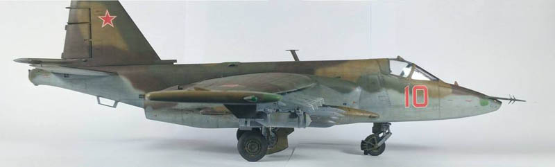

The fuel tanks given in the kit are the large type, PTB-1150 I believe. Most of my references showed the plane with the small PTB-800 which were made by cutting the extension pieces out of the base kit parts.

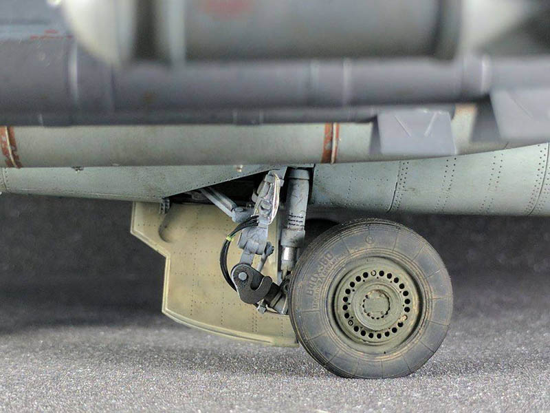

Brake lines were added to the main gear legs with Kynar wire. Brackets had to be made from stock plastic to hold these but they needed adding as on the actual aircraft these are very prominent.

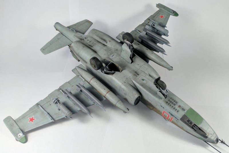

The kit provides the model with the flaps and slats all deployed, quite a bit of time is needed to pose these close. I made the decision late in the build which made things harder. Same again for the air brakes, it took a considerable amount of work to model these closed without nasty gaps.
Trumpeter also provides all the underside gear doors posed in the fully opened maintenance position. In normal parked condition, only one door should be open for each bay. This proved awkward to model due to lack of mounting points.
On the underside no drain holes are provided around the engines. Brass pipe was used to simulate these using information provided by a Su-25 mechanic (Thanks Jozef!).

Modifications & Alterations
- The fuel tanks given in the kit are the large type, PTB-1150 I believe. Most of my references showed the plane with the small PTB-800 which were made by cutting the extension pieces out of the base kit parts.
- Brake lines were added to the main gear legs with Kynar wire. Brackets had to be made from stock plastic to hold these.
- The kit provides the model with the flaps and slats all deployed, quite a bit of time is needed to pose these close. I made the decision late in the build which made things harder. Same again for the air brakes, it took a considerable amount of work to model these closed without nasty gaps.
- Kit also provides all the underside gear doors posed in the fully opened maintenance position. In normal parked condition, only one door should be open for each bay. This proved awkward to model due to lack of mounting points.
- On the underside no drain holes are provided around the engines. Brass pipe was used to simulate these using information provided by a Su-25 mechanic (Thanks Jozef!).

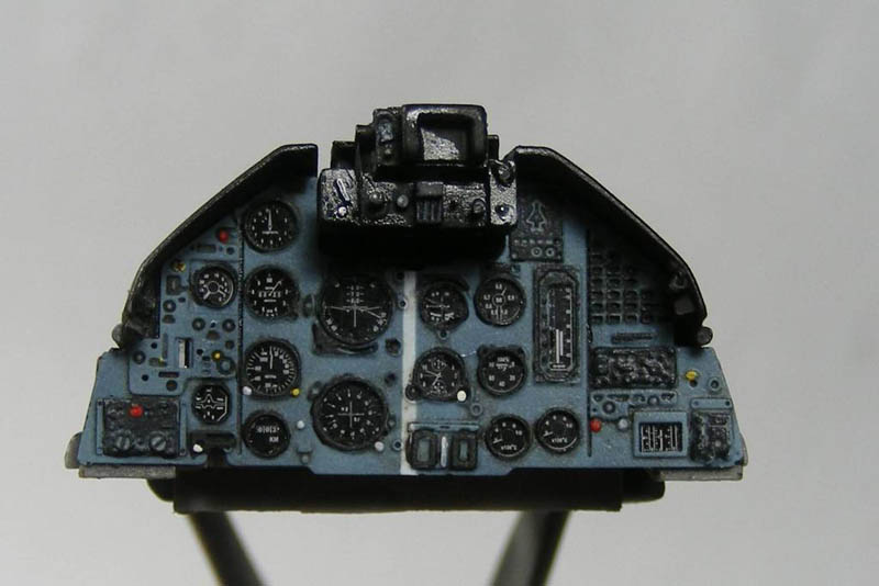

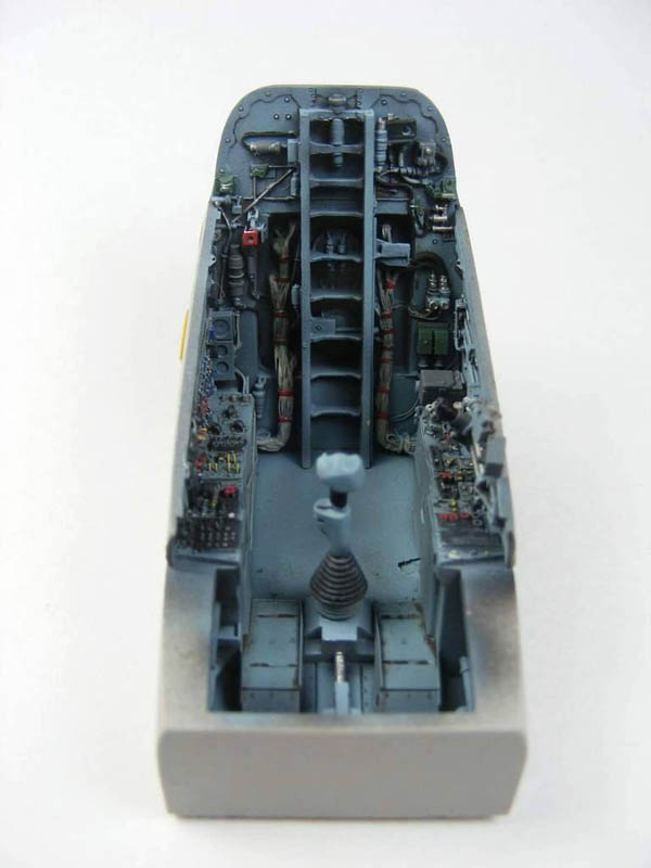

Aftermarket Reviewed

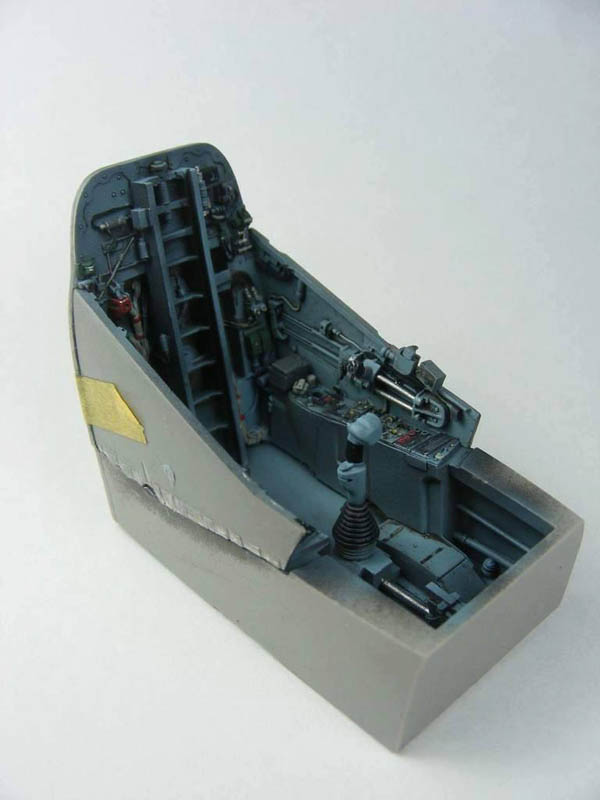

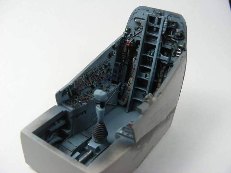

Aires Cockpit
Fantastic part from Aires. Only had to remove a small amount of the casting block from the bottom and it drop fit straight in. Some of the mounting step had to be removed but the resin blocks the hole afterwards if required.

Quickboost Pylons
Trumpeter don’t provide the Air-to-Air pylons! Vital to complete the build, very easy to use as they’re drop fit into the kit location holes.

Armory Wheels
I had a real battle with these. They aren’t pre-drilled for the kit parts which is an odd size (2.3mm from memory). I couldn’t use the front wheel in the end as with the undercarriage being white metal, the wheel was too big, which stopped me from using it.
