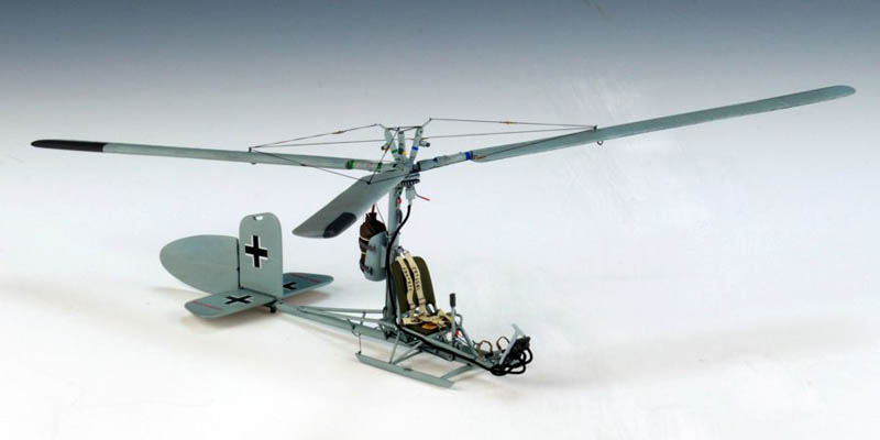

The Fa 330 Bachsteize (Wagtail) always interested me as a unique aircraft with an equally unique mission. This was towed aloft to about 400ft (120m) by the U-Boat so the pilot could see beyond the horizon view (25 nautical miles) and report any enemy activity. Stored in three watertight compartments by the conning tower a team of three can assemble and disassemble the Fa 330 in about 20 minutes.

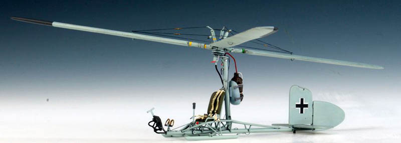

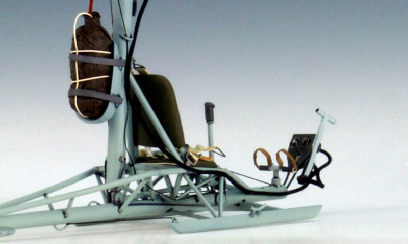

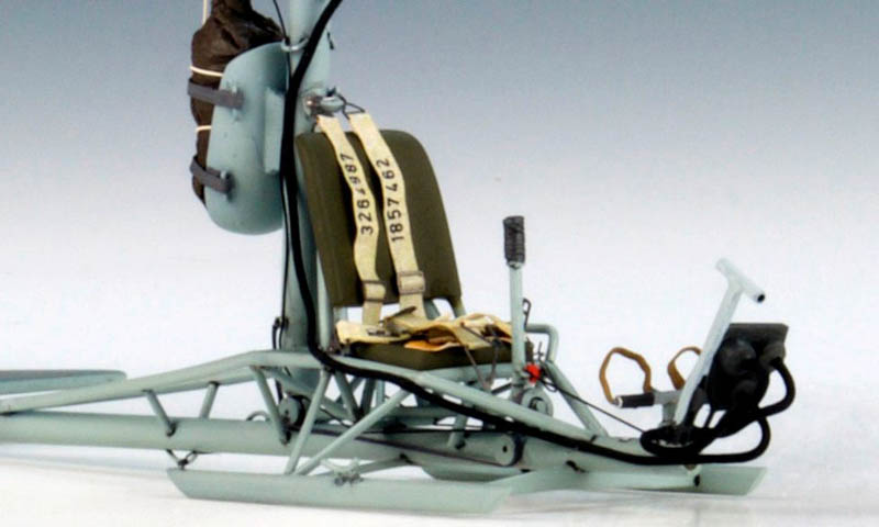

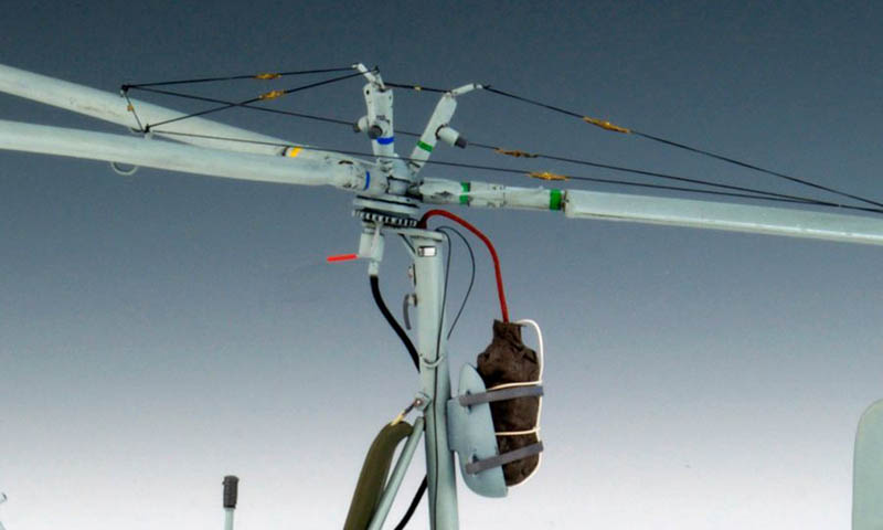

Not a easy build as there was plenty of angst and head scratching moments. This build also gave me an opportunity to practice rigging as a Wingnut Wings kit will be landing on my bench soon. The build thread can be found in the forums.
Build Details

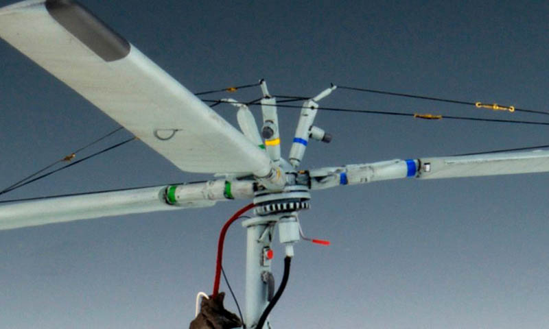

- Replaced over a dozen tubes with styrene rod
- .5mm
- .4mm
- .3mm
- Scratch
- All Grab Handles on frame and underside rotors
- Cleats on skids

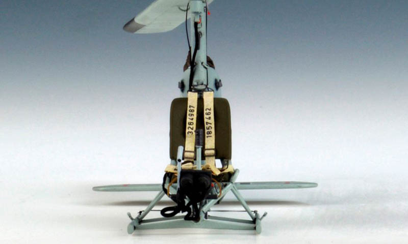

- Parachute Pack and all straps
- Turnbuckles on Outriggers on top of rotor hub
- Pitot Tube and mount
- Instrument Panel mounts
- Foot Pedal and Straps
- Rigging & Cables
- INFINI Medium 110 (.121mm) Black Lycra thread
- EZ Line Medium
- ANYZ Black .5mm Braided thread
- Brown .4mm Braided thread
- RB Productions P32023 Turnbuckles
- GasPatch Rigging eyelets
- Albion Aluminum Slide Fit Tubes
- .3mm
- .5mm
- .7mm
- Gunze
- RLM 66
- RLM 76
- RLM 81
- Vallejo
- 306 Dark Rubber
- Tamiya
- XF-86 Flat Clear
- MiG Washes
- Dark Wash
- Decals
- MDC Luftwaffe Instrument Dial
- HGW
- Luftwaffe Textile Belts
