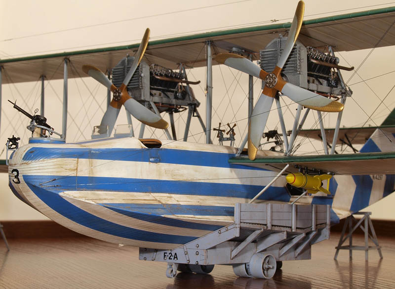

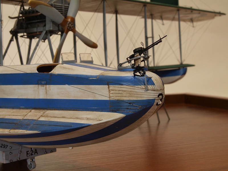

The flying boat Felixstowe F.2A serial N4297 was built in the early configuration at Saunders and delivered to Felixstowe in May 1918. During Summer 1918 it was rmodified to the late open-cockpit configuration and had its hull painted in striking blue-white strips. In November 1918 it was after subsequent repairs indicating new linen covering on the upper wing, incomplete roundel and repainted ailerons and right upper wing tip segment. It is reported it was still in service in 1919.

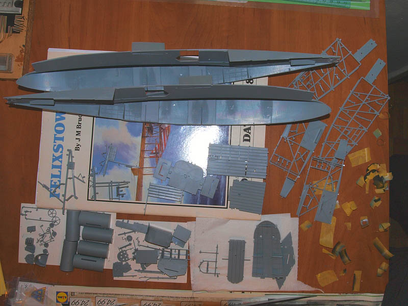

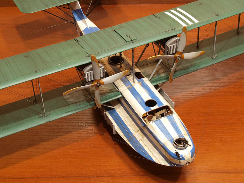

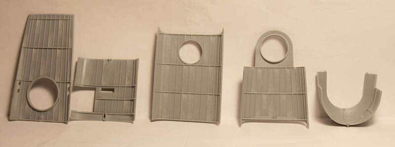

Produced at the end of 2014 by Wingnut Wings is definitely their largest kit and arguable the most sophisticated and most demanding one. Yet, the exquisite engineering makes its construction relatively easy, provided the sequence of assembly proposed by the manufacturer is strictly followed.
The kit contains almost 400 elements of utmost quality, with perfect fit. The engineering, breaking into elements and clever assembly sequence facilitate very much the assembly – the final model is enormous with almost 92 cm span.

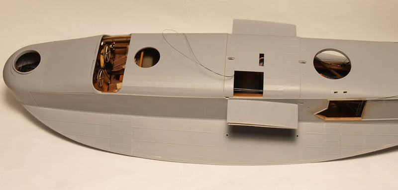

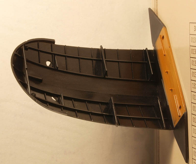

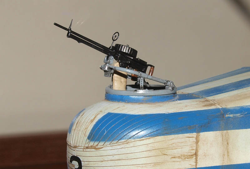

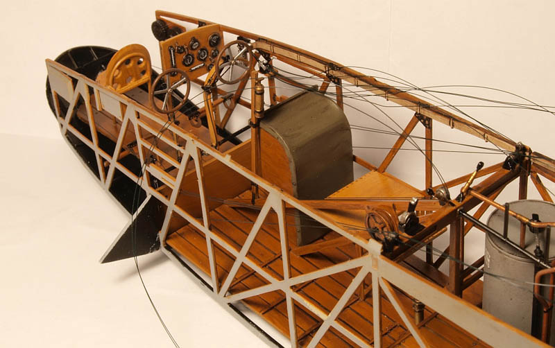

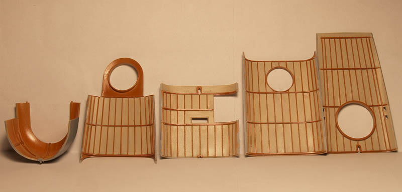

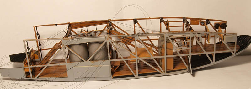

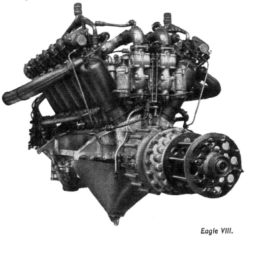

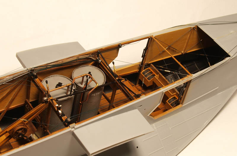

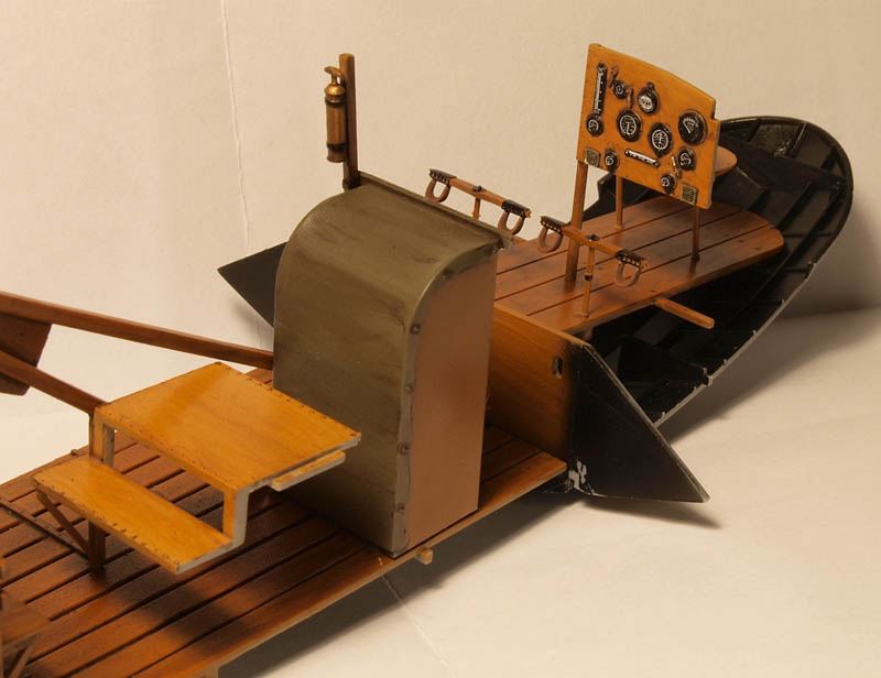

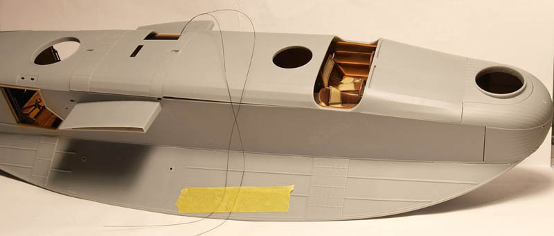

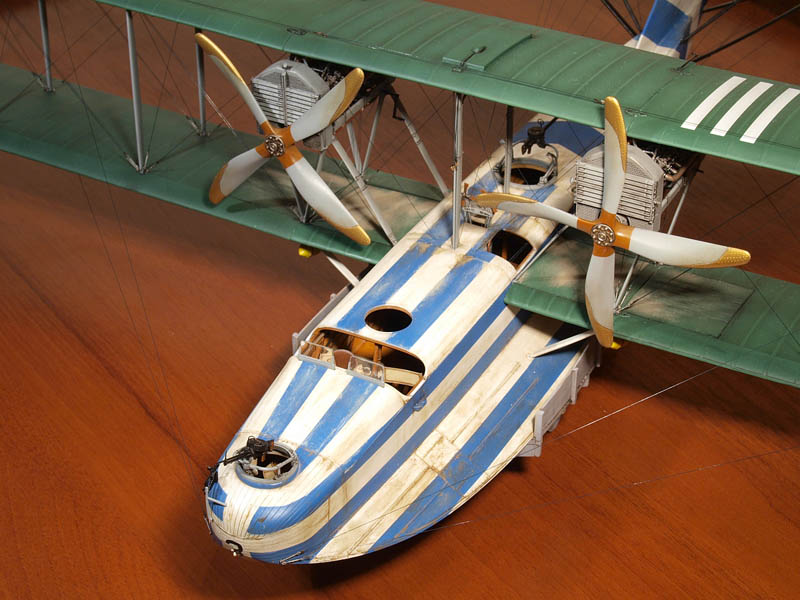

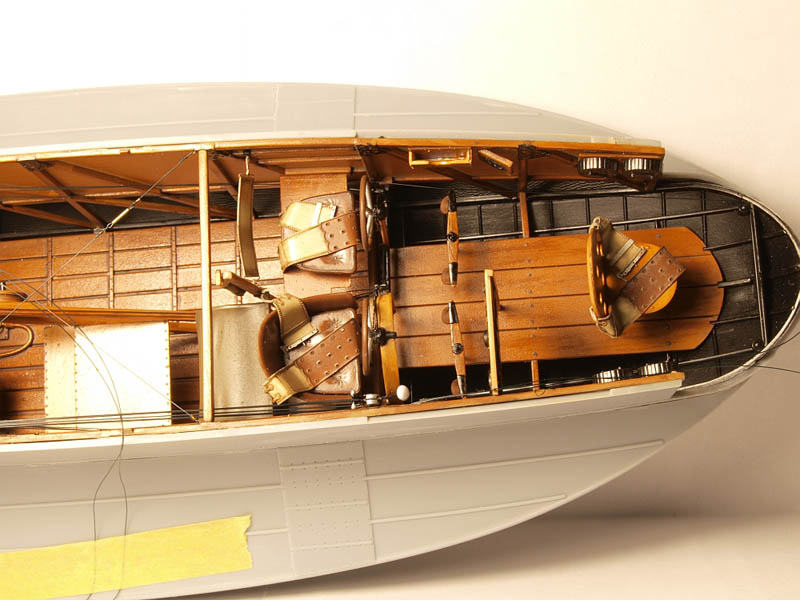

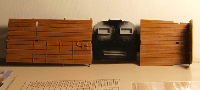

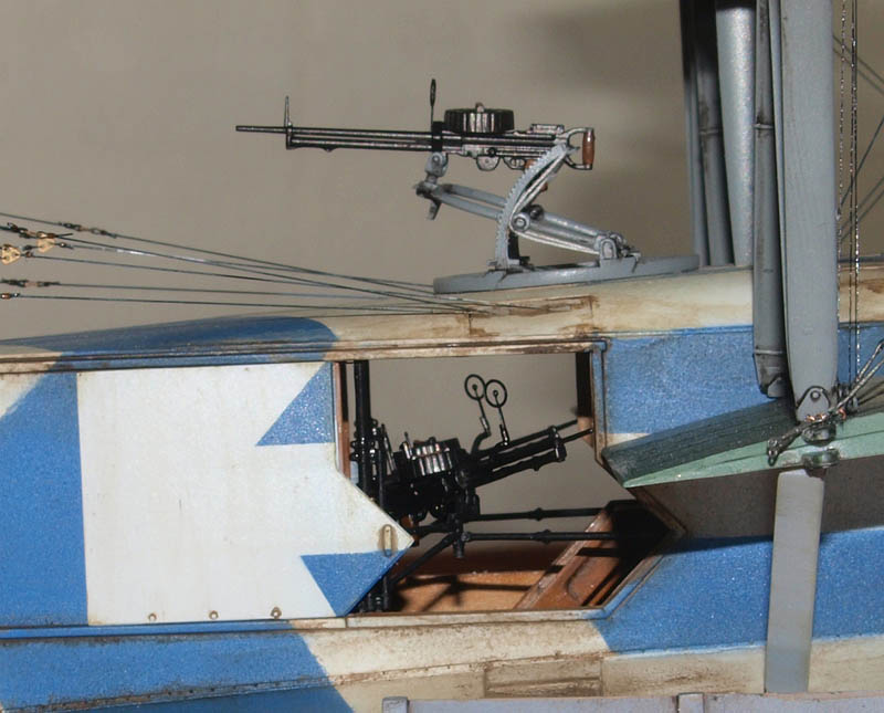

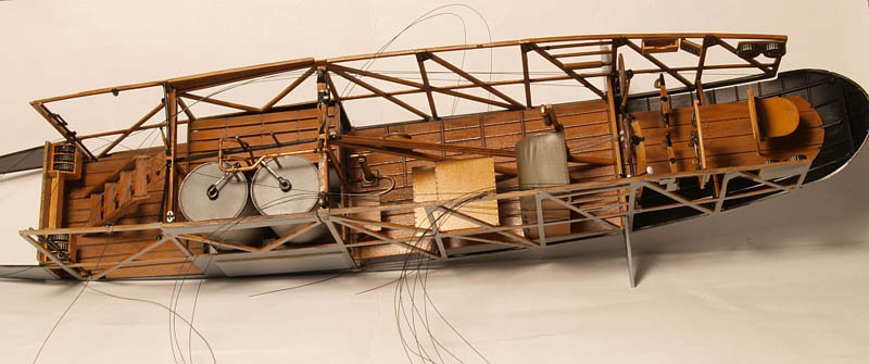

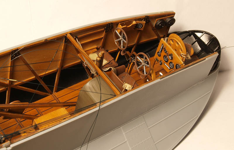

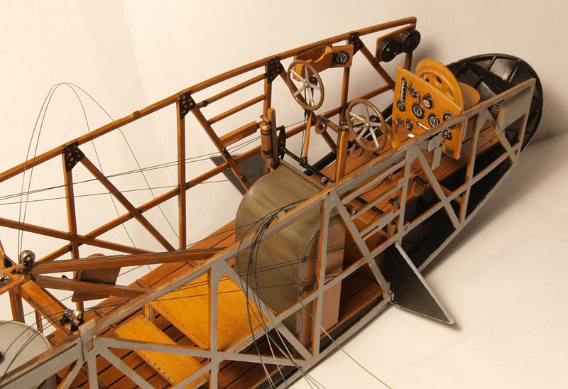

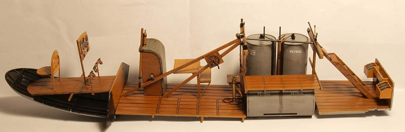

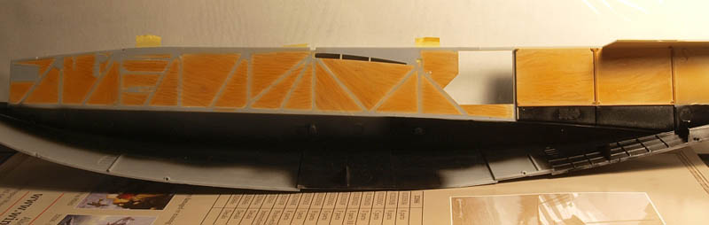

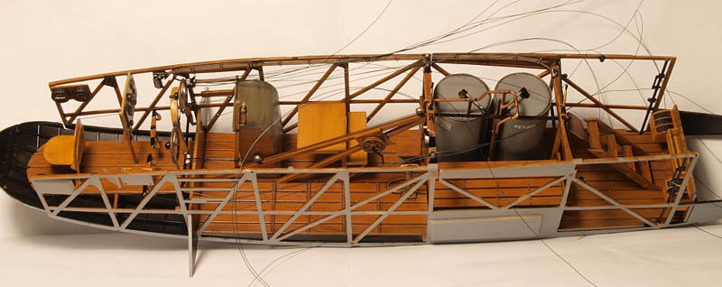

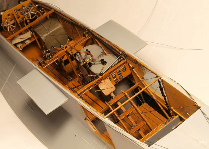

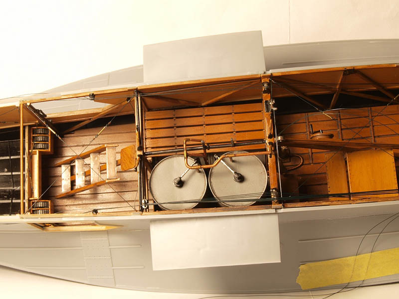

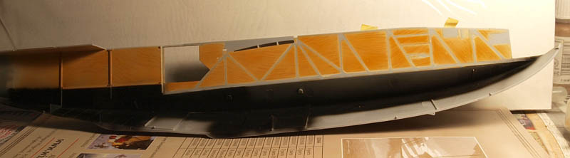

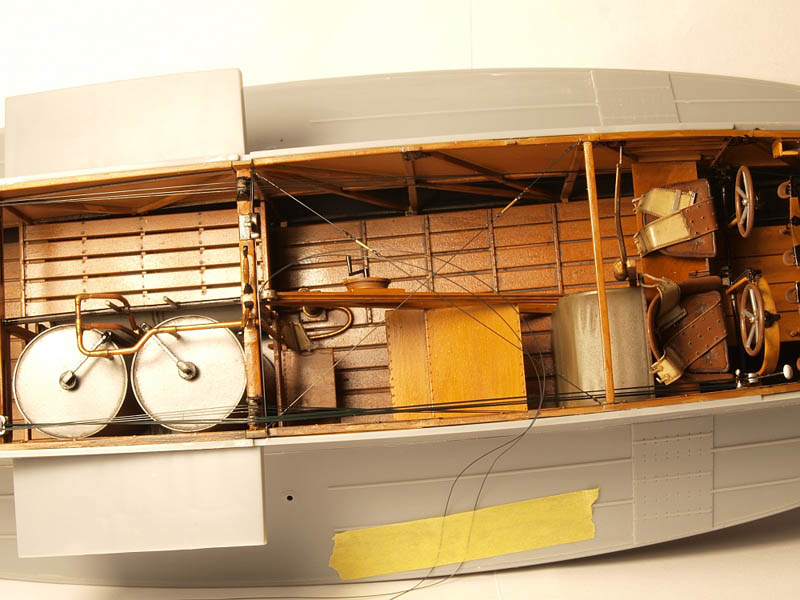

The contents allow for building the complete hull interior. Unfortunately there are not too many photos of F.2As interiors and their inspection does not indicate any need to enhance what is included in the kit, except for the rigging, control lines and engine steering cables. The existing photos of later variant F.3, more numerous, show some more details of intricate fuel installation but I decided not to add anything in this aspect to the kit, after all my plan was not too add any extra openings beside the cockpit and gun stations.

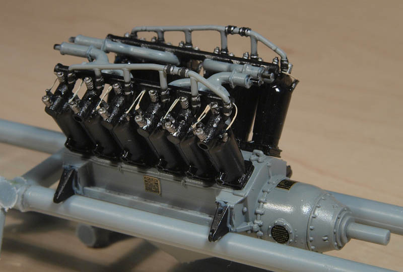

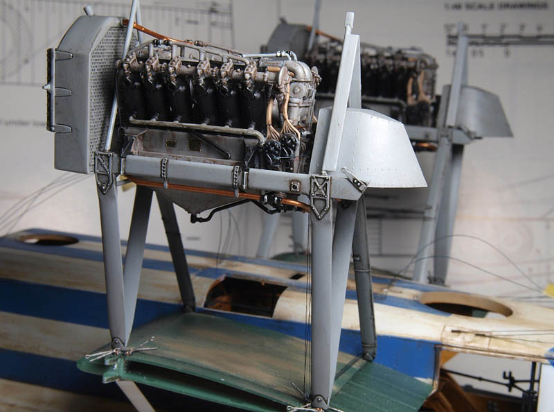

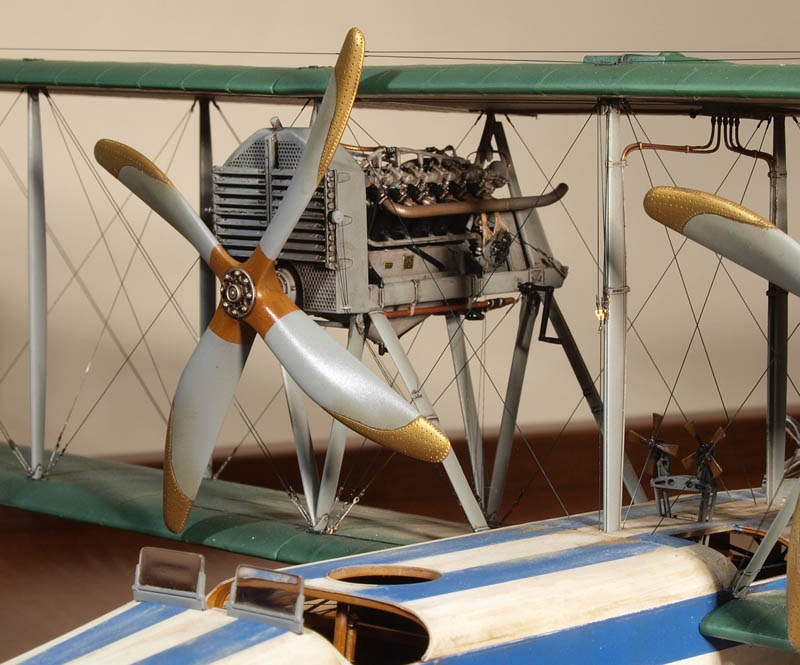

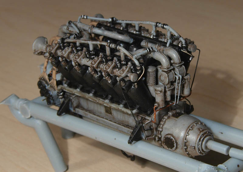

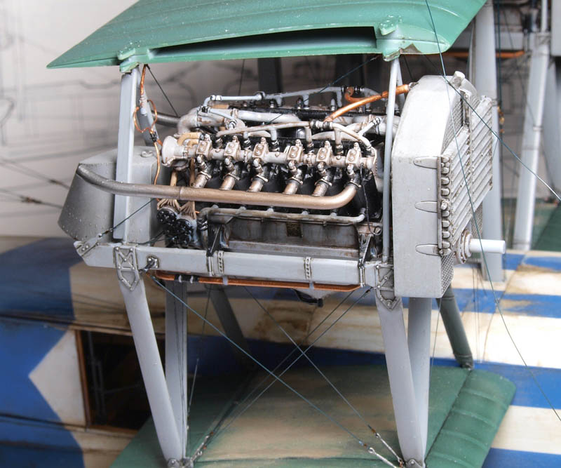

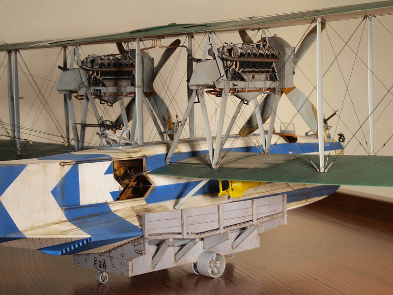

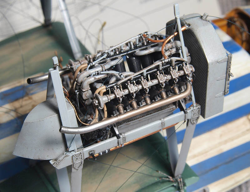

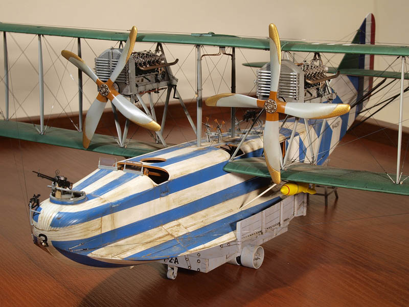

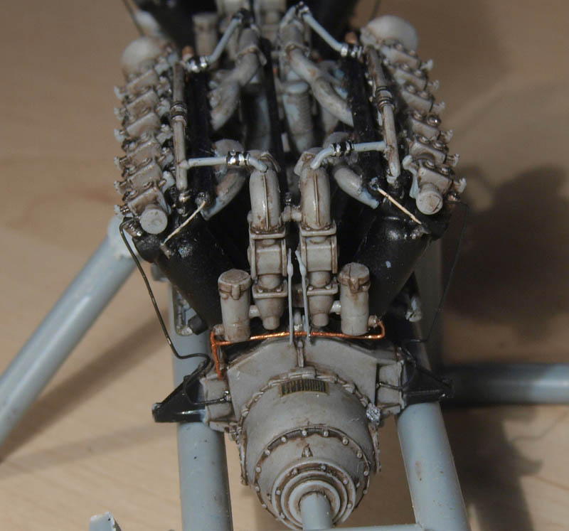

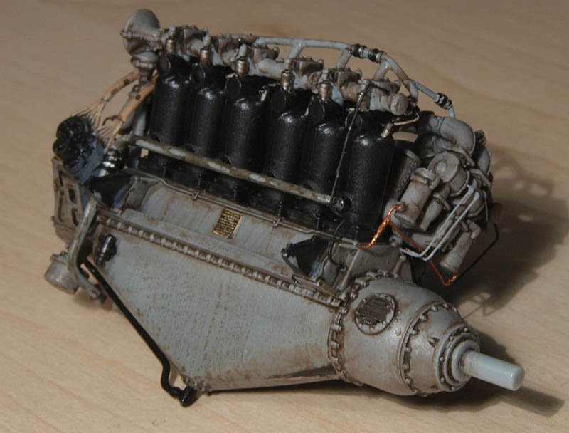

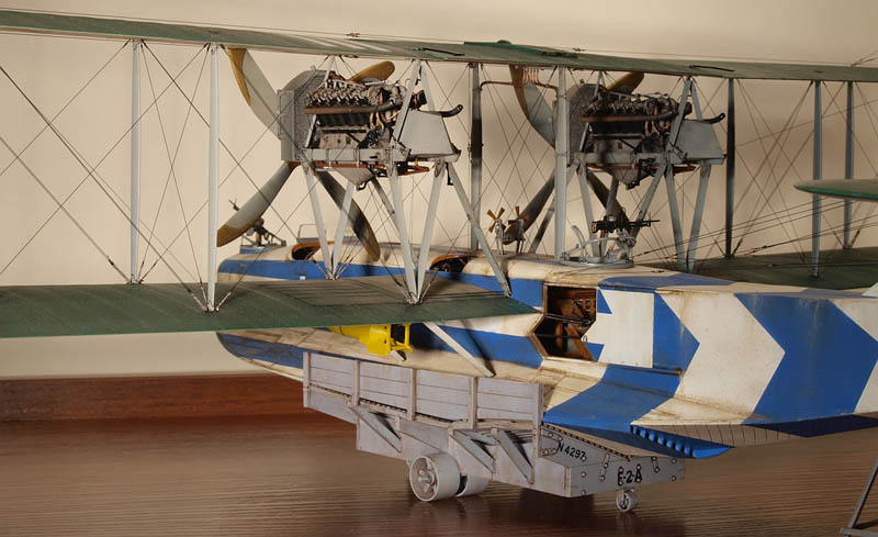

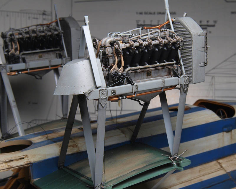

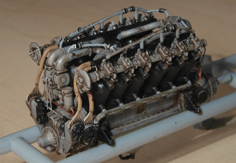

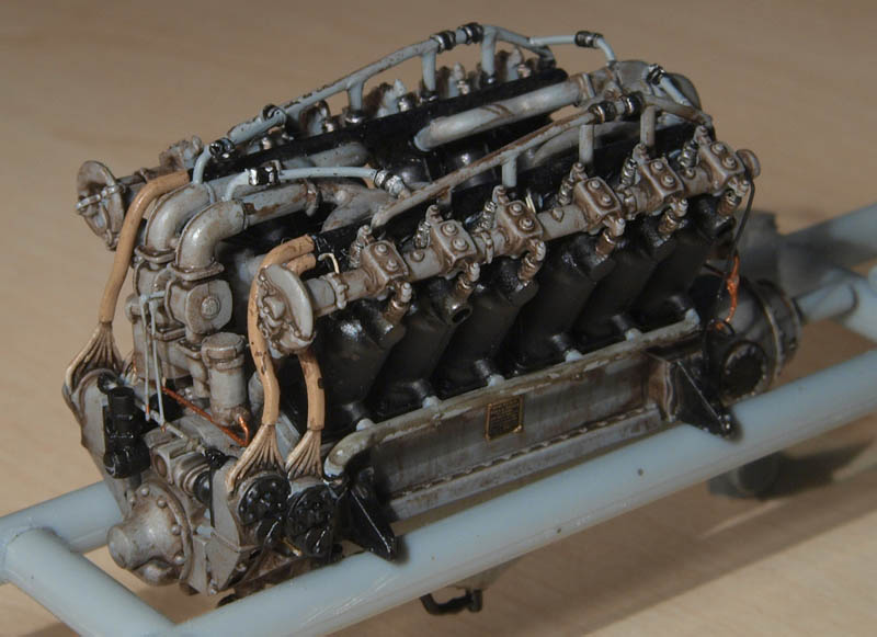

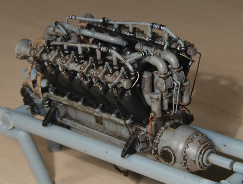

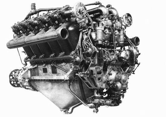

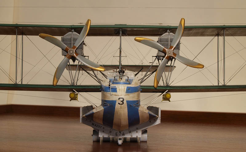

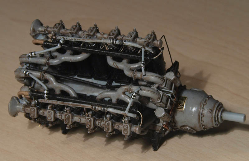

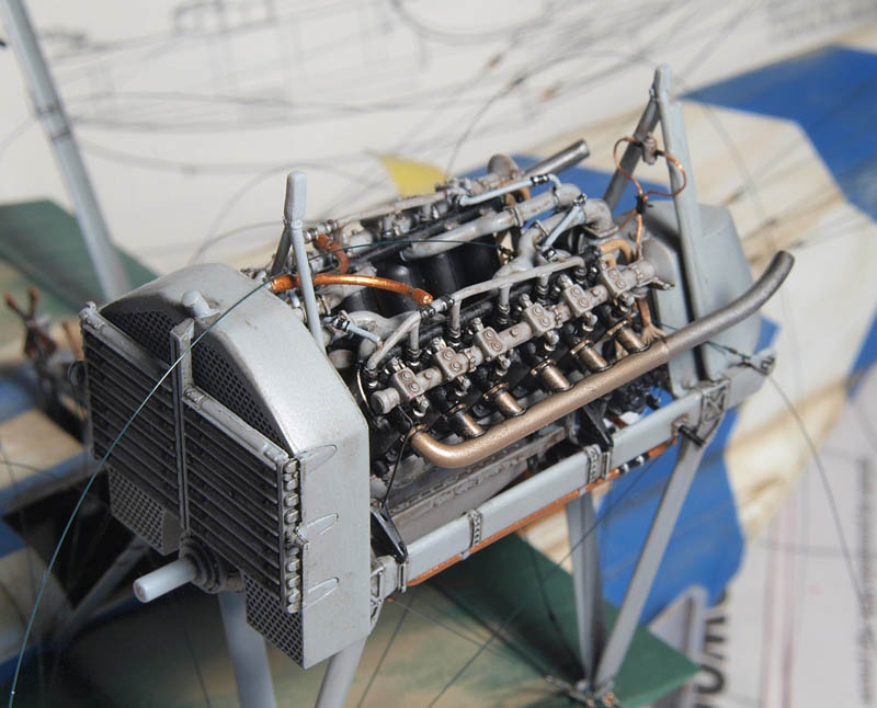

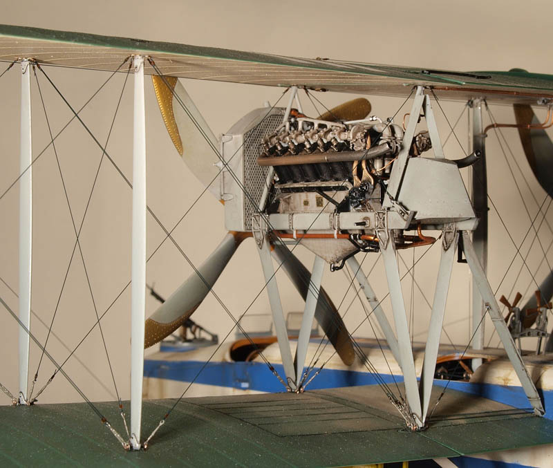

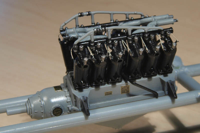

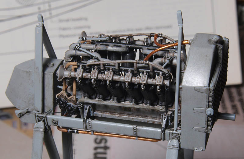

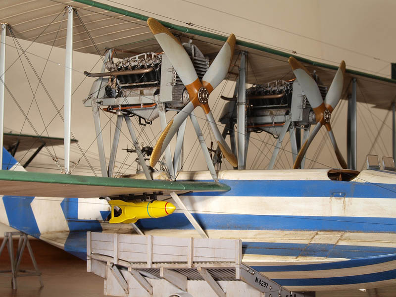

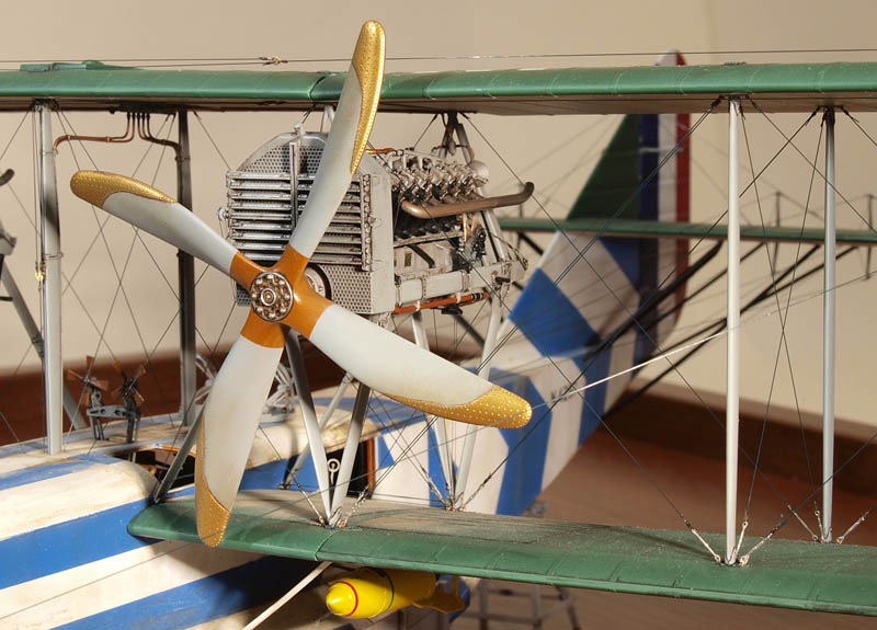

The second area which should have important details visible are two Rolls Royce Eagle VIII engines. Here several omissions in the installations are evident, as is usually the case with Wingnut Wing engines. Since the engines are fully exposed I decided to add all the missing installations.

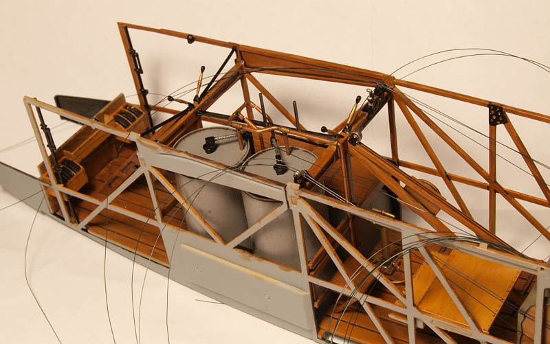

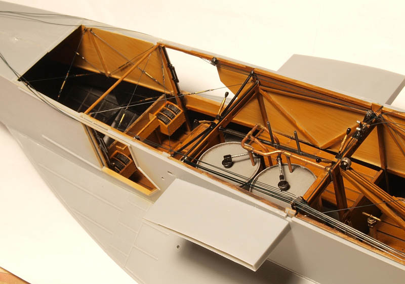

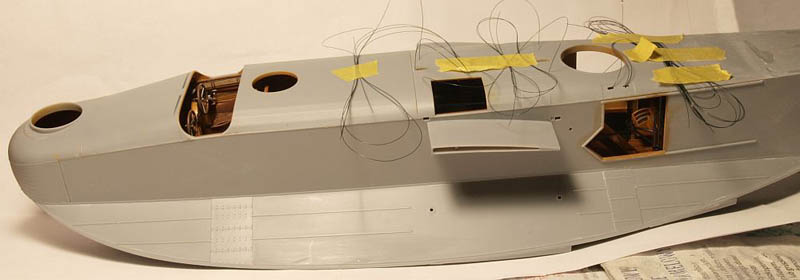

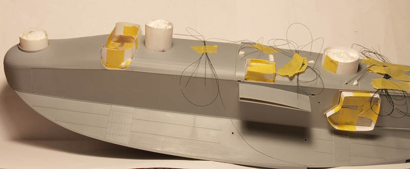

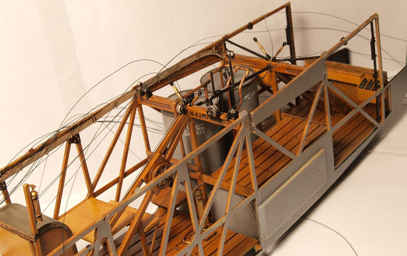

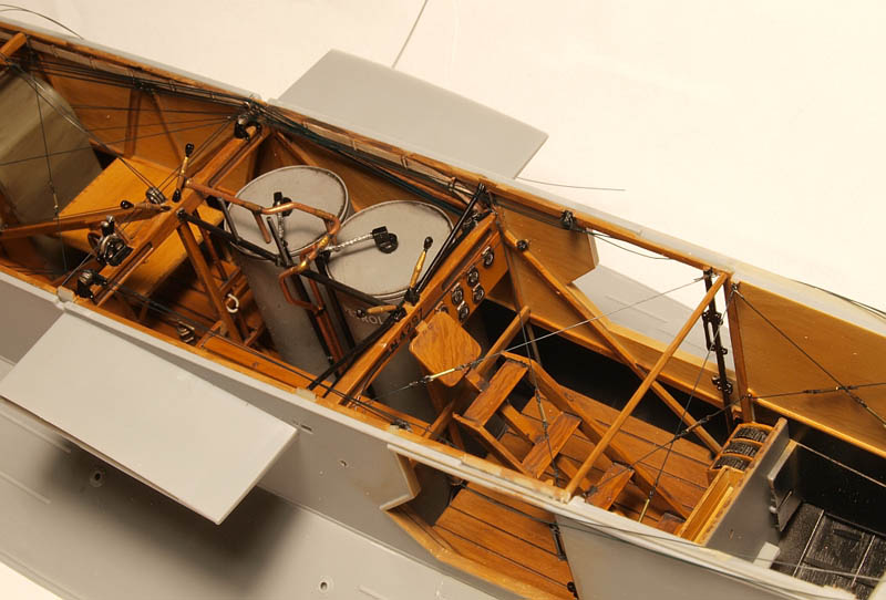

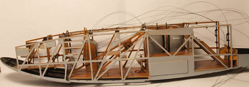

Hull Interior

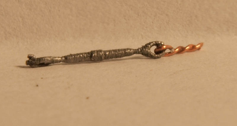

Internal structure rigging – monofilament fishing line

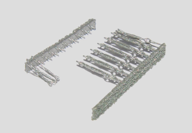

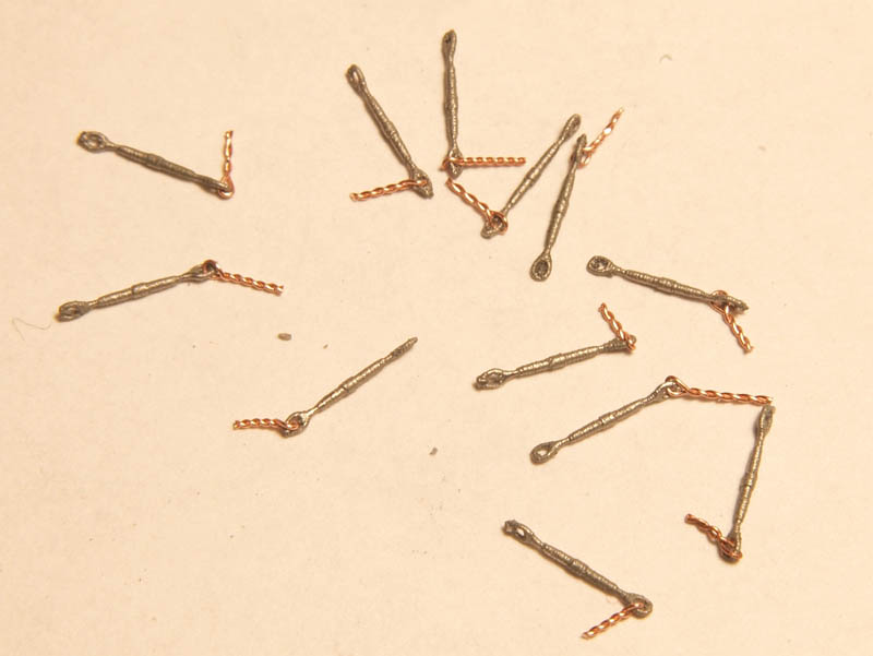

16 sections with turnbuckles from brass tube sections:

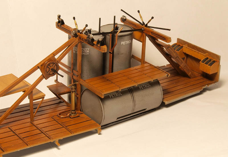

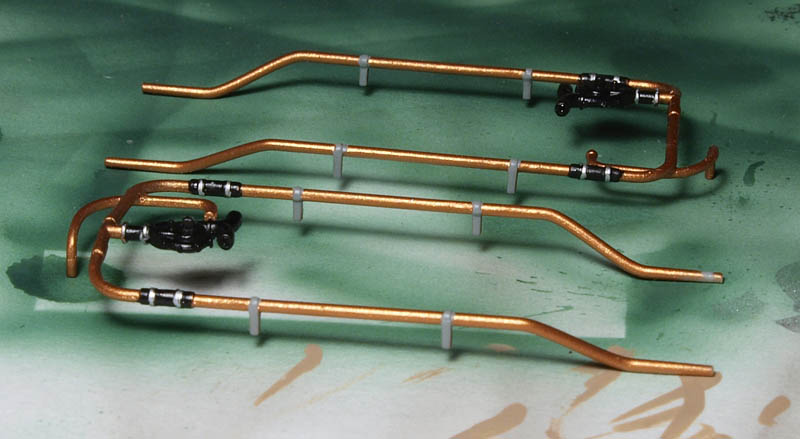

Control cables for throttles, carburettors and radiator blinds:
Lever and cables for bomb release mechanism:

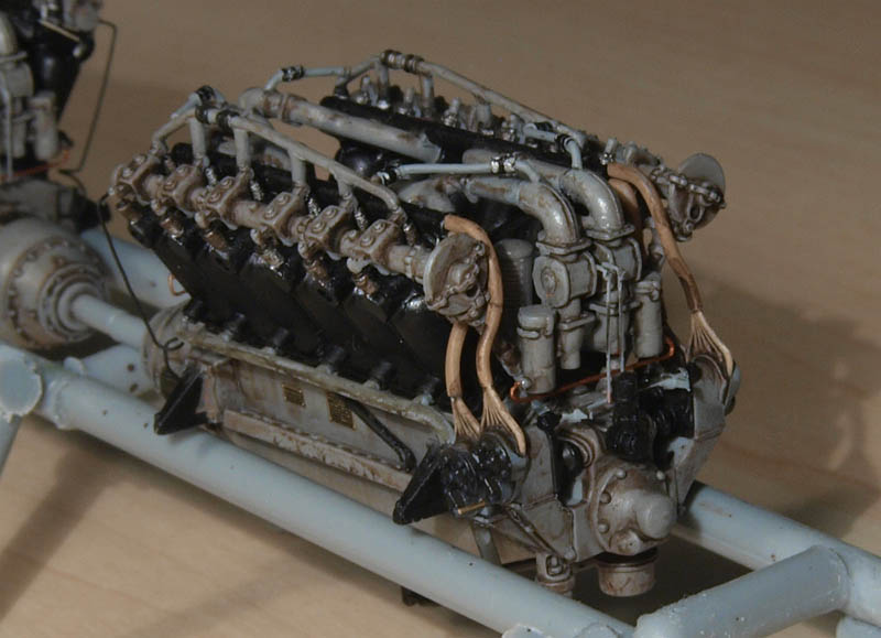

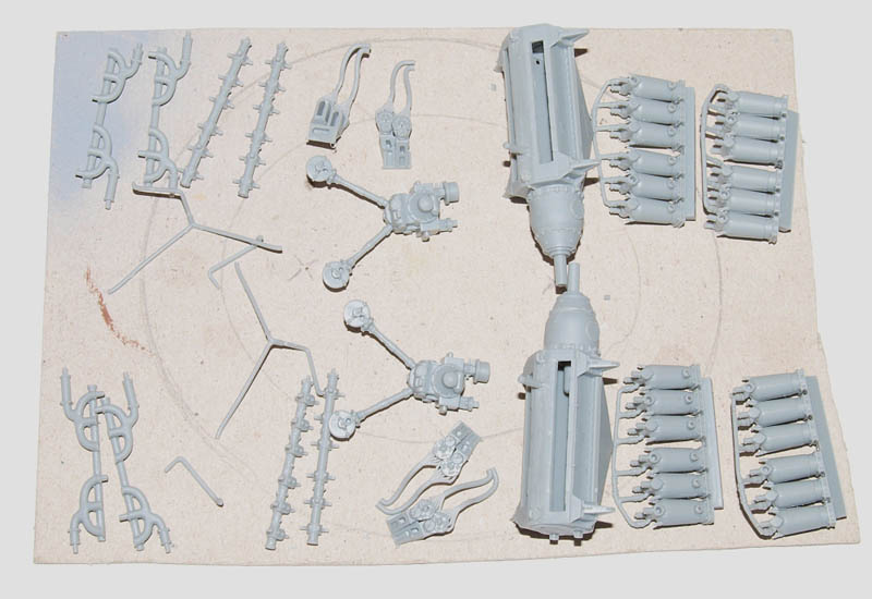

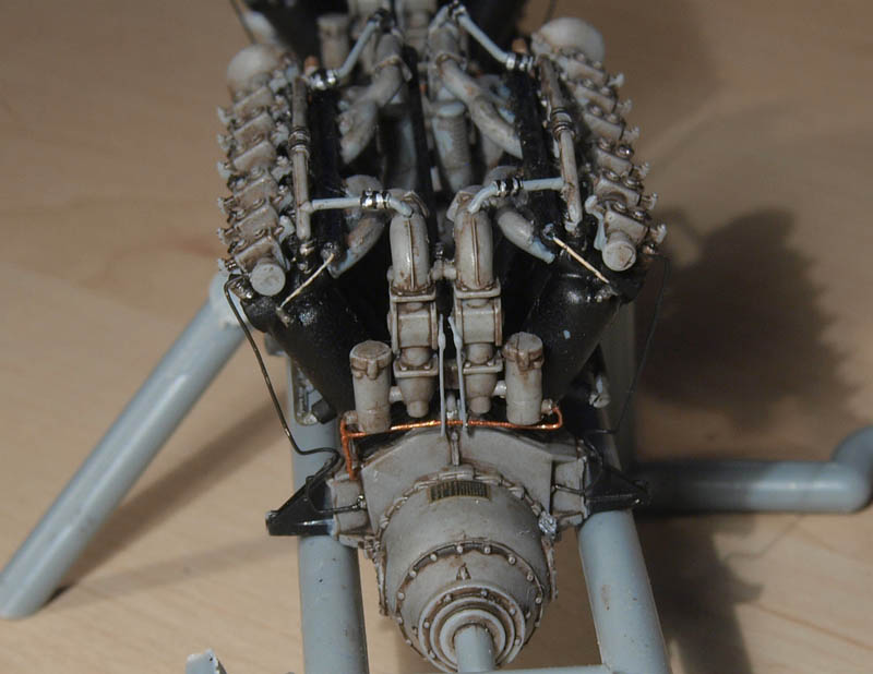

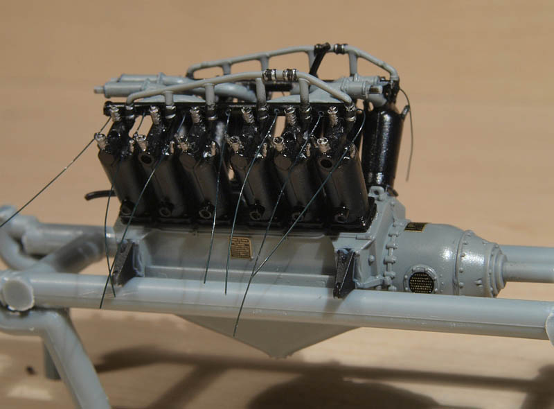

Rolls Royce Eagle VIII Engines
Electric cables from fishing line painted in beige:
- Cooling pipes for intake manifolds – soldering wire 0.5mm
- Fuel installation at carburettors – soldering wire 0.25mm
- Carburettor steering mechanism – copper wire 0.3mm
- Compressed air pipes – soldering 0.25mm
Magneto control mechanisms – wire and monofilament sections:
Carburettor steering cables – monofilament line and elastic thread:
Fuel installation with fuel filters – soldering wire 0,25mm and scratch:
Control lines for radiators blinds – elastic thread:

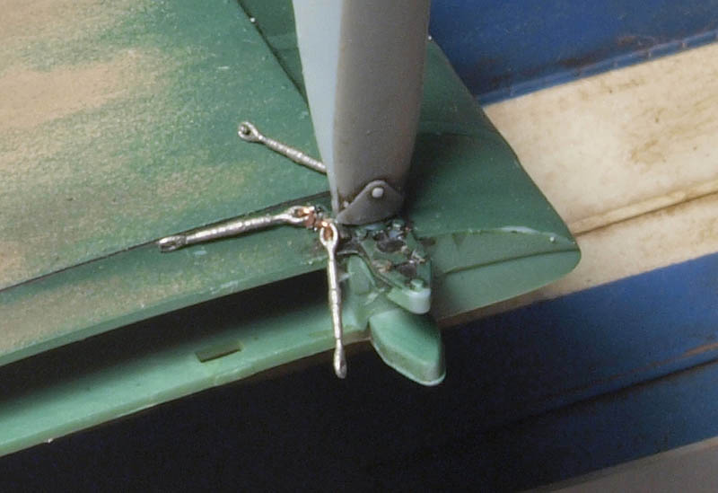

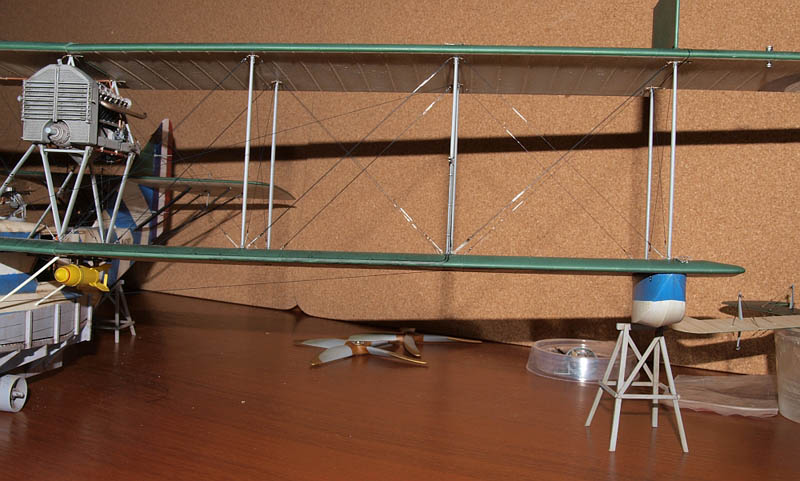

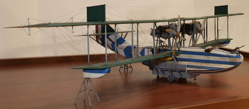

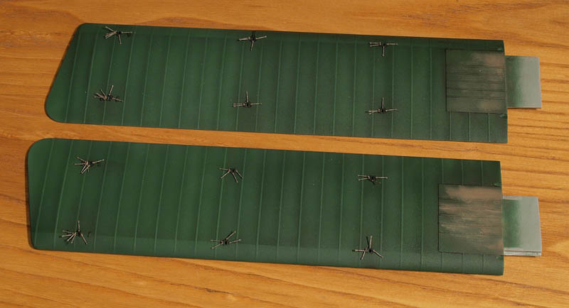

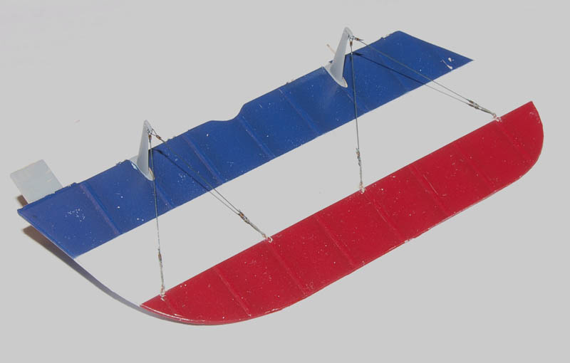

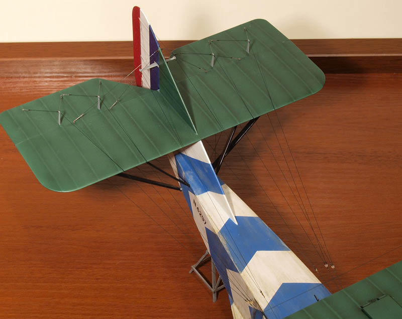

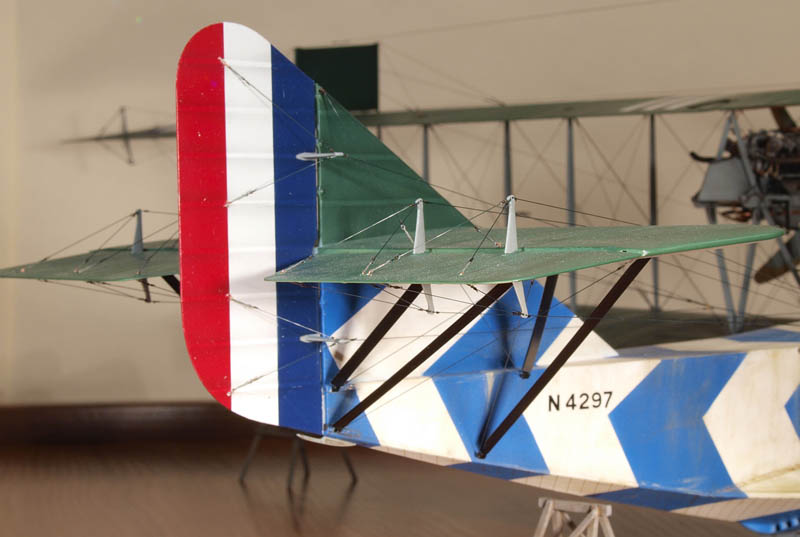

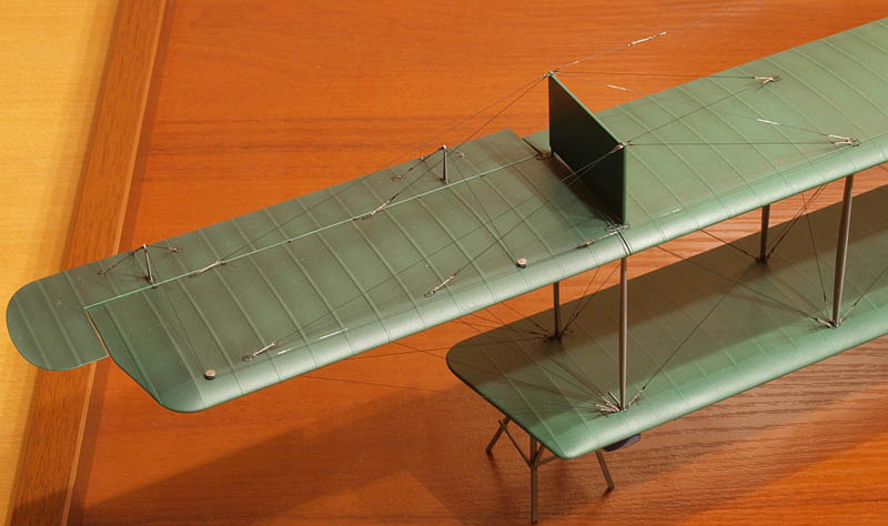

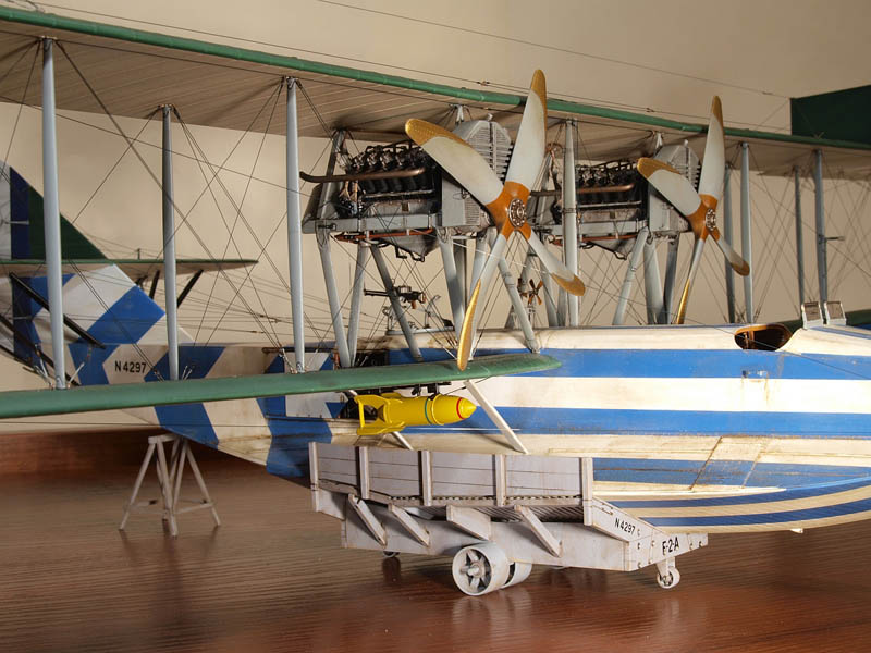

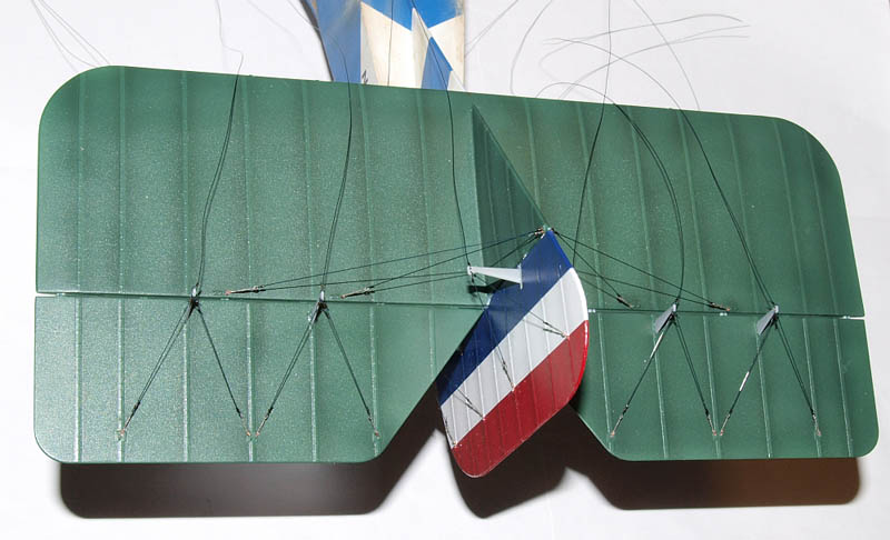

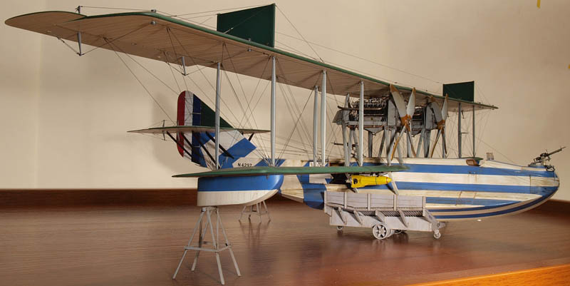

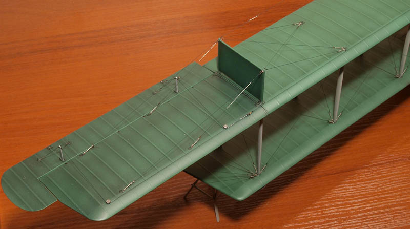

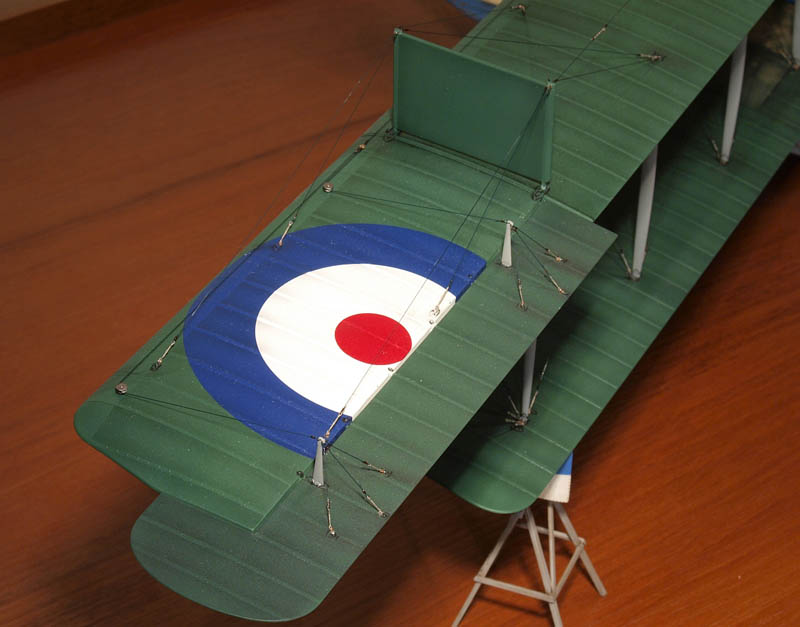

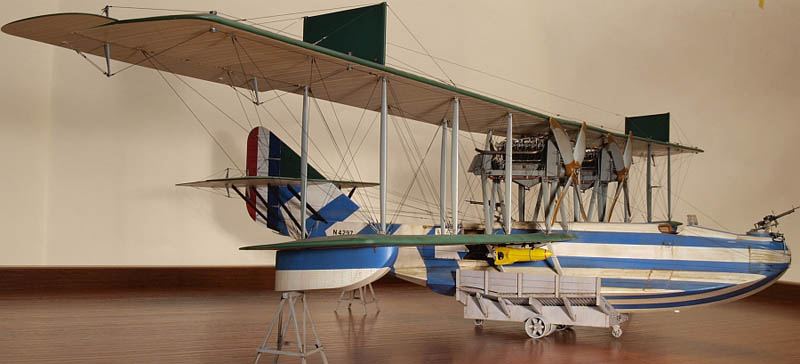

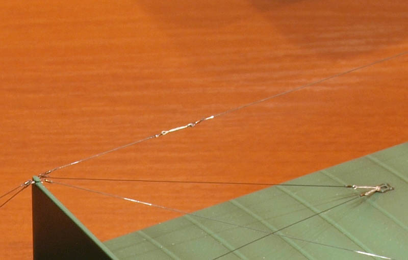

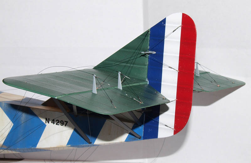

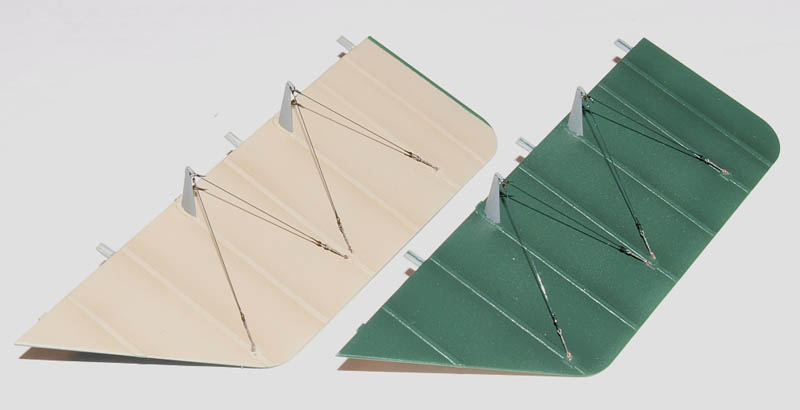

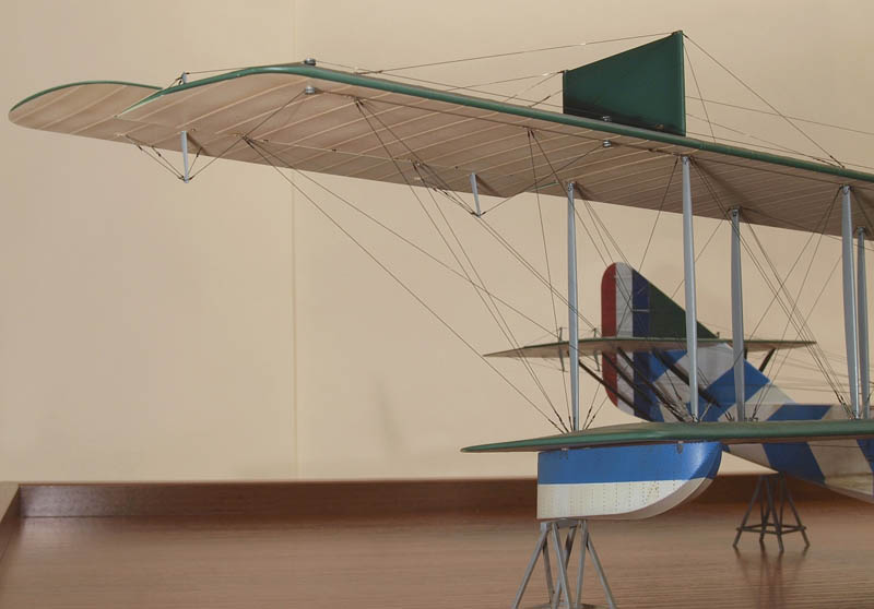

Rigging and Control Lines – Monofilament

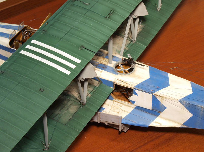

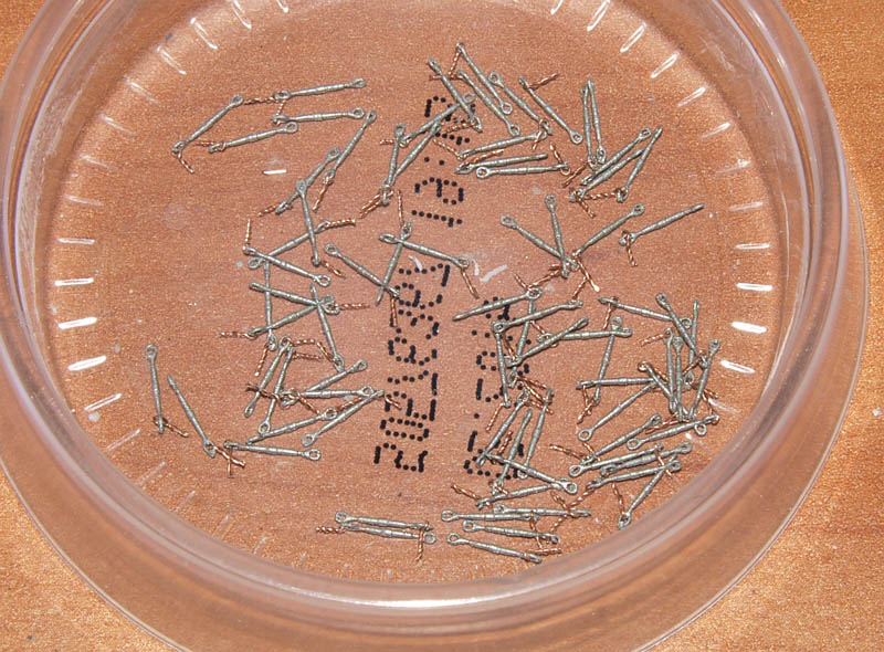

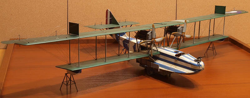

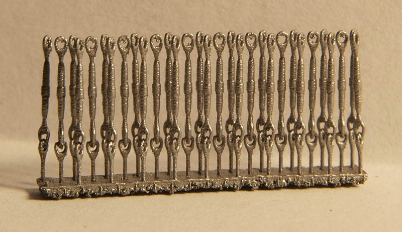

111 rigging cables with Gaspatch 32nd scale turnbuckles combined with self-made copper wire eyelets to achieve the proper hinged connections allowing for proper alignment of cables after tightening.
About 60 control cable sections with smalle 48th scale Gaspatch turnbuckles.

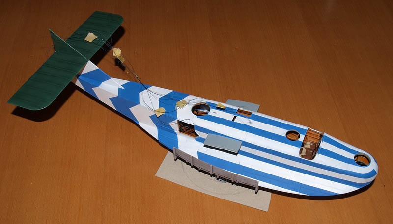

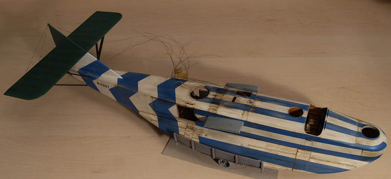

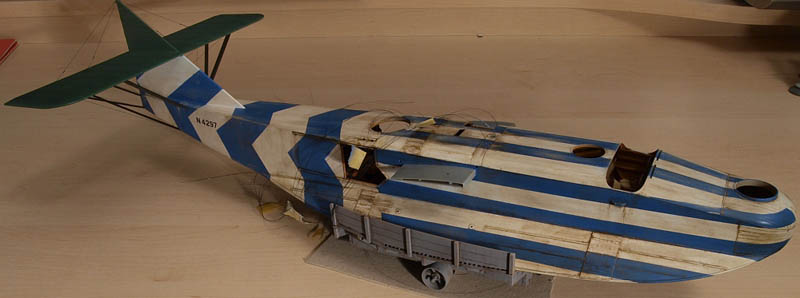

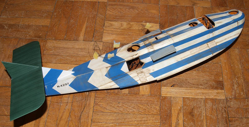

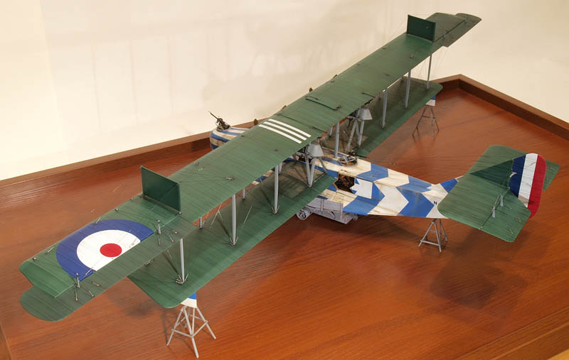

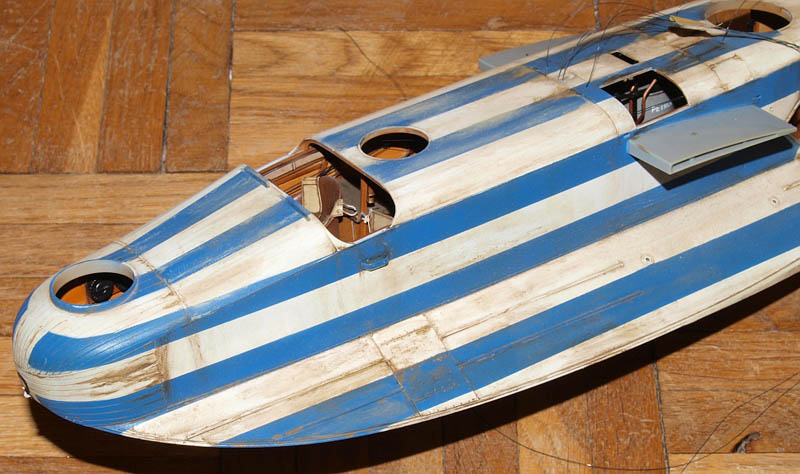

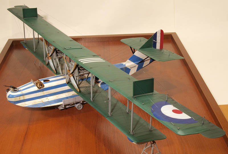

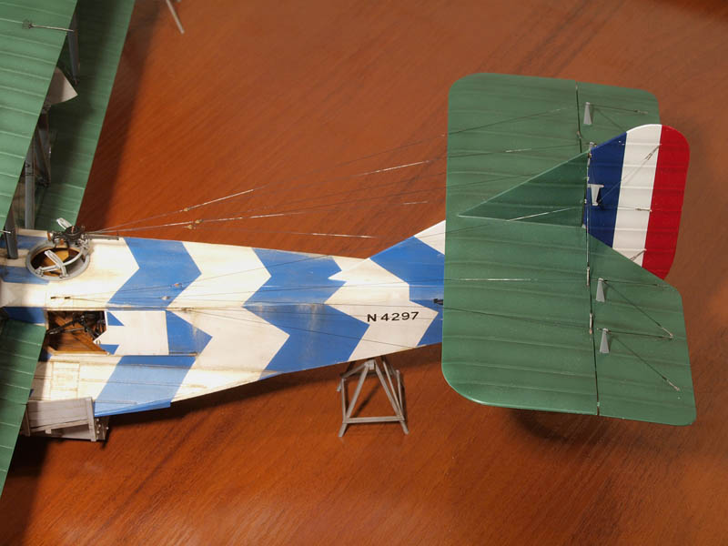

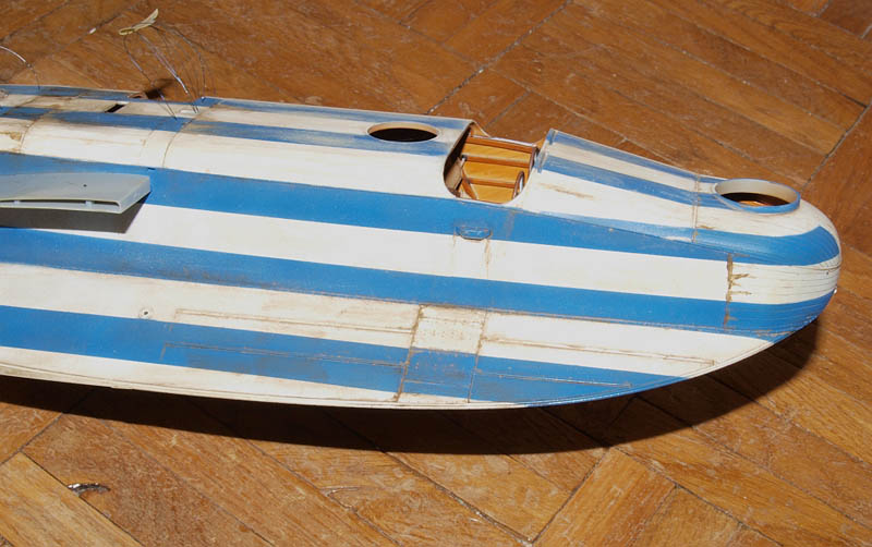

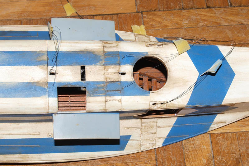

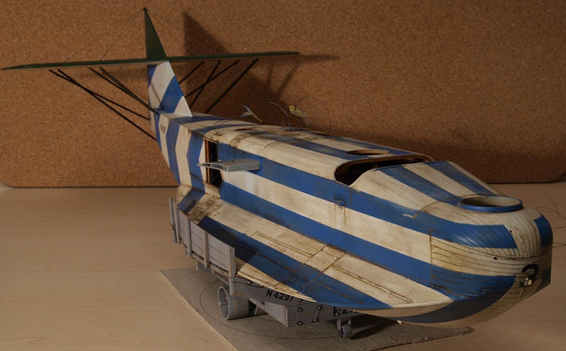

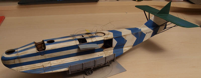

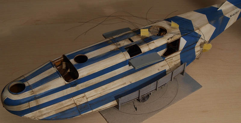

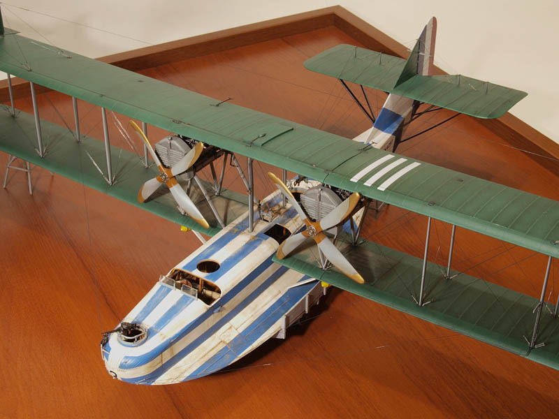

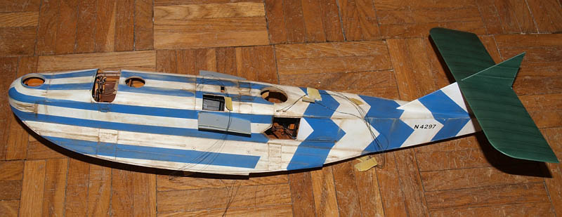

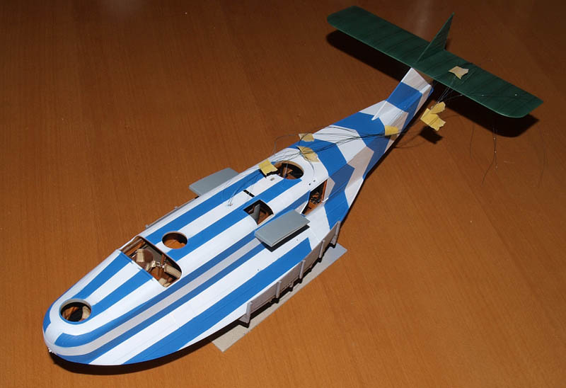

Paintwork and Weathering

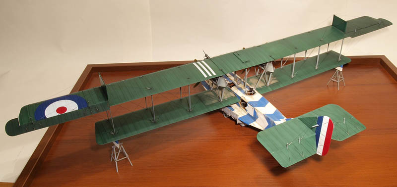

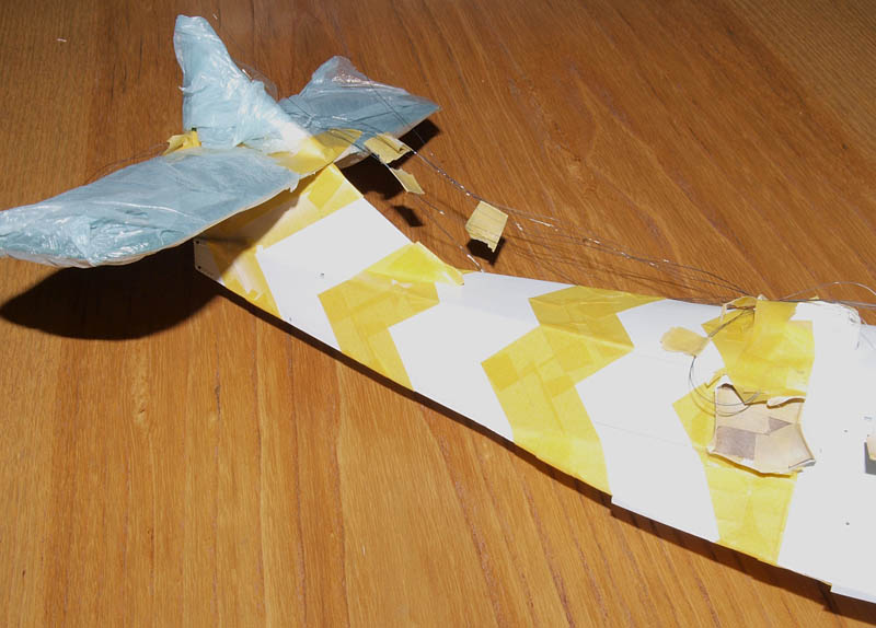

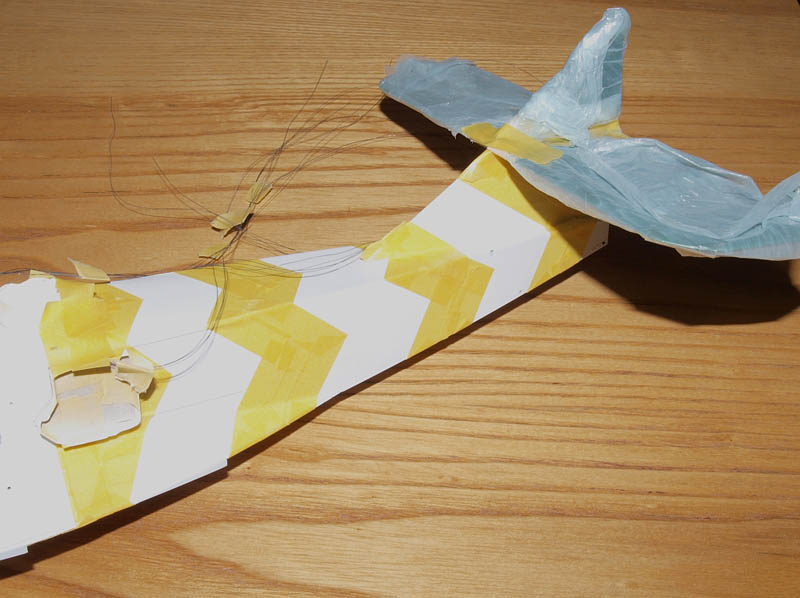

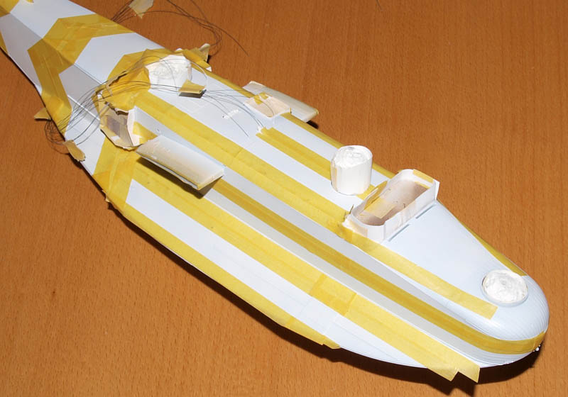

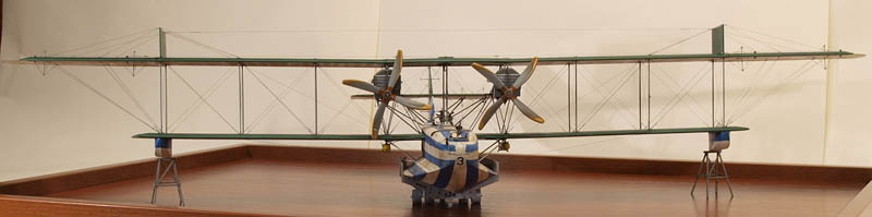

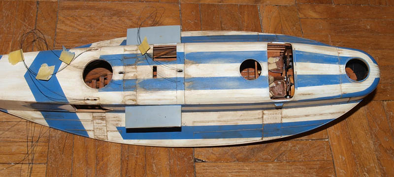

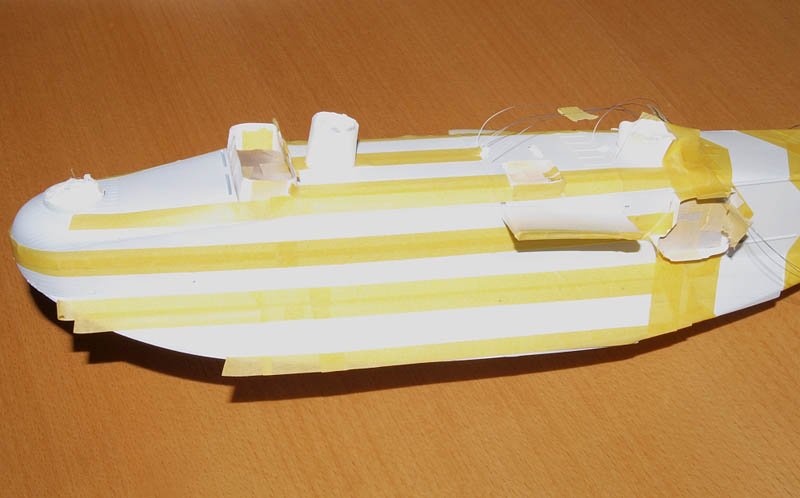

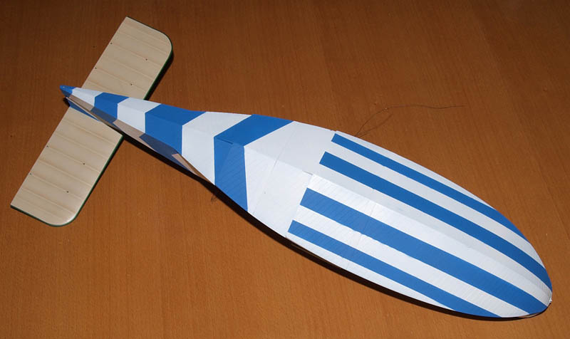

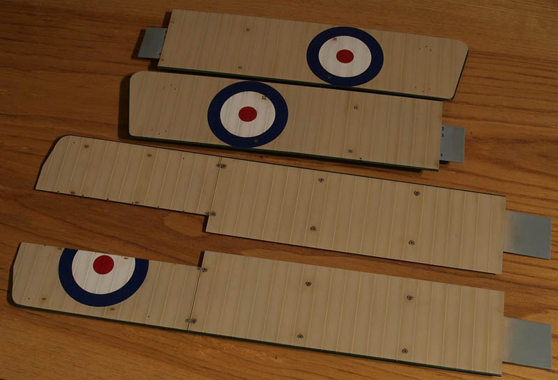

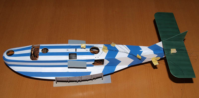

White-blue pattern of stripes and chevrons consumed a lot of masking tape and time.
Hard weathering – wash with several colours and dry pigments Tamiya Weathering.

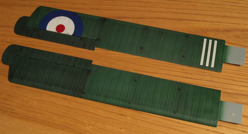

Replaced right upper wing tip and ailerons – lack of cockade and darker (less faded?) green shade.
Postshading of flying and control surfaces.

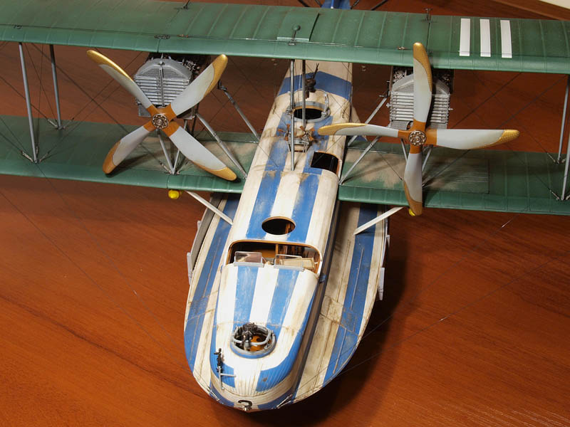

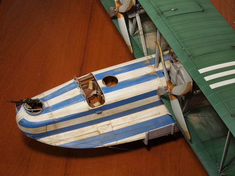

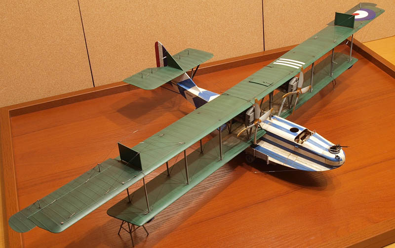

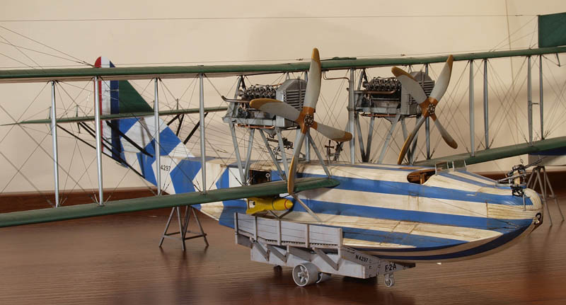

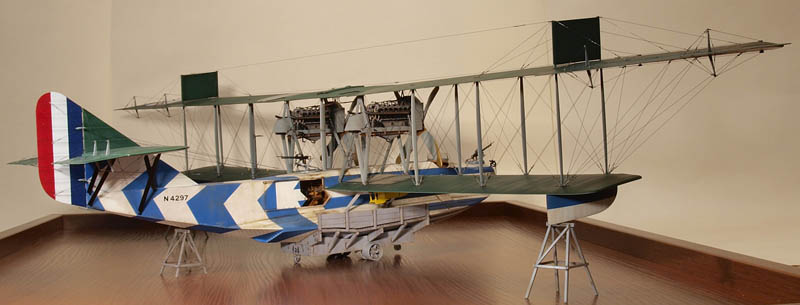

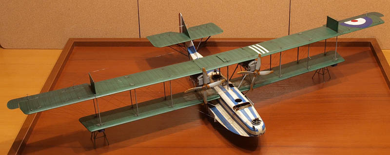

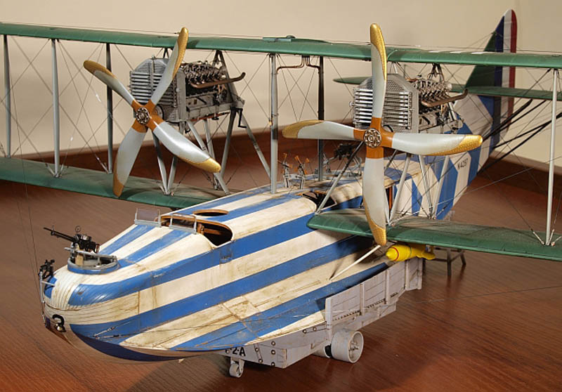

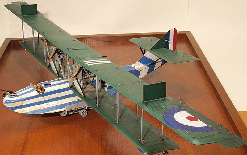

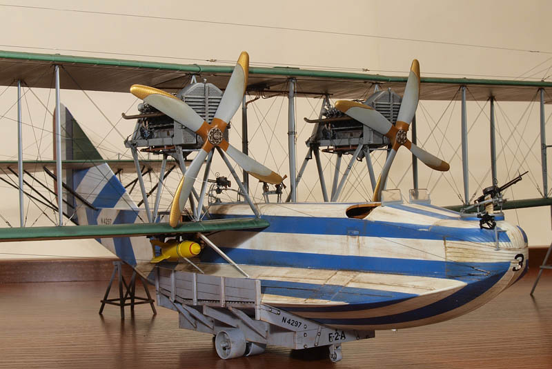

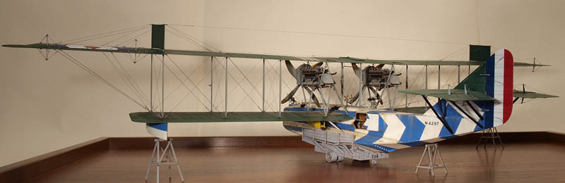

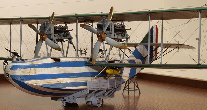

Completed Model

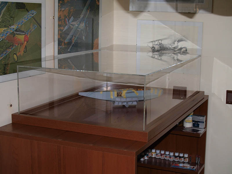

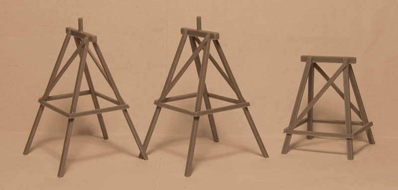

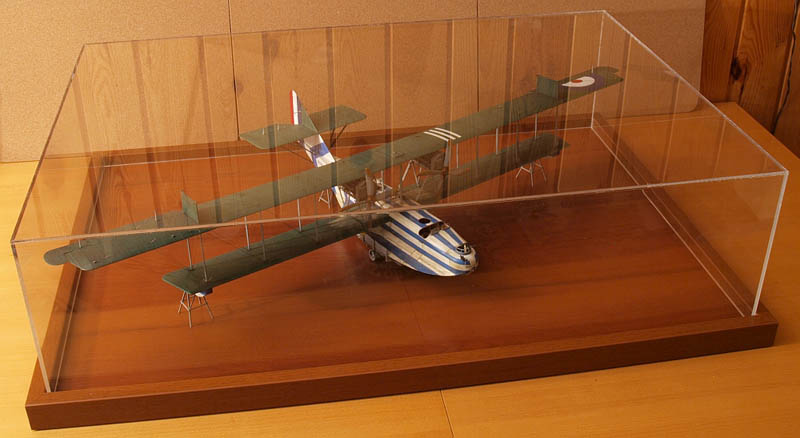

Exhibited in a special cabinet with wooden base and plexi cover. I have decided to follow the proposal from Wingnut Wings to support the wings with trestles. Still, my feeling is that with the structural rigging and very solid wing cellule structure it would stand its weight without those extra supports.
