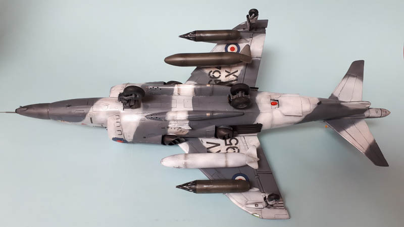

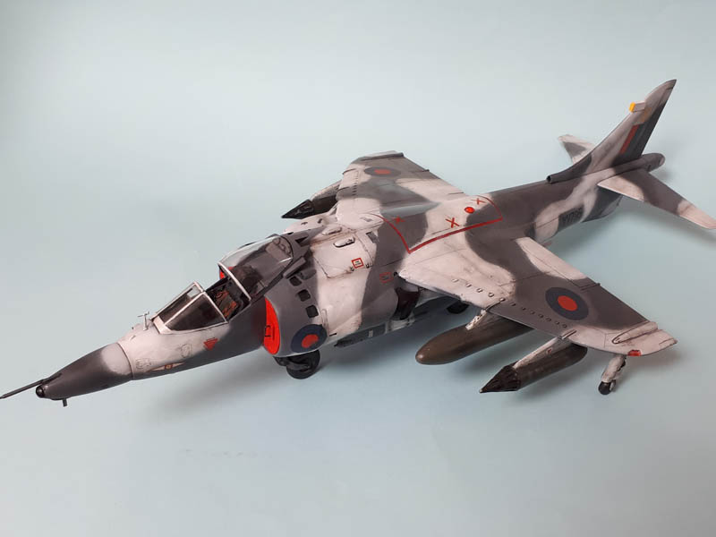

This is my favourite aircraft - I love the shape and Arctic camouflage and had already built 1/72 and 1/48 versions. It doesn't come in 1/32 however, so I converted Revell's Gr.1.

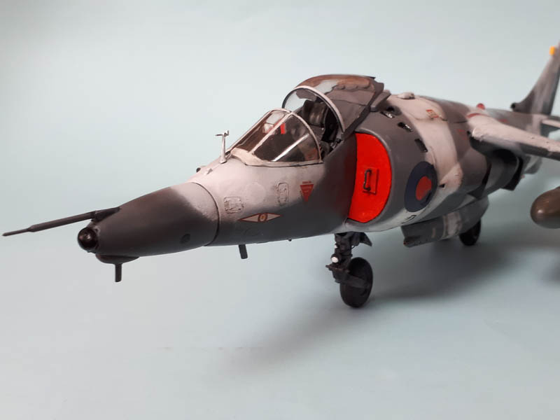

The distinctive nose is built up with Milliput around an old drop tank. I also added the tail RWR sensor from cardboard, cannon barrels from brass tubing, pitot tube from a needle tip and seat and instrument panel details.
Painting is done in Tamiya acrylics.
