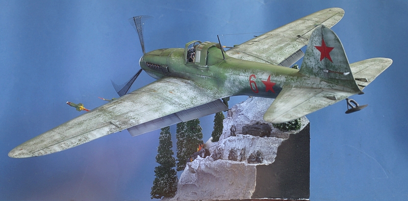

Planning

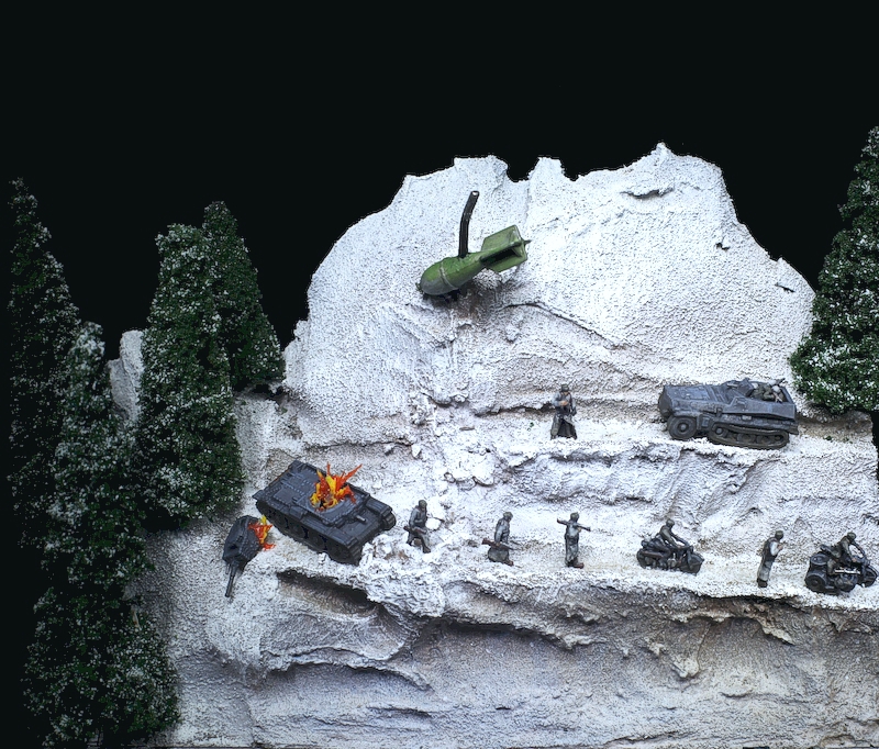

Dioramas of this nature need to be dramatic to be eye-catching. I decided on forced perspectives and action to make the flights, fires and fights believable. I’d used sound and motors in the past but that typically isn’t very effective. Just watch a period documentary and decide for yourself. The main plane the IL-2 Sturmovik would be just pulling away as a bomb was released. In addition, the cannons would be firing, and a rocket deployed. A Panzer 38(T) appropriate for early war had been knocked out from a previous run that caused an avalanche and the rest of the troops are wearily retreating down the mountain pass. IL-2’s employed a closed chain attack formation where they would strafe an armour column and protect the plane in front of them. Not for naught they were called the “Black Death” by German forces.

Hobbyboss 1/32 IL-2 Sturmovik on Skis
The kit was an easy build. All told it took less than a week to build it. There were no problems pertaining to fit an accuracy. The testiest problem is the transparent cowling cover which tends to crack due to the clear plastic. I hate these see-through parts and most people paint them anyway. The ordnance is ample and redundant at multiple levels (i.e. loads of spares). I turned a thimble to take a piece of hangar wire and installed that on the planes centre of gravity. This lines up nicely on the base centre-of gravity, and the wire could be bent out of view as a cantilever.

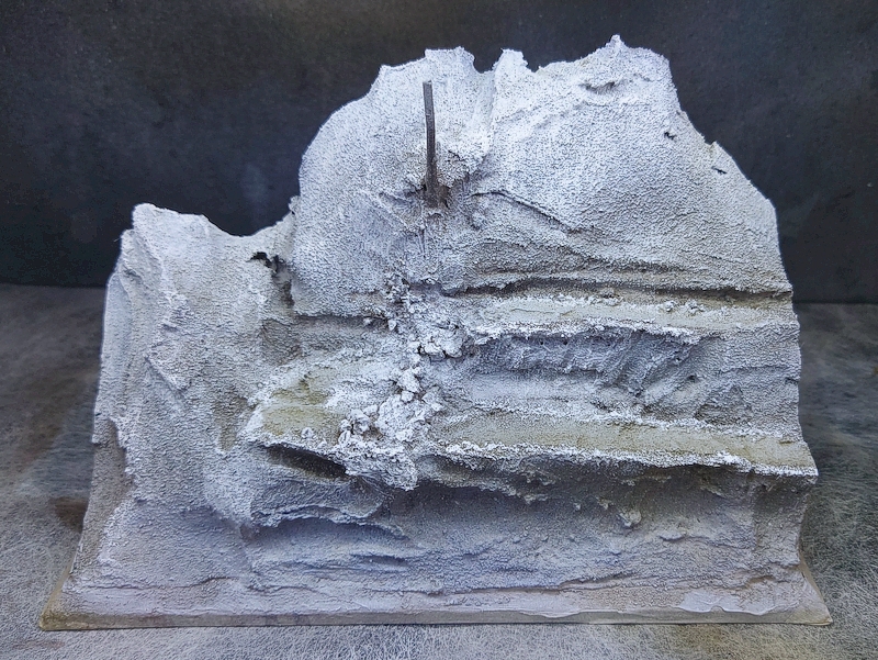

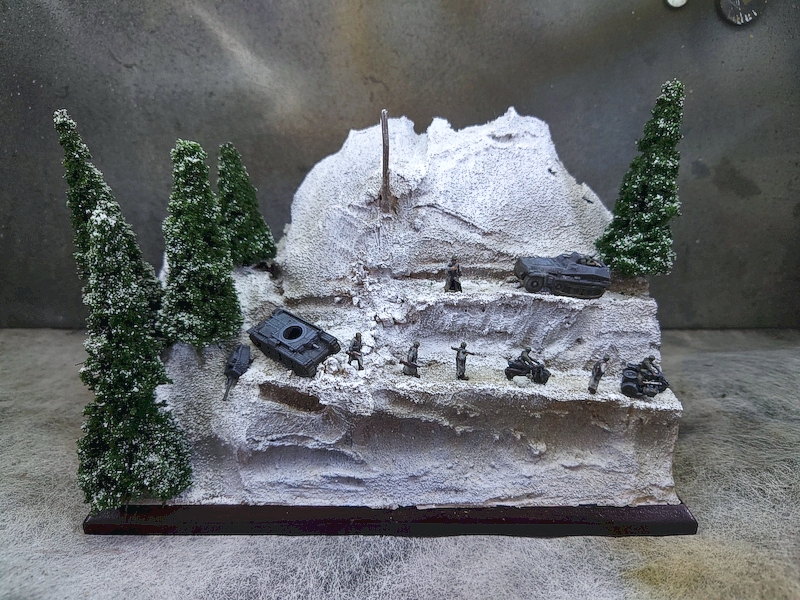

Base

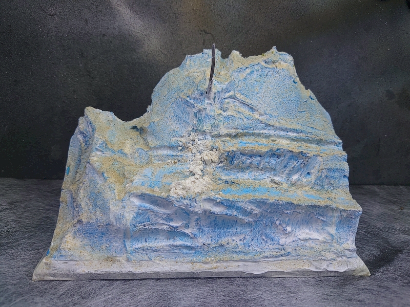

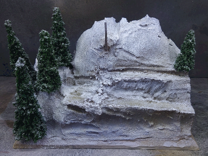

The base is a solid pre-fabricated base from High Planes Models. The mountain range is carved from Styrofoam with sand for texture. The fir trees are come in a set from Woodland Scenics. I used clothes hangar wire in the base that goes through the mountain range and out at its peak in a way that centres the plane on the base. A bomb hides it further so the plane looks impossibly suspended. It s quite stable like this. The 1/144 German figures were actually DAK figures that were modified with winter gear. These all came from an eBay-based company Kamiya that appears to 3D print them upon order. Comparing prices this was the cheapest option on the web but still quite costly.

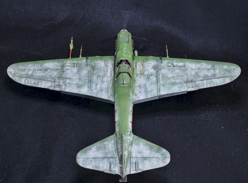

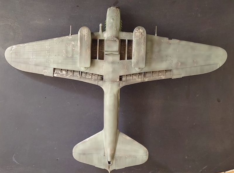

Painting and Markings
The markings for “Red 6” were provided in the kit. I wanted the paint job to be heavily weathered and so I base coated with silver. Coated with sand in diluted PVA finished off the Humbrol 131 (Russian green). Then more sand and then white. The models were base painted in Humbrol enamels, varnished with Future-Tamiya Flat acrylic, weathered with turpenoids and chipped sparingly. I used oil washes for weathering and drop filters for colour variation. The worn silver was a combination of sponge dabbing, silver pencil and undercoat with black and brush painting silver. I’ve not seen this paint job attempted by anyone effectively and I think the technique does the colour plates and photo references some justice.

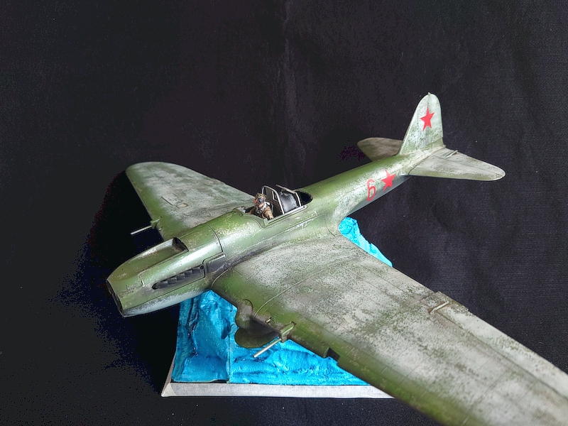

Figures
The pilot figure is modified from an Airfix Multipose American Marine in 1/32. I use Easy Sculpt for the details that show a pilot in Arctic gear.
