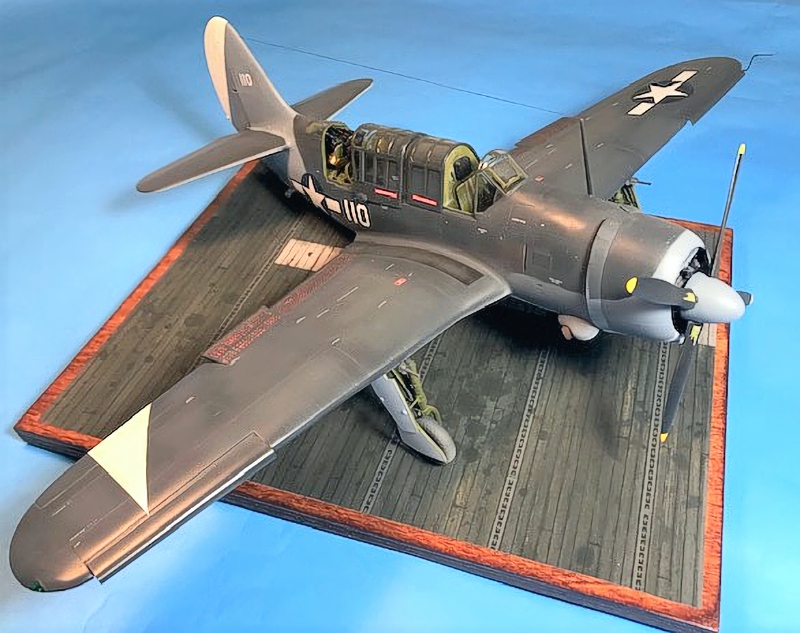

When Infinity Models announced a model of the Curtiss SB2C-4 Helldiver as their first 1/32nd scale injection molded kit, myself and a lot of others who build in this scale got very excited, particularly since the parent company was HpH Models who are known for very high quality large scale resin kits. Unfortunately, this first effort let us all down to some degree. The major parts (fuselage, wings, tail surfaces, clear parts) are very nicely done, but everything else in the kit suffers from poor fit and soft details. Every part has to be cleaned-up, plus vague instructions, etc. A friend of mine who also has one speculates that maybe one out of every twenty sold will ever get built in the end.

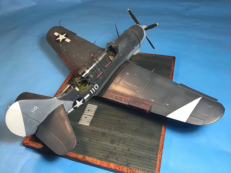

It took me over five months working on it off and on to finally finish this model, one of the hardest kits I’ve built in a long time. Several times it almost ended up sailing out my second-floor hobby room into the backyard for the dog to chew on. Besides the soft details, the runners are oversize and run into each part making clean-up an extended chore. I can’t tell you how many hours I spent just cleaning up each part to make them usable. Other than making my own seat and lap belts, the model is built out of the box.

Again, this is not a Hasegawa or Tamiya quality, shake n bake, model kit. It certainly challenged all of my skills, but in the end, I am happy to have a 1/32nd scale Helldiver to add to my collection of large scale USN WWII models.
