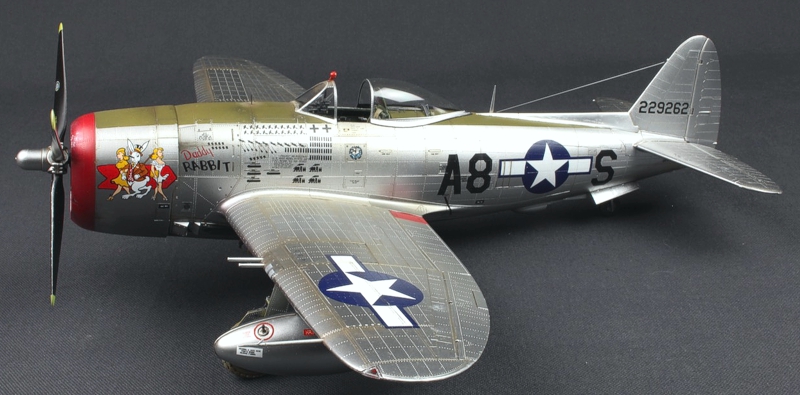

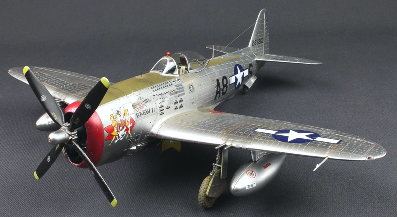

Trumpeter 1/32 P-47D Bubbletop
By Luc Janssen
![](/articles/images/3666/3666-1.jpg)

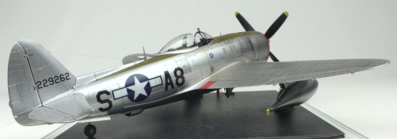

Introduction

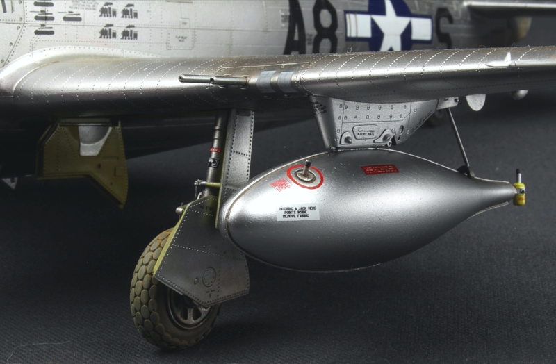

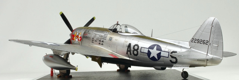

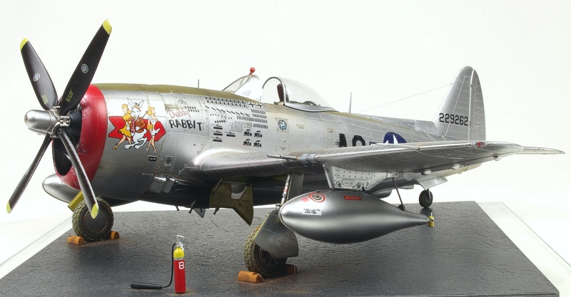

This kit is of the standard Trumpeter quality: the overall look is good but fine detailing is not to be found here. I decided to build a late war P-47D equipped with drop tanks filled with napalm. In the final stages of WWII, napalm bombs were indeed dropped in the ETO. On the internet I found some good photographs of such drop tanks with their igniters.
![](/articles/images/3666/3666-11.jpg)
![](/articles/images/3666/3666-12.jpg)
![](/articles/images/3666/3666-13.jpg)

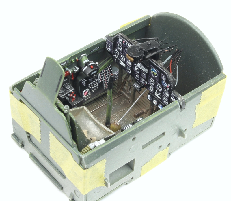

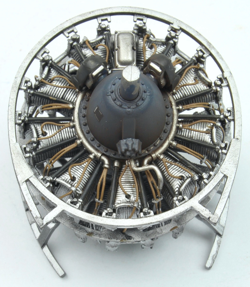

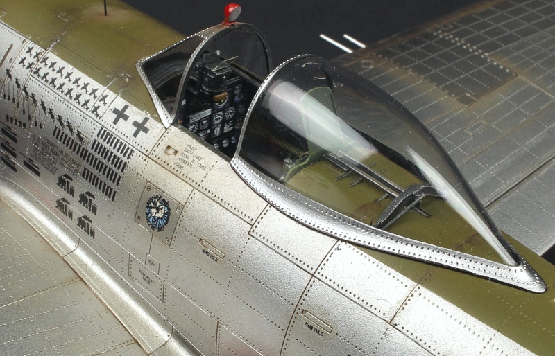

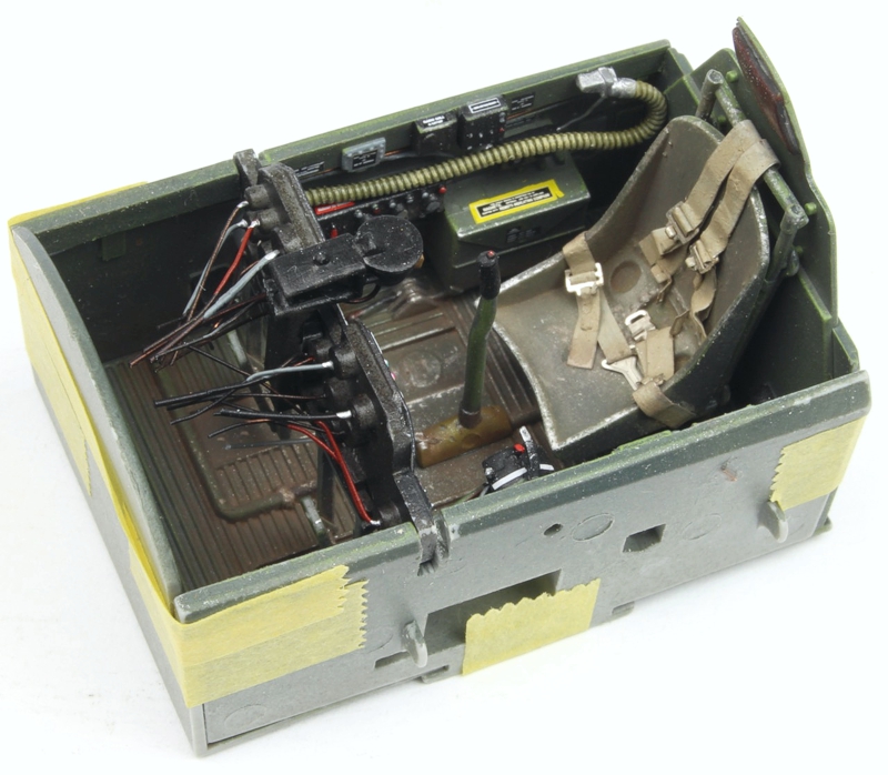

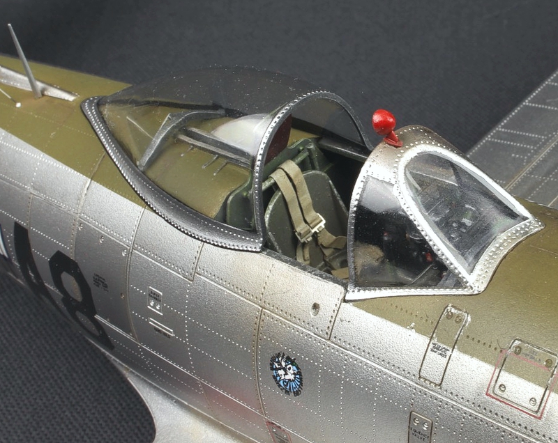

The kit was put together mostly straight from the box. I added the ignition harness and some other wiring to the big Pratt & Whitney radial engine and the landing gear received brake lines. In the cockpit I used the instruments from Kits-World and the buckles of the HGW Models safety belts. The belts were made from flattened lead strips. Some tubing, wiring and handles were added in the cockpit as well.
![](/articles/images/3666/3666-4.jpg)

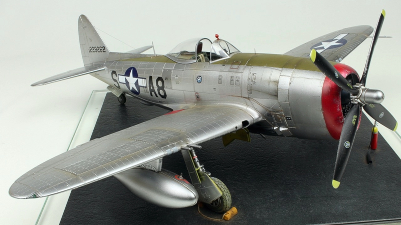

On the very simple base I added wheel chocks and a single fire extinguisher.
