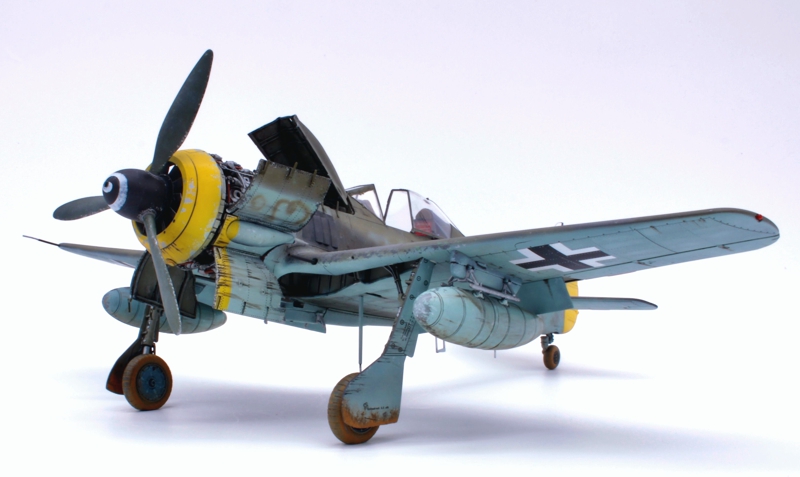

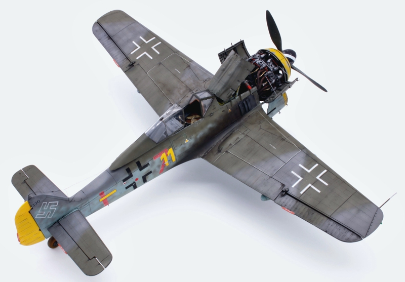

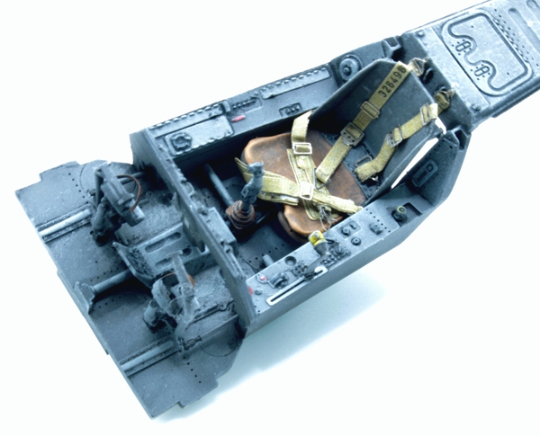

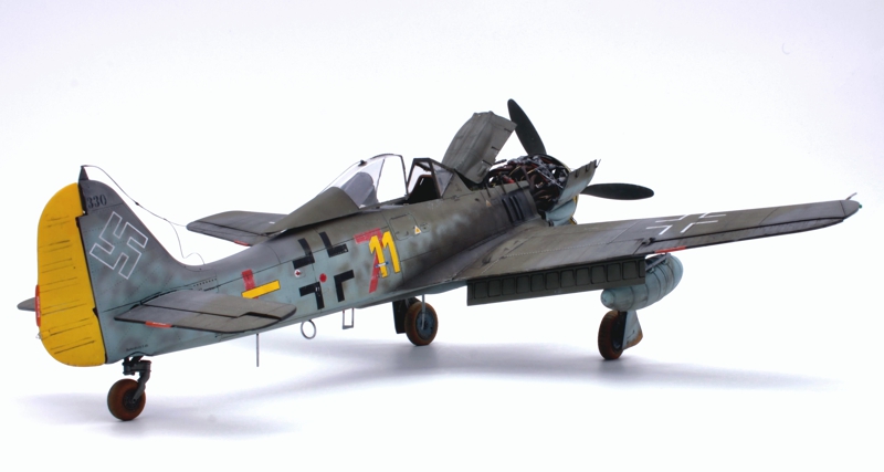

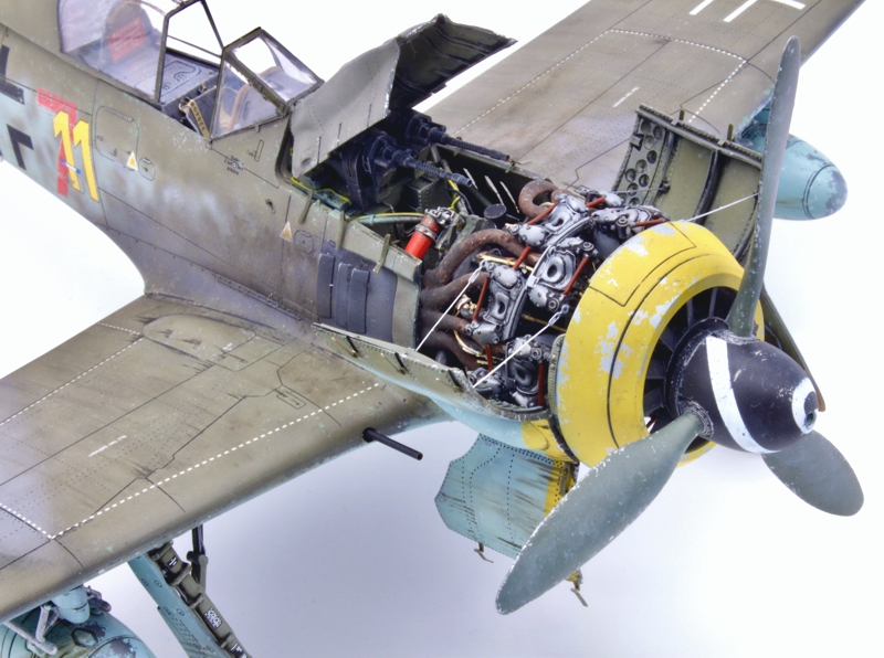

I would like to present to you my build of Revell's 1/32nd kit of the Fw 190 F8.
![](/articles/images/3677/3677-10.jpg)
This is probably the most challenging project I've done to date due to the number of aftermarket resin sets I added as well as the research I did on this particular aircraft. It was also my first attempt at fully riveting a model.

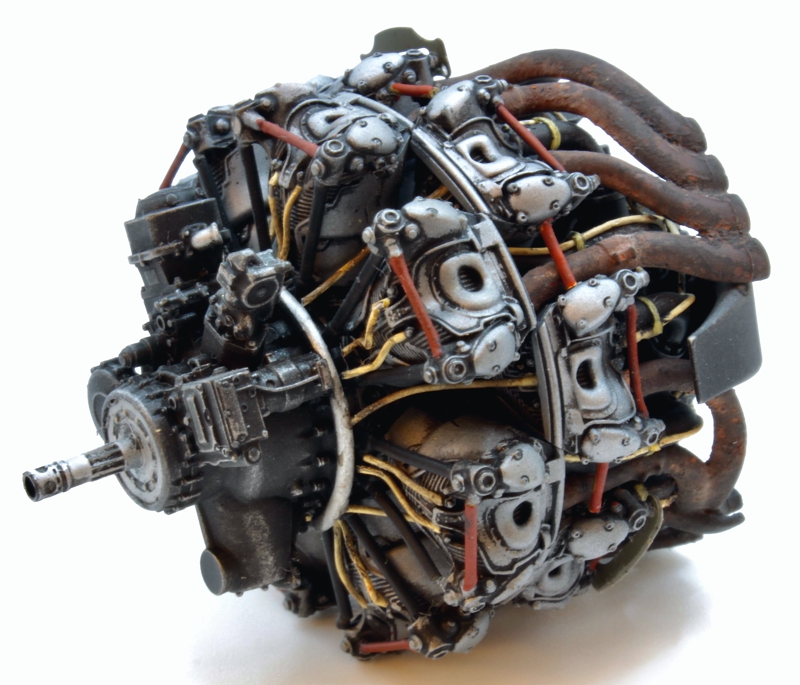

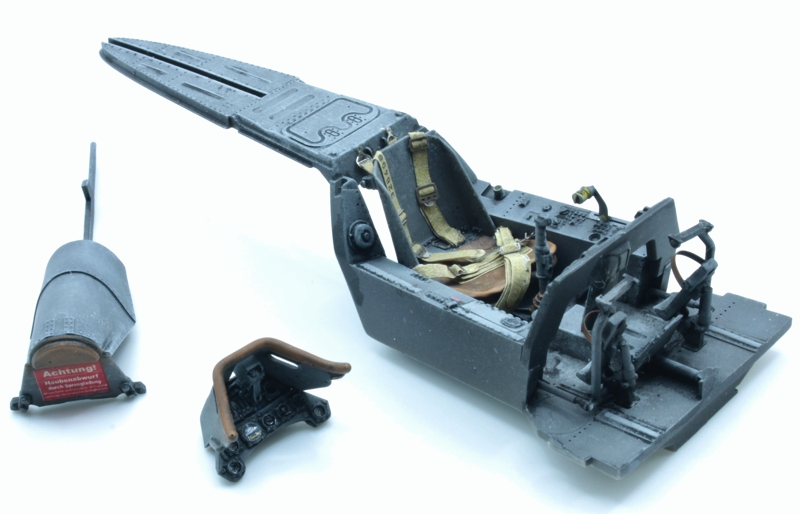

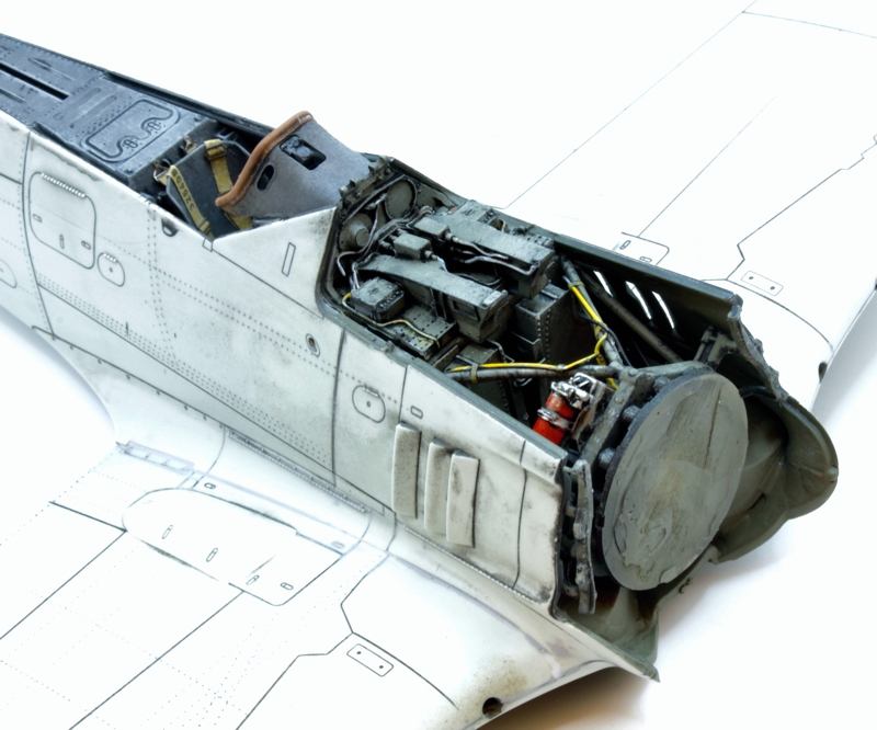

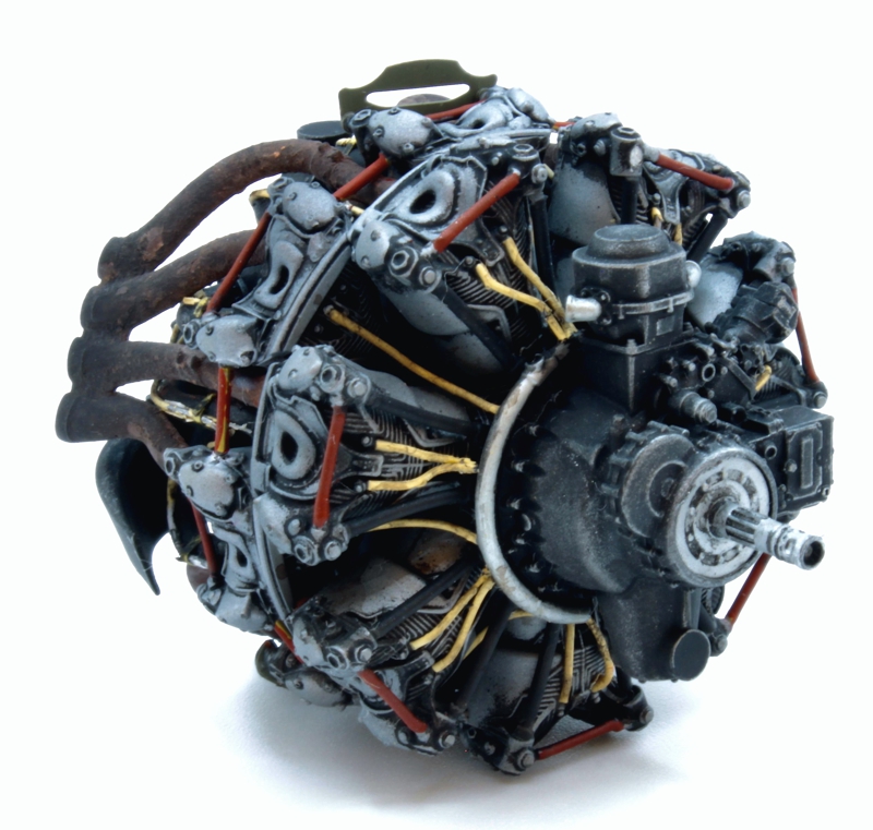

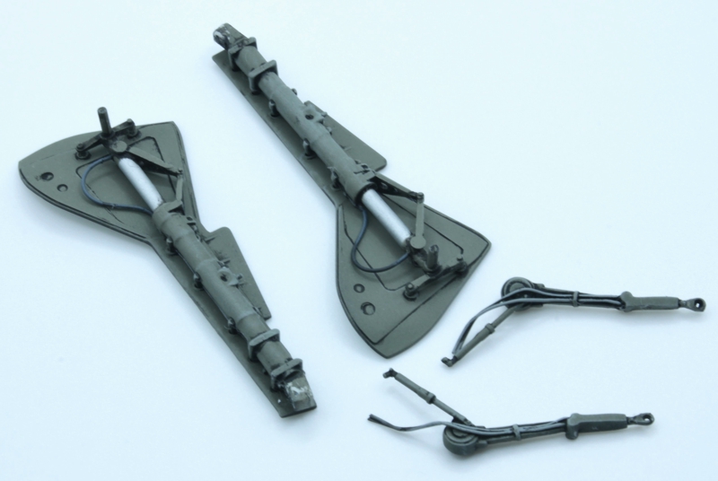

The aftermarket sets I used include Eduard's resin cockpit, engine, fuselage gun bay and propeller, ResKit wheels, HGW fabric seatbelts and a combination of Cutting Edge and EagleCal decals.

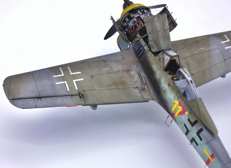

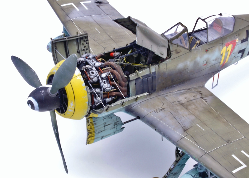

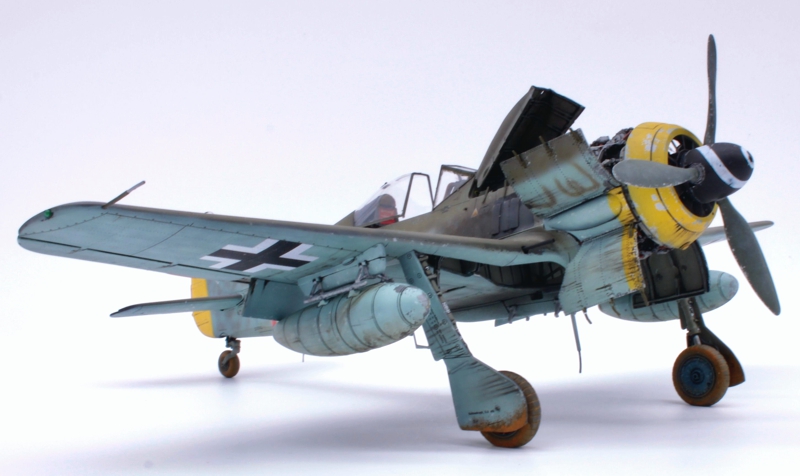

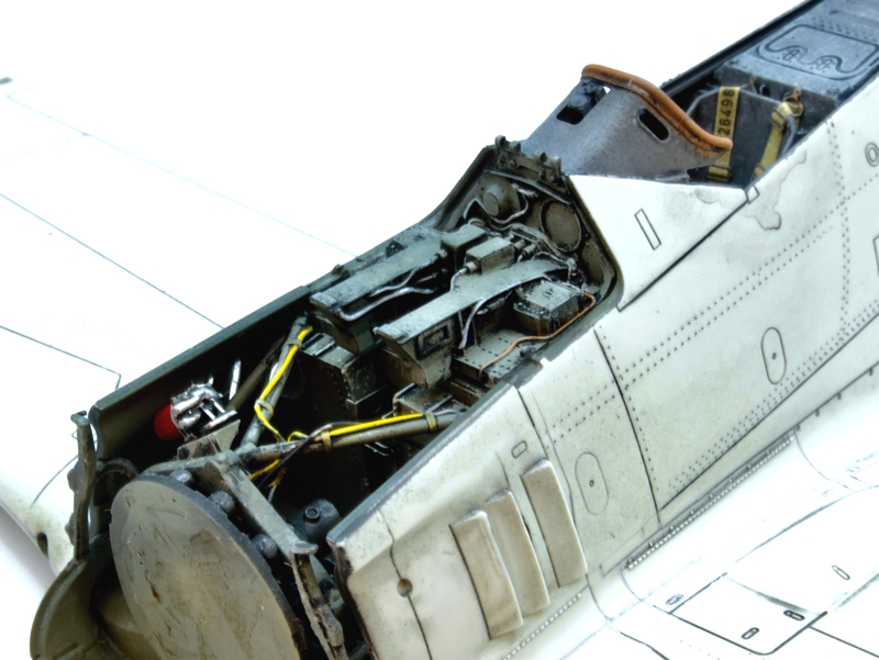

![](/articles/images/3677/3677-5.jpg)

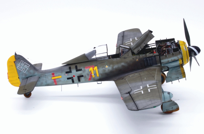

The Cutting Edge decal set was the one that inspired me to start this project as I found the overpainted fuselage number feature quite attractive. However, the painting instructions were simply wrong. Eventually, I discovered that Montex Masks offer the same scheme with the correct paint guide which I cross-referenced with pictures of the real aircraft I found online.

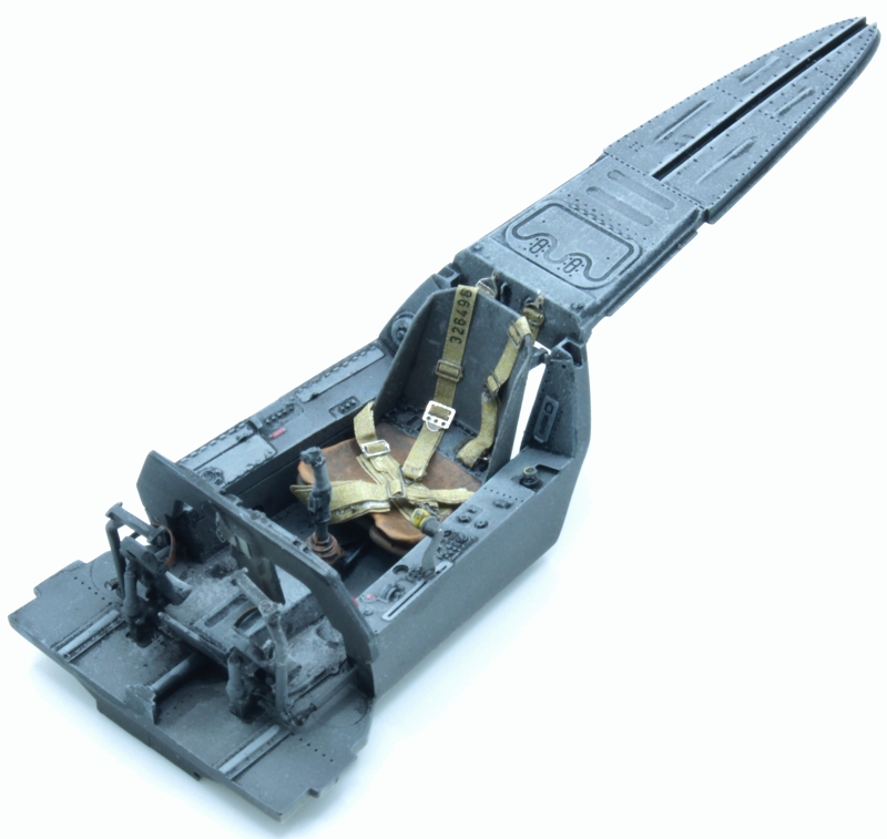

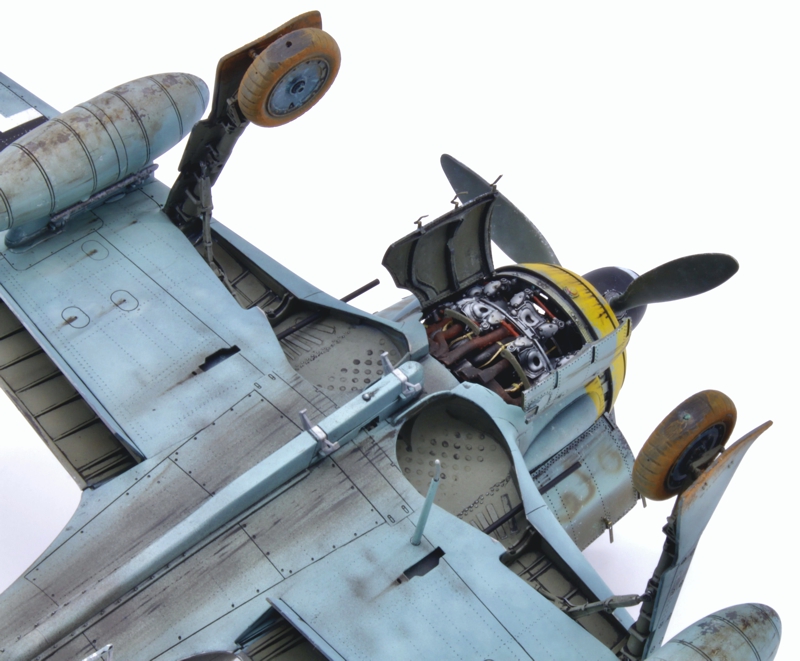

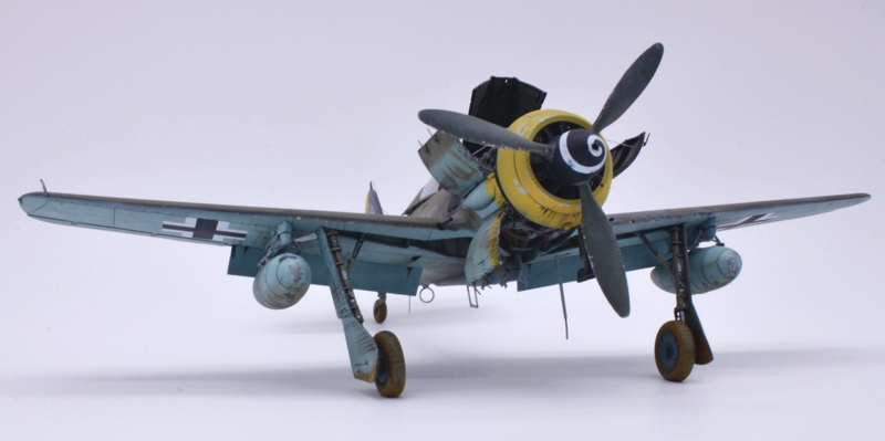

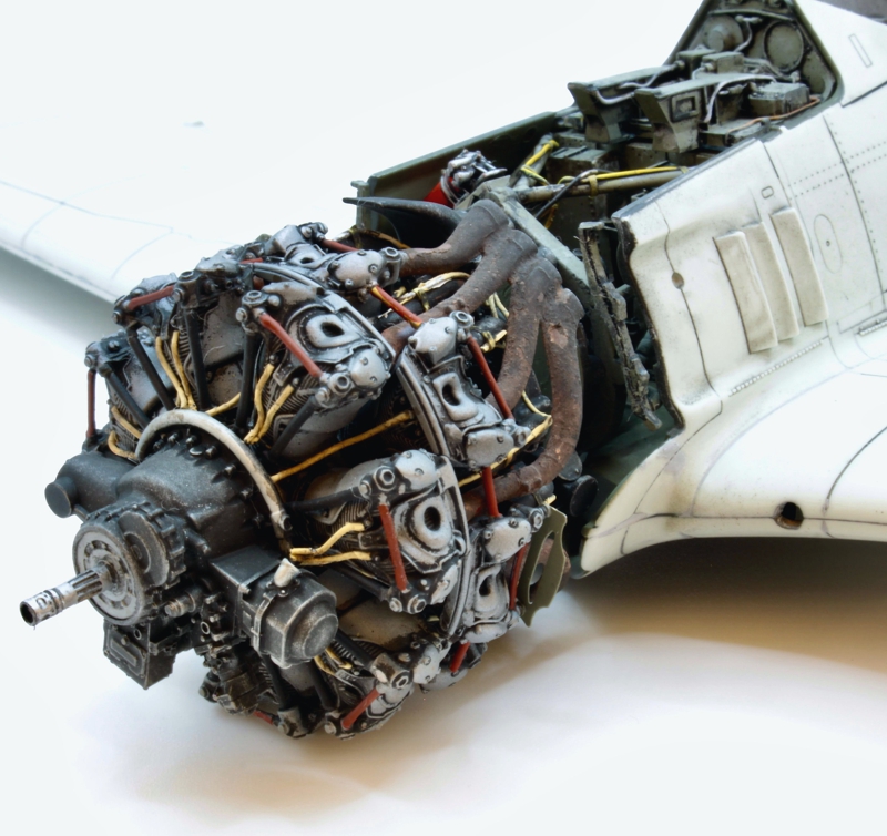

![](/articles/images/3677/3677-4.jpg)

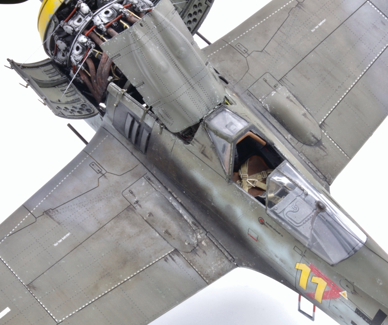

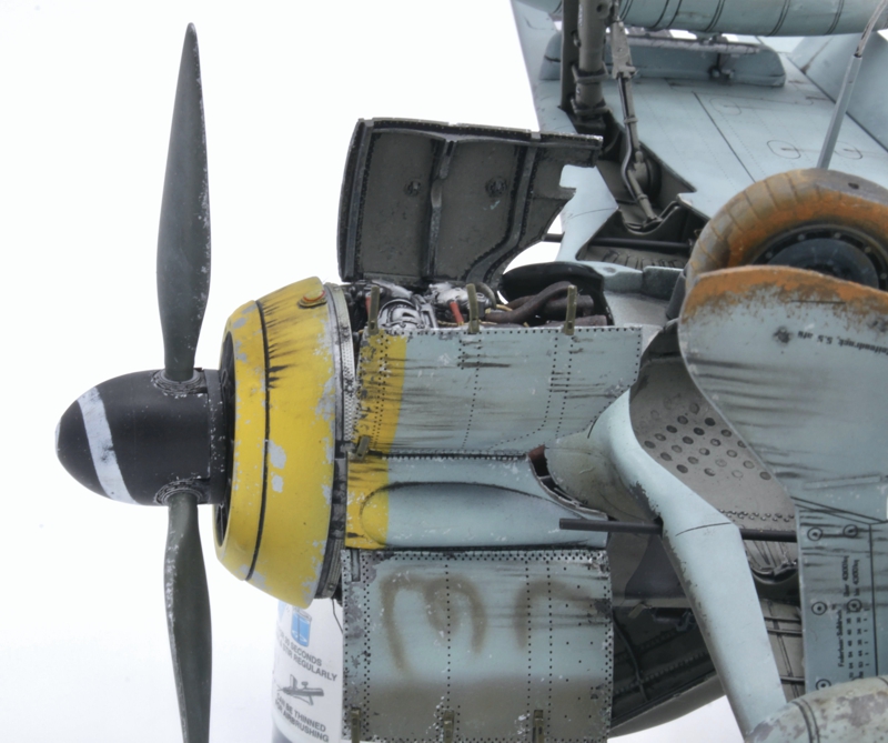

Painting was done almost exclusively with MRP paints and weathering with Abteilung 502 oils and MiG Ammo and AK Interactive pigments.
Hope you like it!
