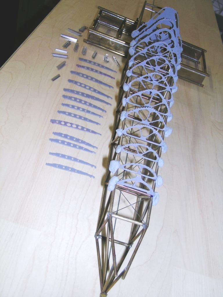

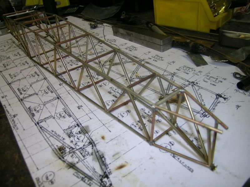

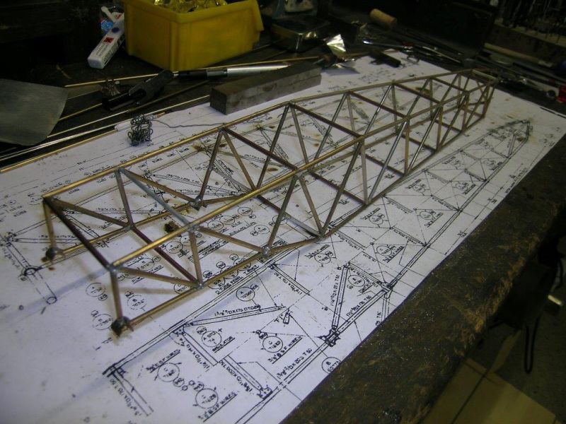

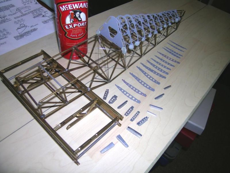

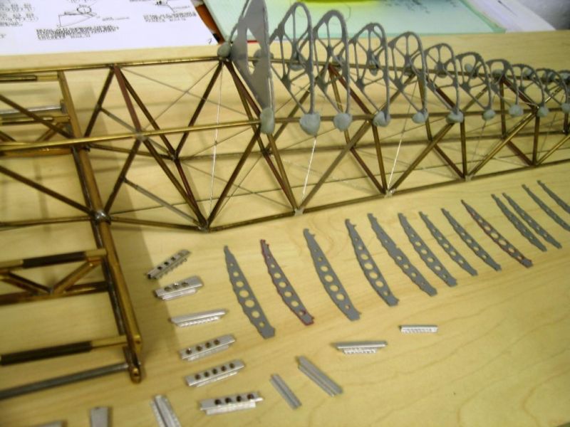

Fuselage structure with brass rods.

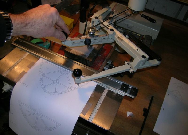

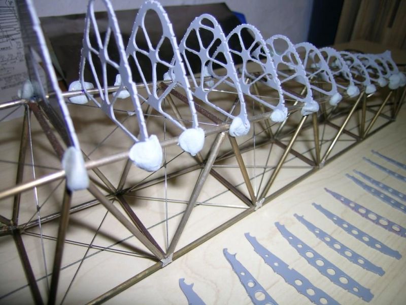

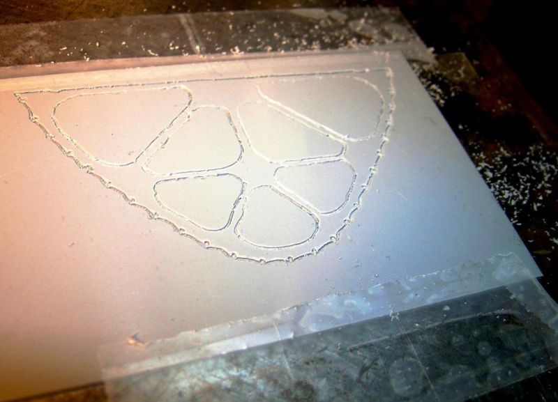

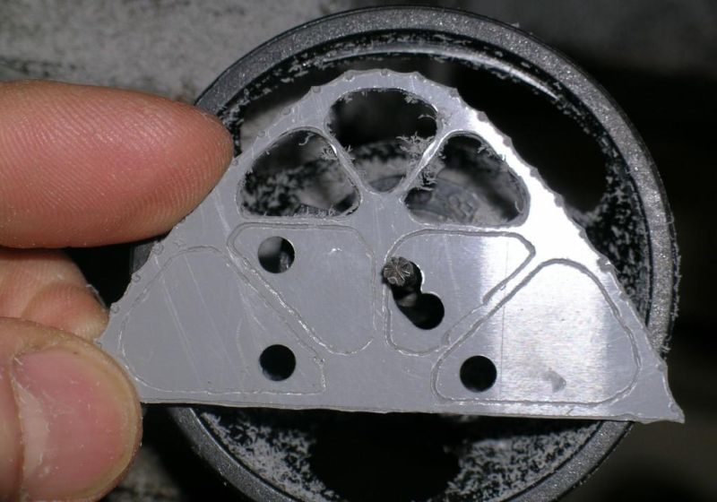

I was lucky to get an old pantograph. So I could transfer the formers to the plastic sheet from original drawings.
The time-consuming cut-out with a Dremel.
Upper formers provisional fitted with Plasticine. Just to find out how it looks!

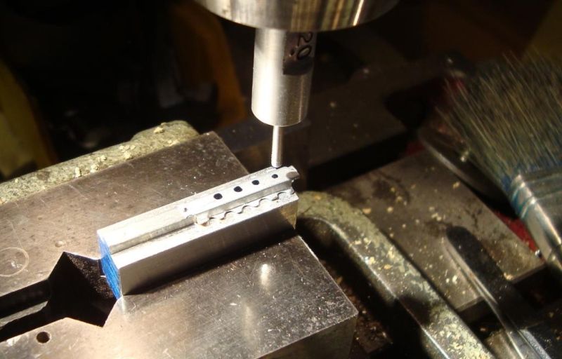

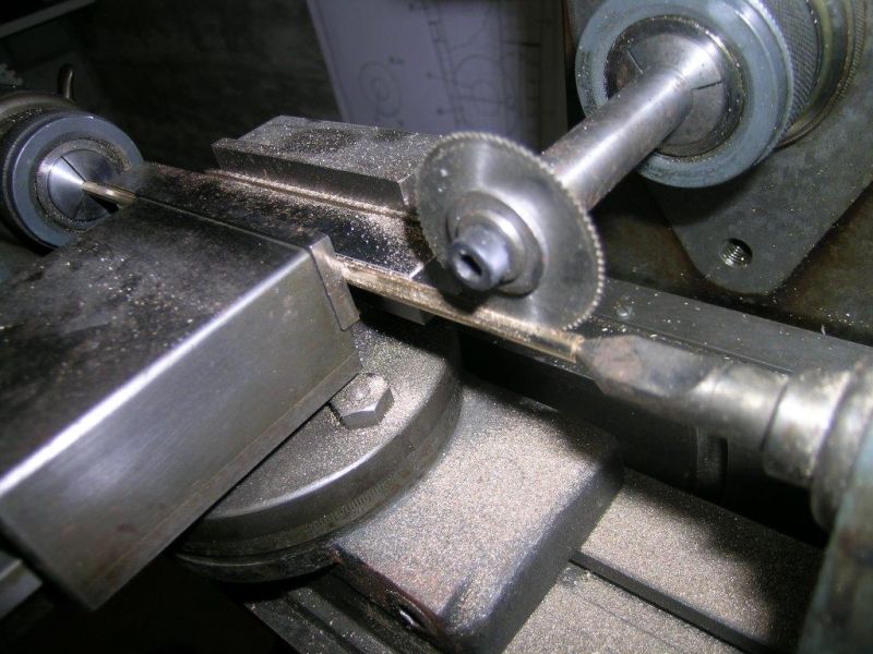

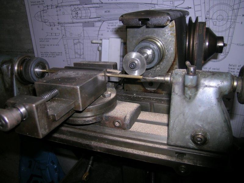

The next challenge: Center-Section! First milling the 12-sided main spars, then the 0.5mm slot with a side-milling cutter.

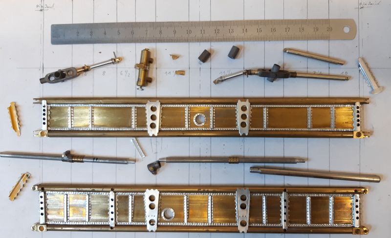

All parts temporary composed. Beer-can (empty! J..) as raw-material! Excellent suitable for stiffeners.

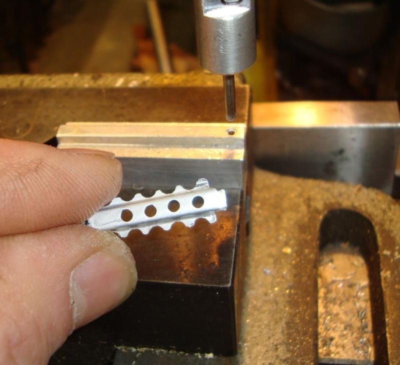

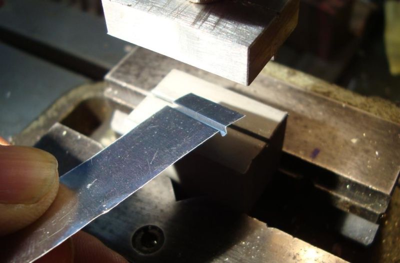

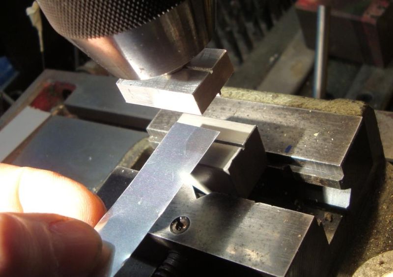

Made a deep-drawing stamp for all stiffeners & brackets. Punching out the holes with self-made dies.

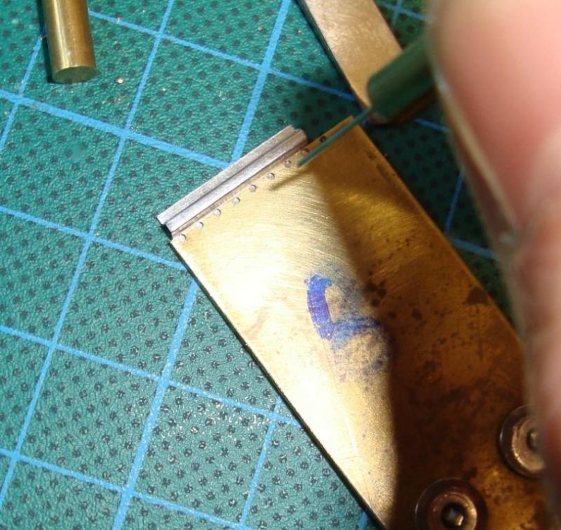

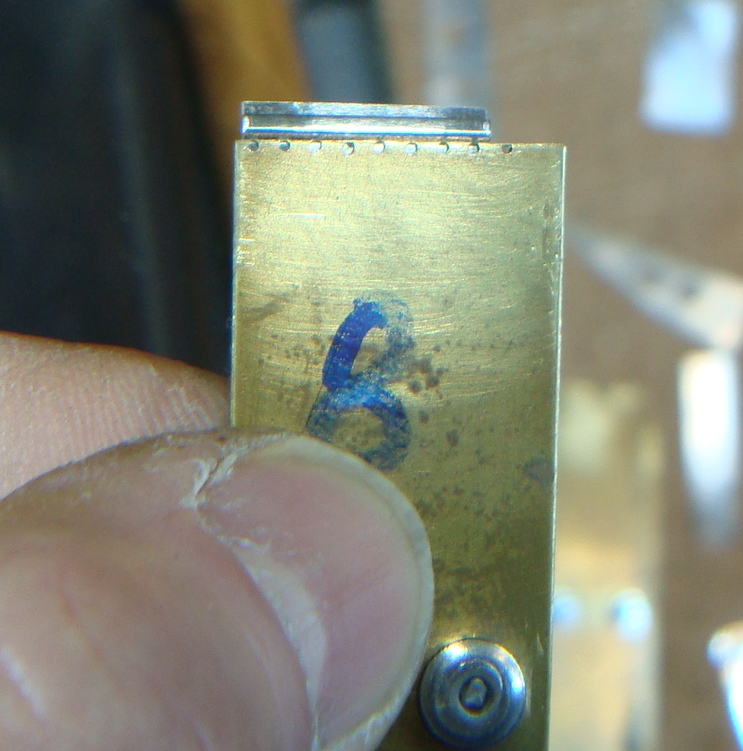

Two brass sheets riveted together as template for punching out the position of fasteners on the stiffeners.

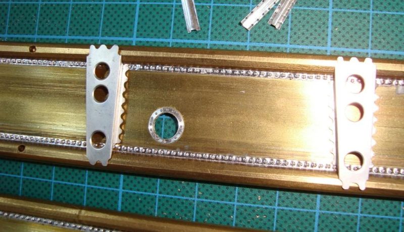

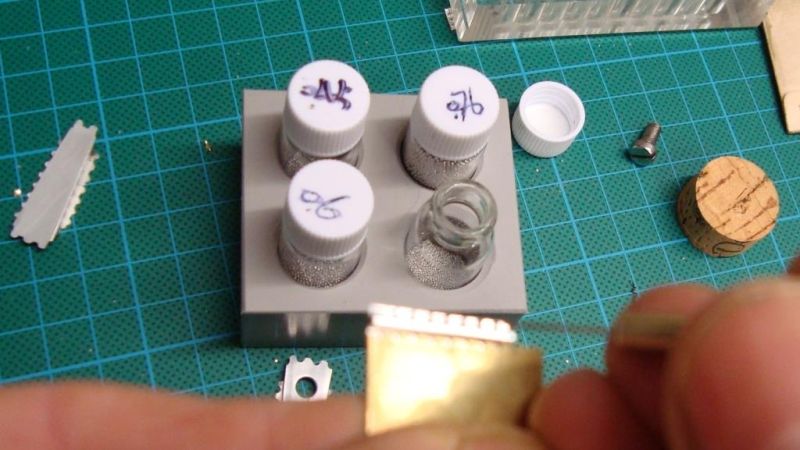

Wondered how to imitate rivets on the stiffeners: Found lead solder balls on eBay (available 0.2-0.75mm dia).

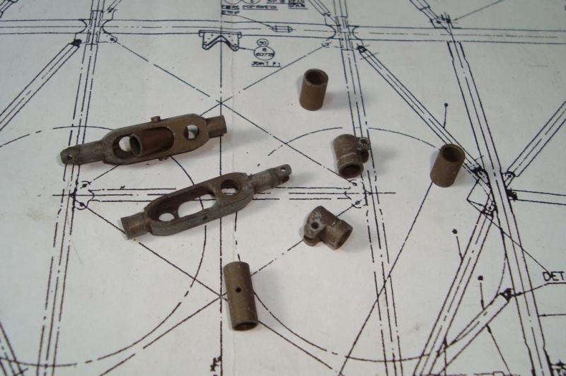

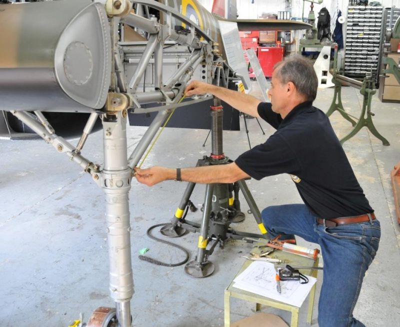

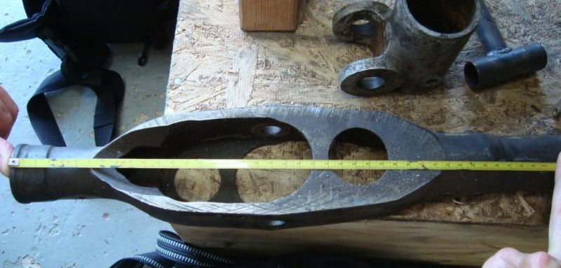

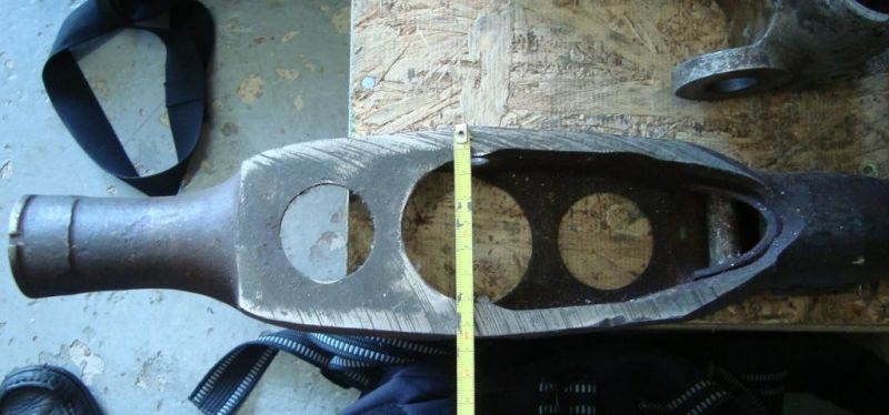

Lacking in drawings of trunion-sleeve I had the lucky opportunity to take measures on the occasion of a visit to Hawker Restorations. Thanks again H.R.!

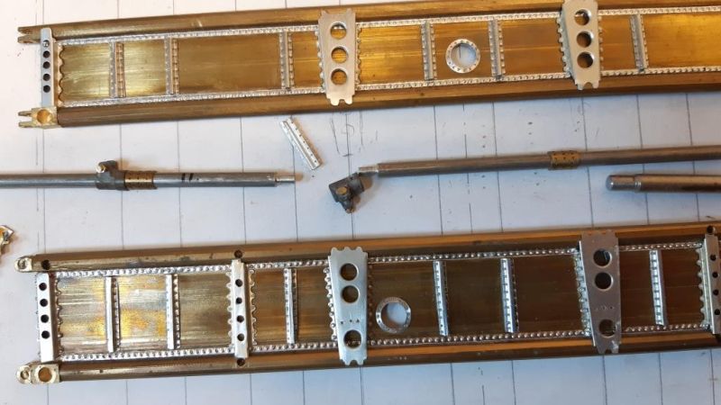

Made (very thin) flanges for cooling-duct from aluminum rod.
Both main spars almost finished. Made the smallest hex-heads from hex-shaped stretched sprue and thin slices. The bigger ones with the nutter of RP Toolz.
