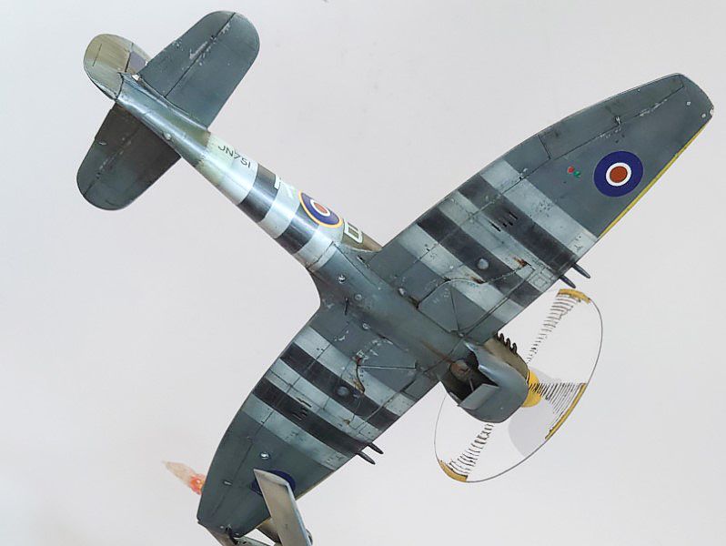

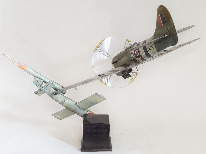

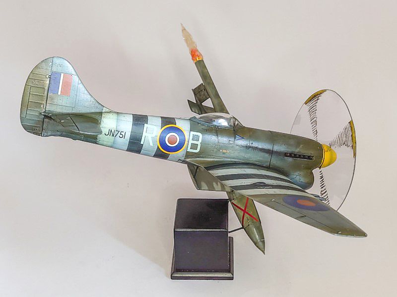

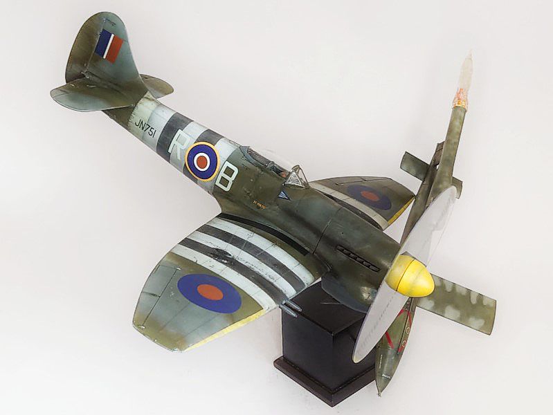

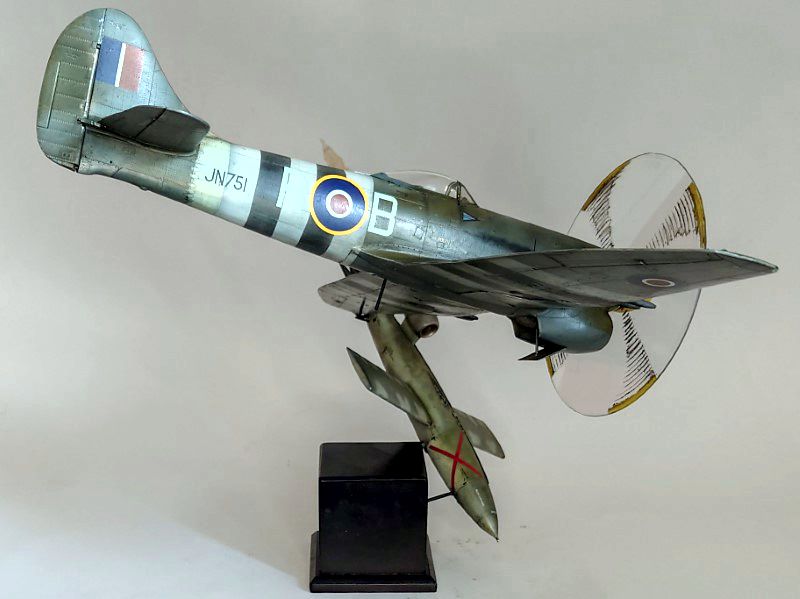

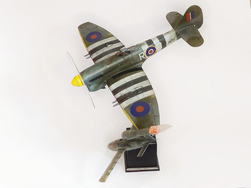

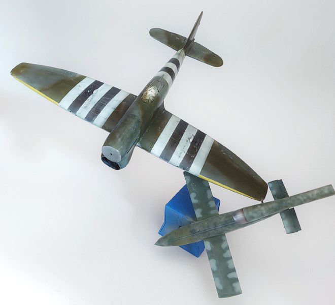

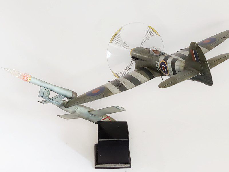

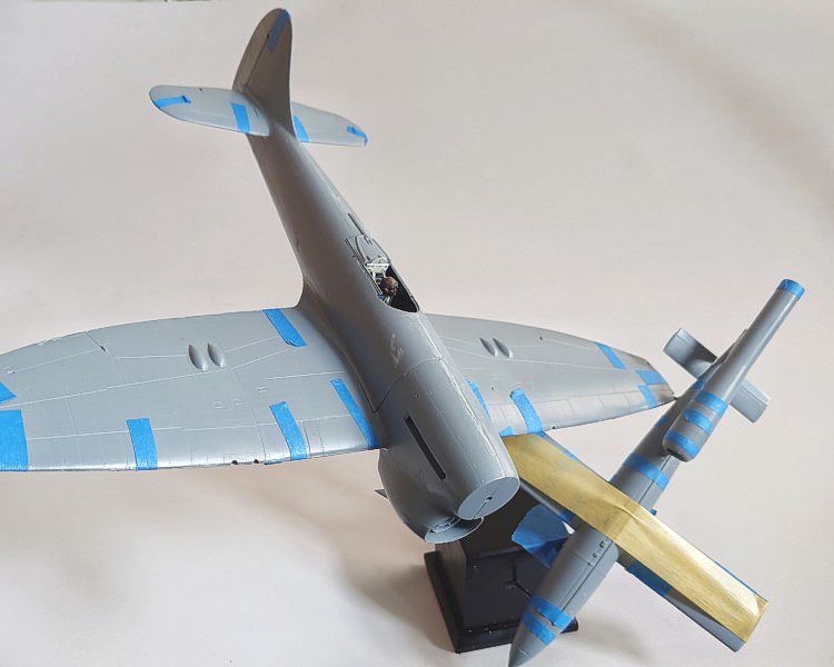

I wanted to do an in-action diorama with the Tempest tipping the Doodle bug into a spiral. This was successfully achieved in at least 16 V-1 intercepts. Many times, despite taking fire, V-1s could continue flying and when tipped could even fly upside down. Showing some battle damage would therefore illustrate this point of interest nicely. V-1's were often patched together from spares and so my depiction shows parts from at least 2 V1’s. I would need to somehow suspend the Tempest and V1 on a plinth and keep it from tipping over. This was done by running a coat hanger wire through the body of the V-1 and into the wing tip of the Tempest keeping the whole thing centered on the plinth.

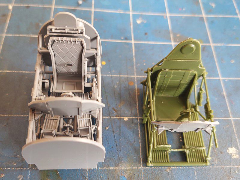

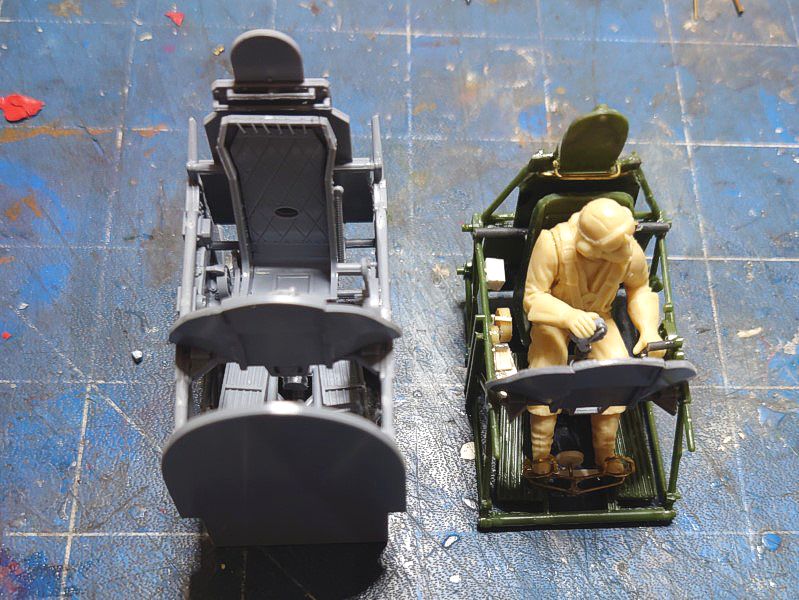

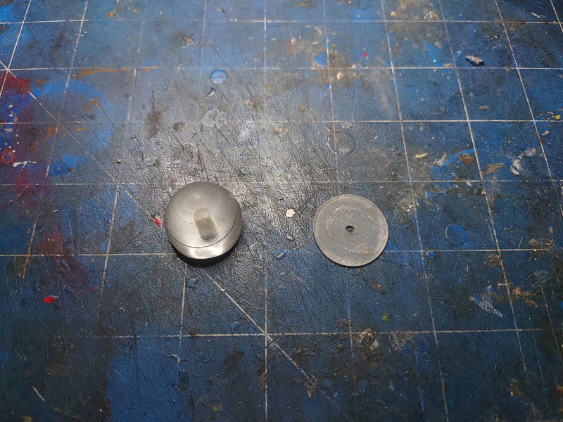

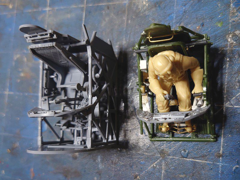

Revell’s rebox of the Special Hobby Tempest adds a nice instruction sheet but otherwise there’s nothing special here. The kit is typical of low run models. Poorly fitting, thick plastic, butt joints, parts don’t line up, etc. Still, the main parts are all there and it builds into an impressive kit. I felt it was going to be a pity to use all the wonderful cockpit detail in this model as it would mostly be hidden so I elected instead to save the cockpit for a future Revell Typhoon superdetail project. I therefor heavily converted the Revell Typhoon cockpit and superdetailed it within reason to fit this cockpit. The figure is from PJ productions. The spinner is a piece of turned acrylic which was a poor choice because it melts easily.

This was a really easy build with the hardest bit being the conversion to a stand for the Tempest. This was done by cementing a coat hangar wire into the core of the V1. The rocket plume is a core of acrylic rod with hot glue modelled over it.
Base
The base is a solid pre-fabricated base from High Planes Models. Apart from the wire in the core suspending the Tempest, another wire in the nose of the V1 prevents the assembly form tipping over.

Beamont was a careful pilot who understood the capabilities of the aircraft he flew. He was proud that he had never broken an aircraft, nor had to bail out or eject. Even when his Tempest was shot down, he had made the best landing possible in the circumstances and got out, free of injury. The models were painted with Humbrol Enamel, with specific RLM colours for the V1 bomb. I used oil washes for weathering and drop filters for colour variation. The worn silver was a combination of undercoating with silvers and masked with sand. I find this the best way to achieve realistic chipped paint with enamels (salt rusts the pigment and hairspray can’t be used). I used AK true metal for touch-ups afterwards and I think it solves a major gap in metal paints as you can patch over mistakes without having to airbrush large panels. The invasion stripes were all hand painted in enamels. D-Day stripes were painted above and below in June 1944. By the end of June the top surfaces were painted over and by September they were removed. I wanted to show this early Tempest with the stubby Hispano guns and so chose the appropriate colors for a V1 that was launched out of France a week after D-Day from France. I’m not sure if this exact engagement actually took place.
