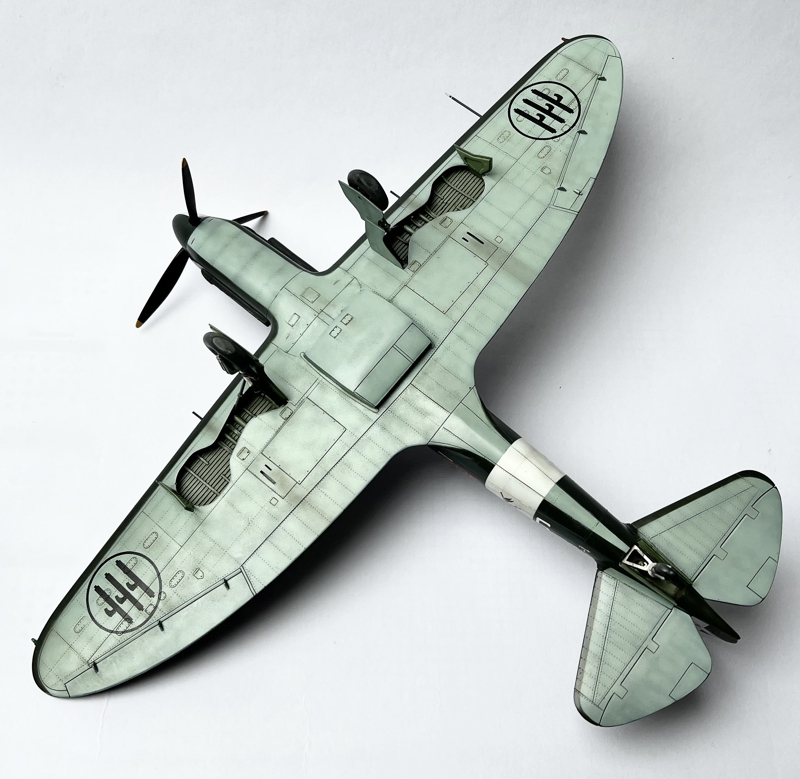

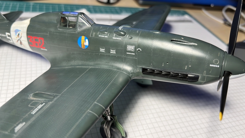

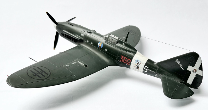

This is my Reggiane Re2005 Sagittario, Regia Aeronautica, 362a Squadriglia 22° Gruppo, Sicily, July 1943.

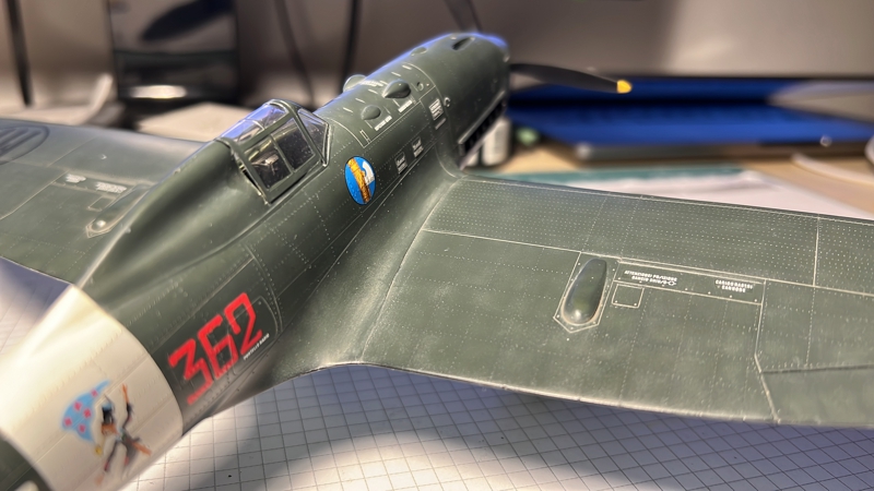

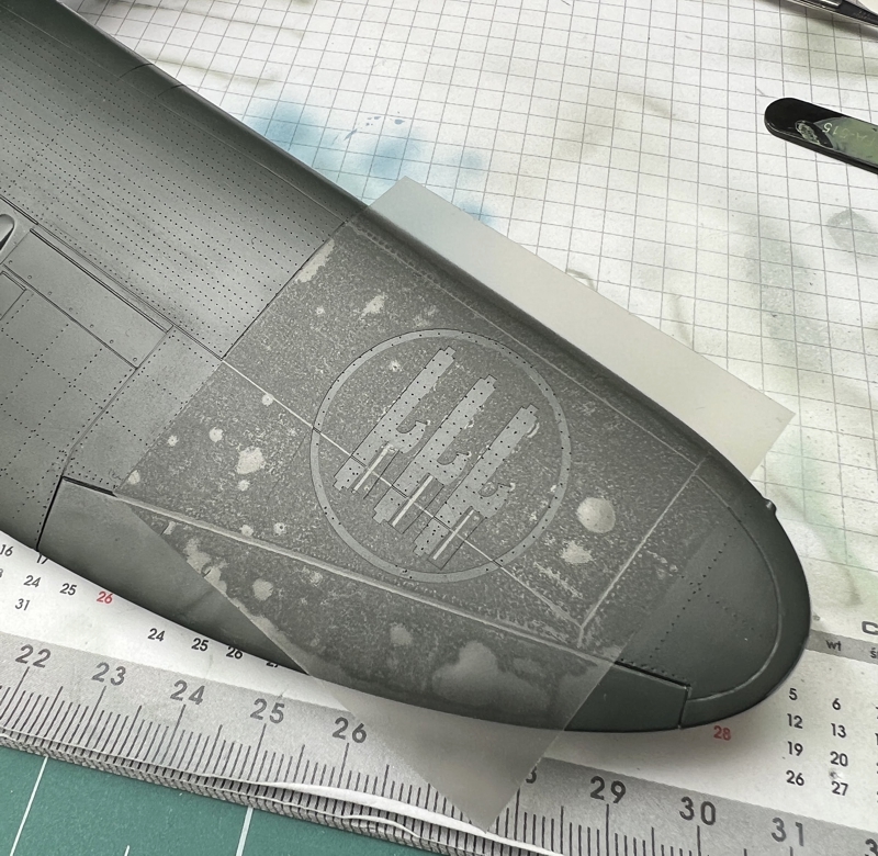

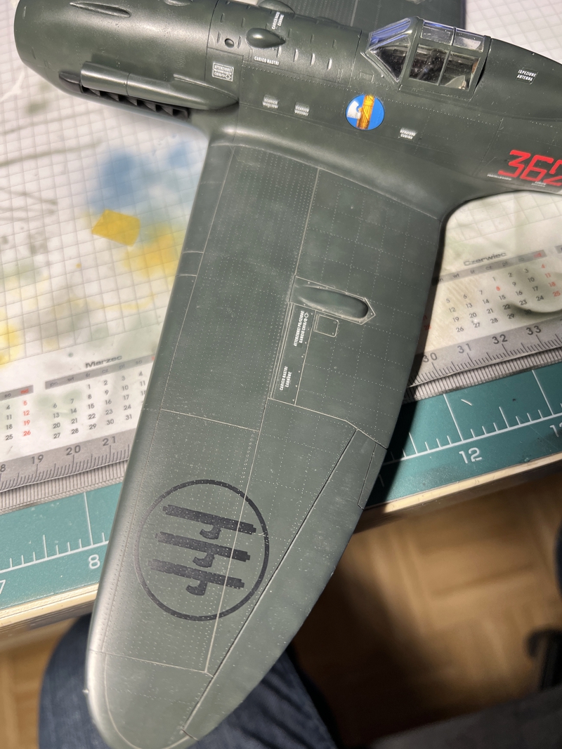

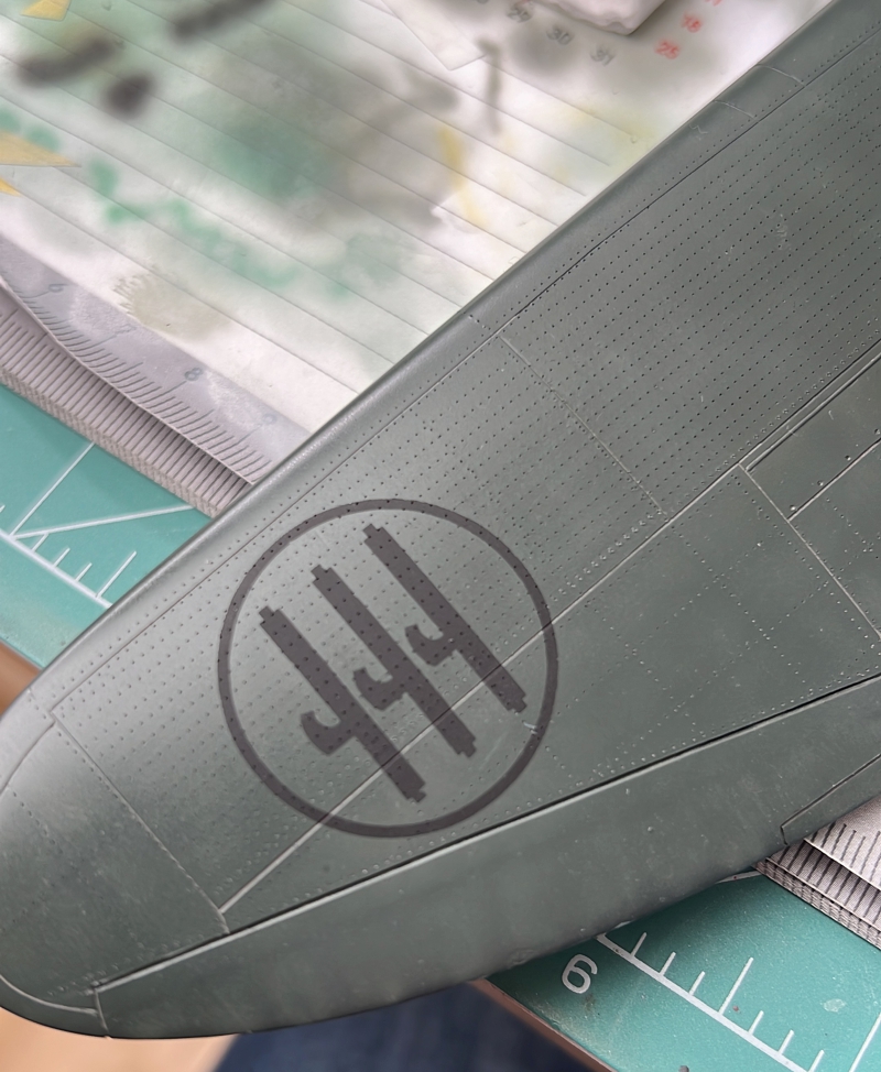

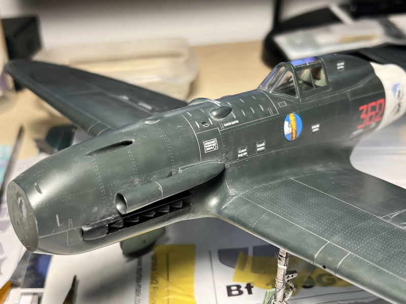

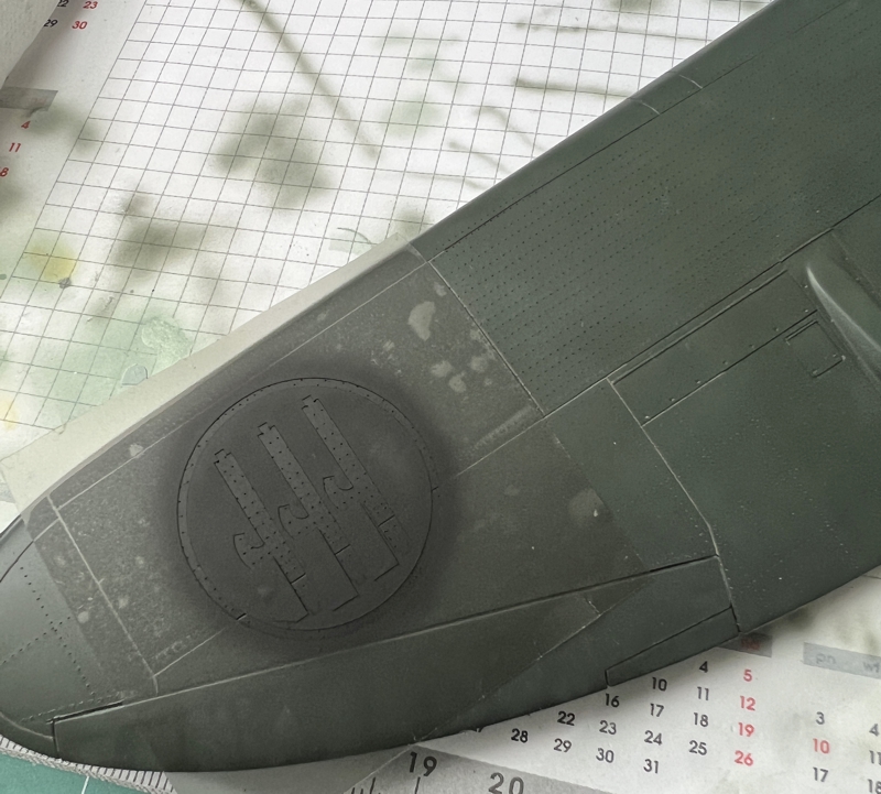

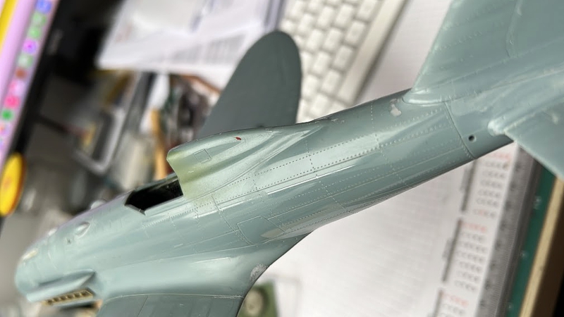

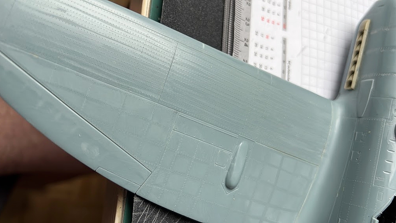

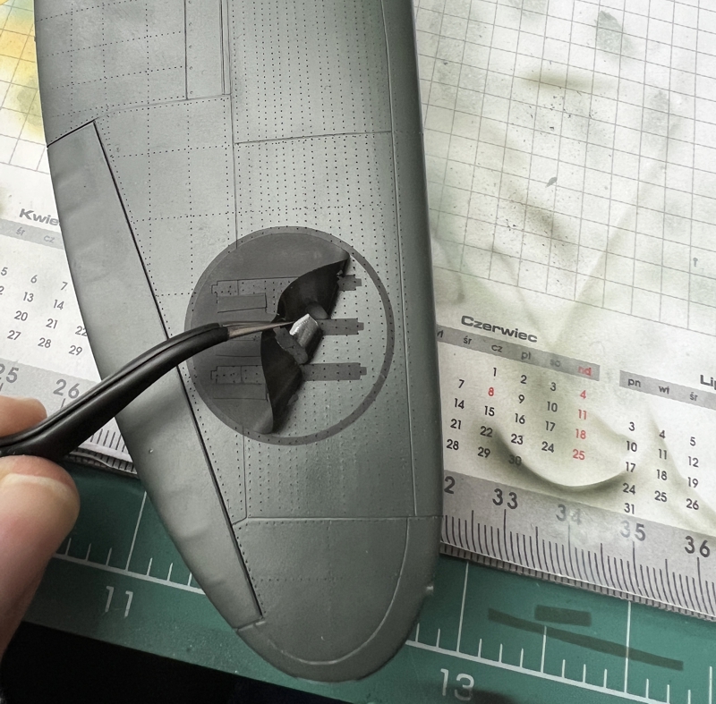

The wing trailing edges are quite thick and require some sanding. The propeller spinner also needed adjustments - the holes for the propeller blades were far too large. The shape of it should also be improved - but I decided to accept it. The entire model was riveted - thousands of "rivets" - especially on the wings. In fact, it turned out to be much easier than I thought. A certain challenge was to make negative rivets on the wings and positive rivets on the fuselage. The solution is ridiculously simple - traces of riveting on the wings should be treated with very fine sandpaper and "painted" gently with Tamiya extra thin cement to clean them. Rivets on the fuselage - well... I just left them as they were after using Rosie the Riveter. I assumed that airbrushing them with Mr. Surfacer 1500 will give a good final result. And it worked. A very simple and efficient method. Otherwise, an entirely out of the box build with good result.

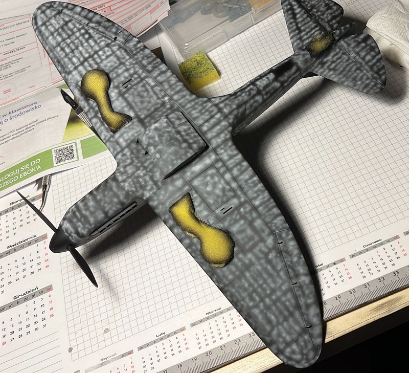

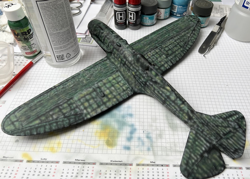

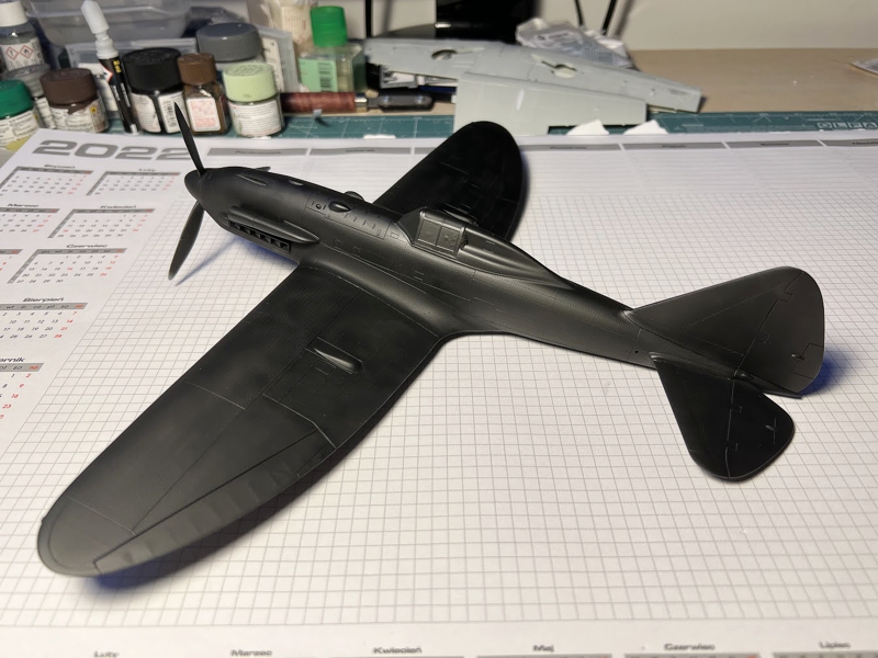

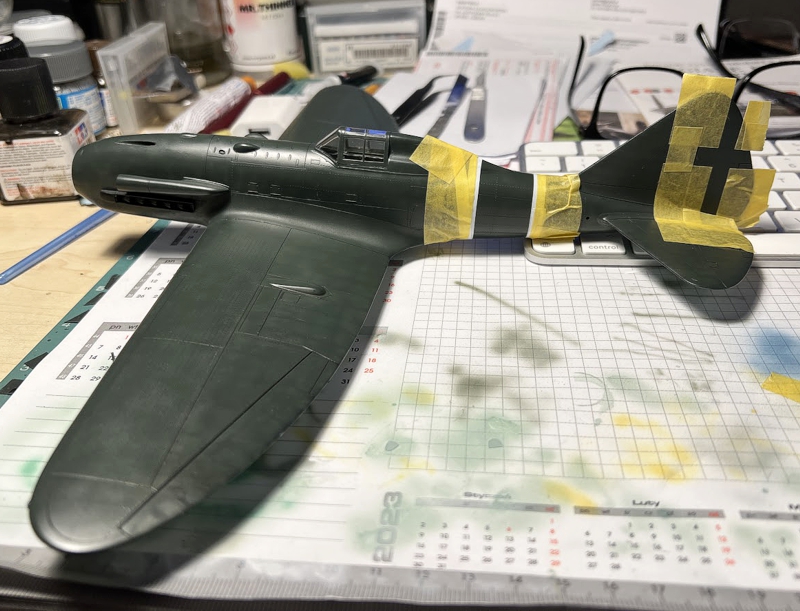

For the first time, I used black basing - I think the method is great. Uniform camouflage is always difficult - but here I managed to build subtle differences in shades, colors and depth. The model was painted entirely with MRP paints with partial use of Montex masks.
