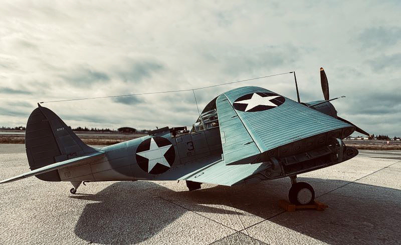

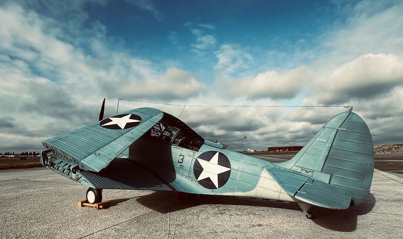

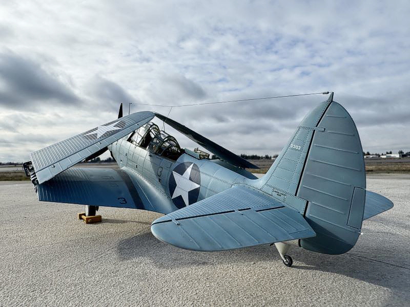

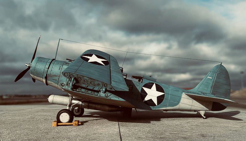

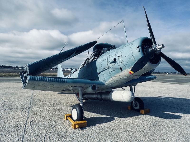

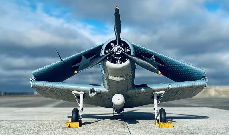

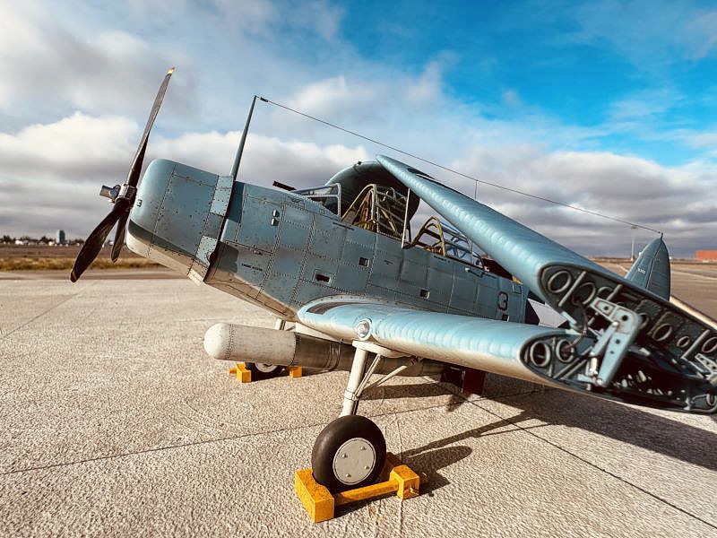

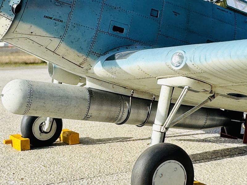

This is the Trumpeter 1/32 TBD-1 Devastator from VT-3 USS Yorktown on June 4th, 1942, Midway.

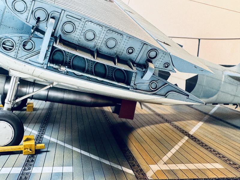

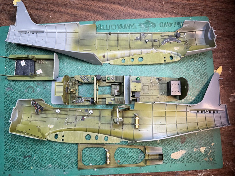

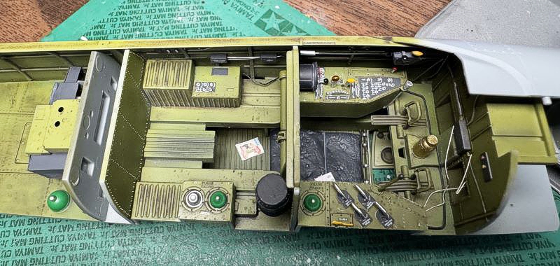

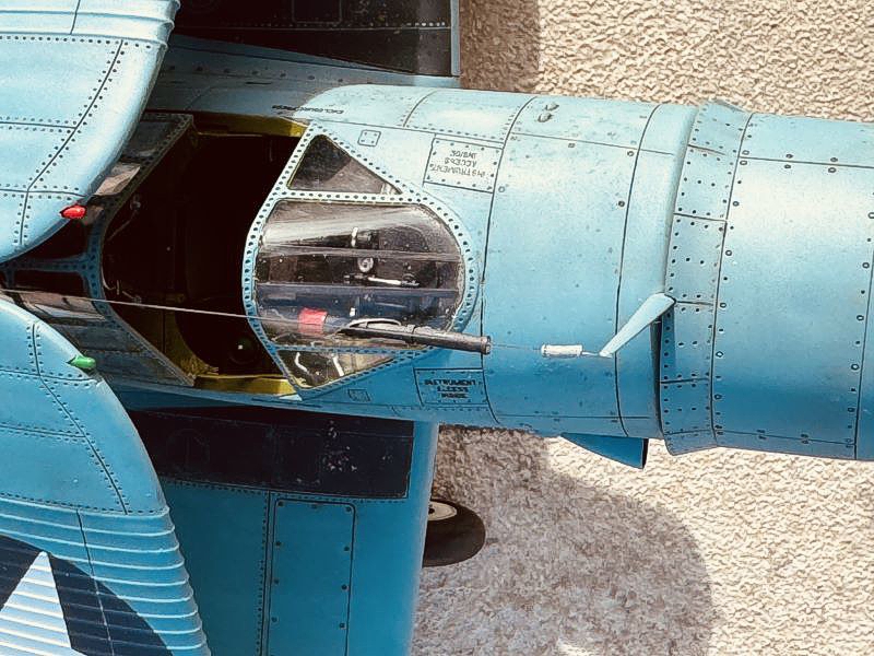

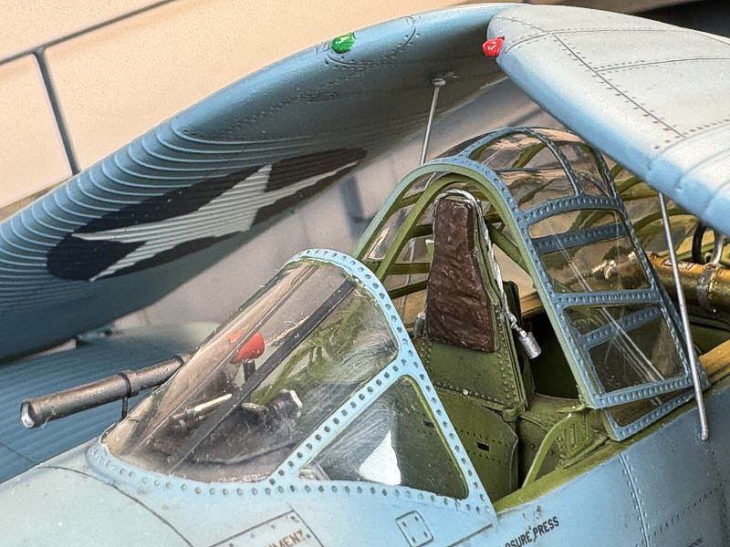

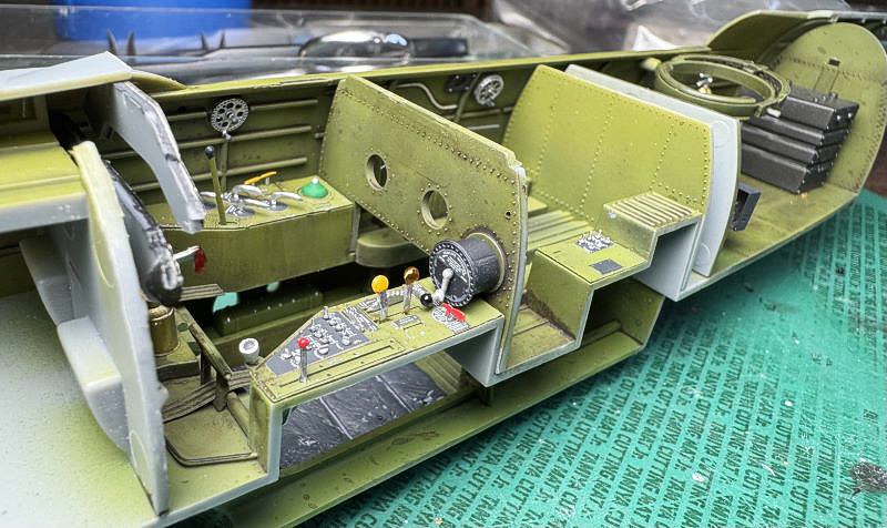

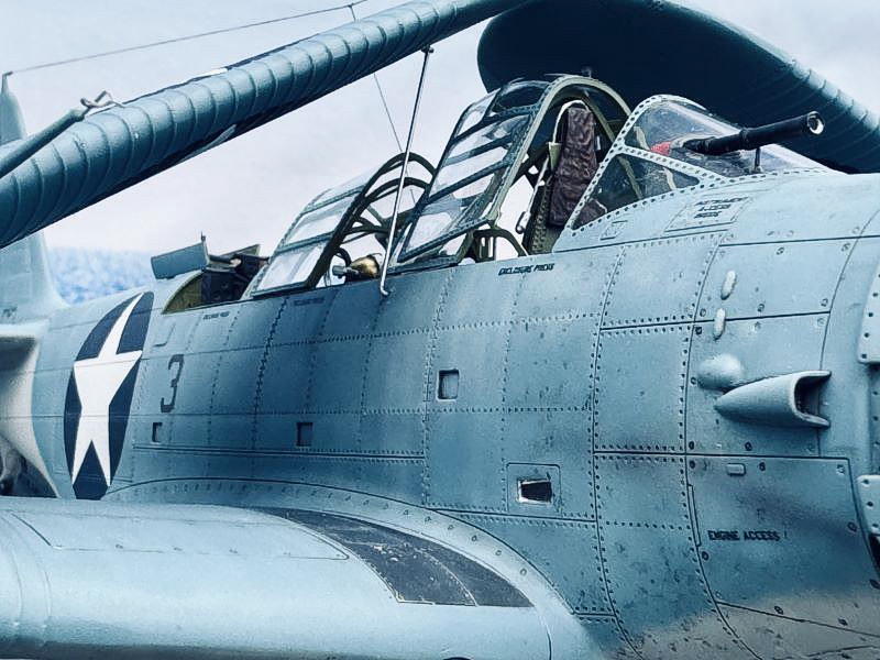

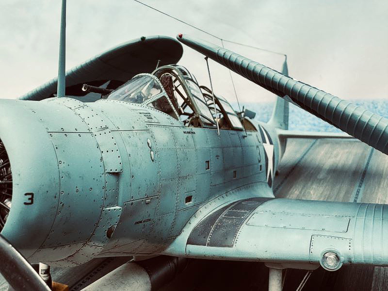

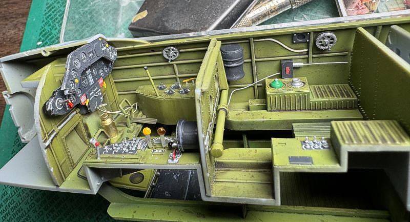

I added Air Scale products such as the Photo Etch, propeller set, wheels and the single .30cal machine gun. I highly recommend their products. I also did bits of scratch building such as adding cockpit wiring, relief tube, two internal windscreen braces (removed the molded on external windscreen braces), wingfold braces and leather pad for the bombardier under the pilots area.

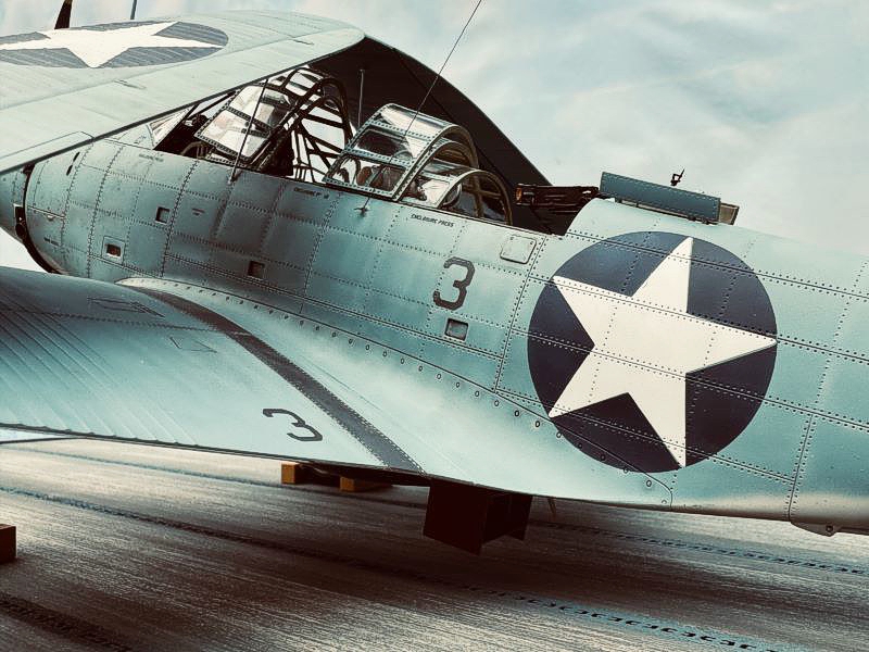

I used AK real color for the light grey bottom, Model master Blue/grey for the top and AK for the interior green for the crew areas. I have seen some debate on-line about this, what color? But for me it was decided upon seeing the pics of sunken TBD’s aircraft from the discovery of the USS Lexington at the battle of Coral Sea. Interior green is also stated in TBD’s Devastators in action book(The Old One).
Another debate is whether what squadrons carried the twin .30’s. It is very obvious that VT-8 for sure had them and I have seen some documentation that VT-6 (USS Enterprise) may have also had them. After many hours of research, I came to the conclusion that VT-3 only had the single .30. I came to this by listening to several recorded interviews with Mr. Lloyd Childers. And in the end, there is just no conclusive proof they carried the twins.

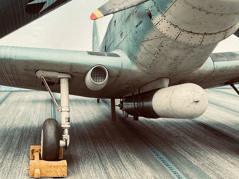

I used Hawaiian Air Depot masks for the A/C numbers and the insignias. I had previously bought the Gold Medal decals but figured painting over the corrugation would be far easier then decals. But I am glad I purchased it because they come with aircraft data. If anyone has seen what Trumpeter did with their data decals…well.

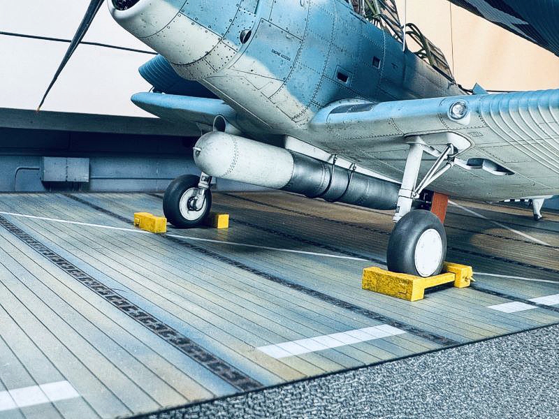

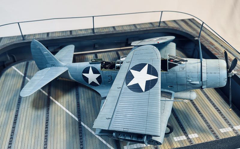

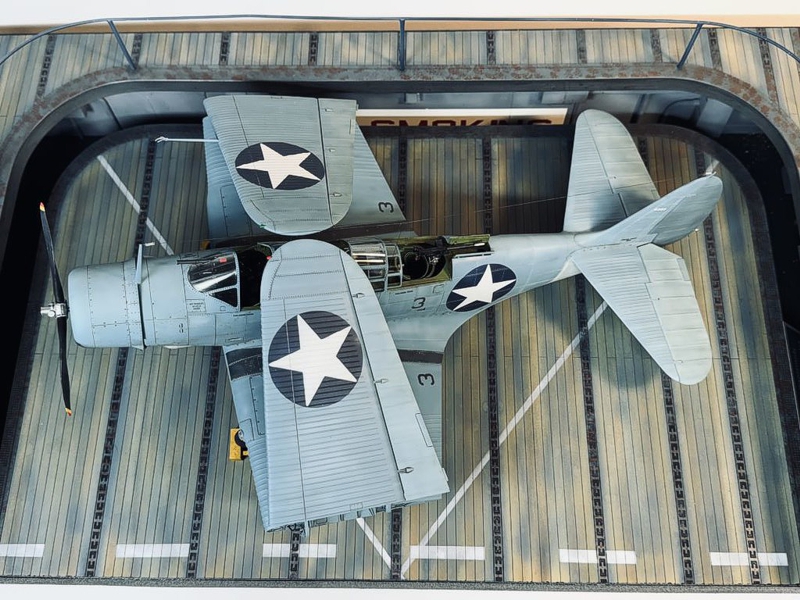

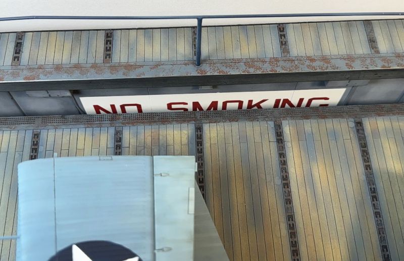

I added the indoor pics of the TBD on the carrier elevator base which I won at a contest with this build. I always wanted to model a TBD on an elevator. The base was designed by Tony Quartaro.
