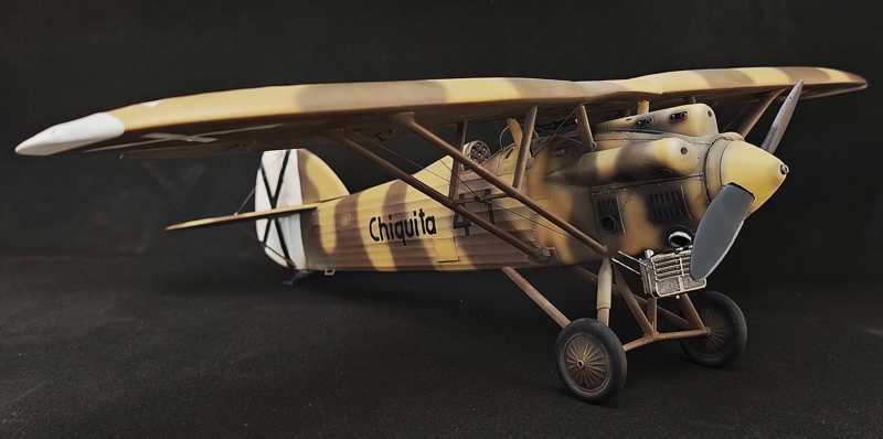

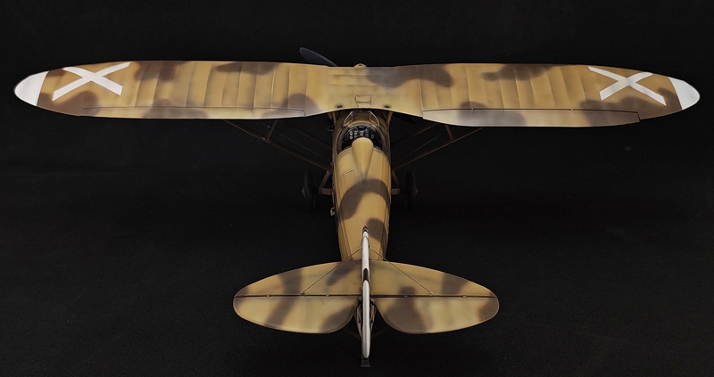

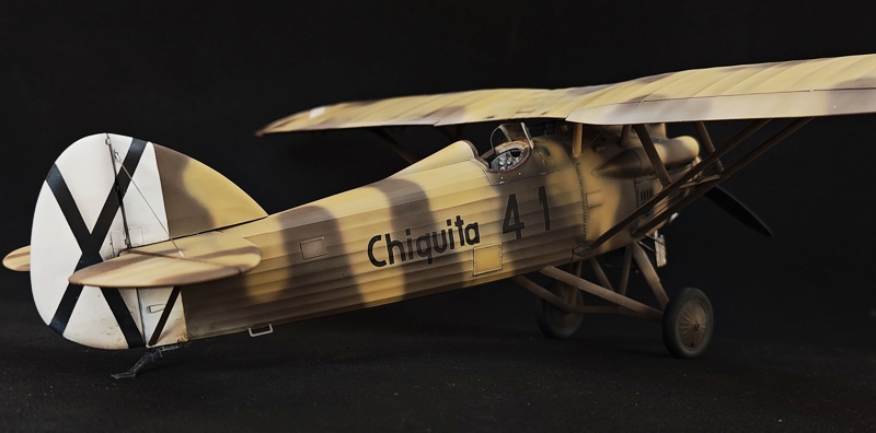

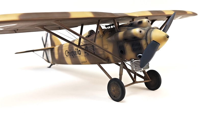

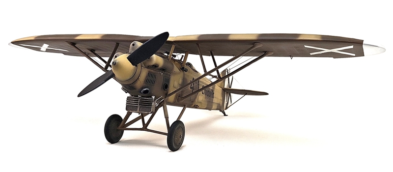

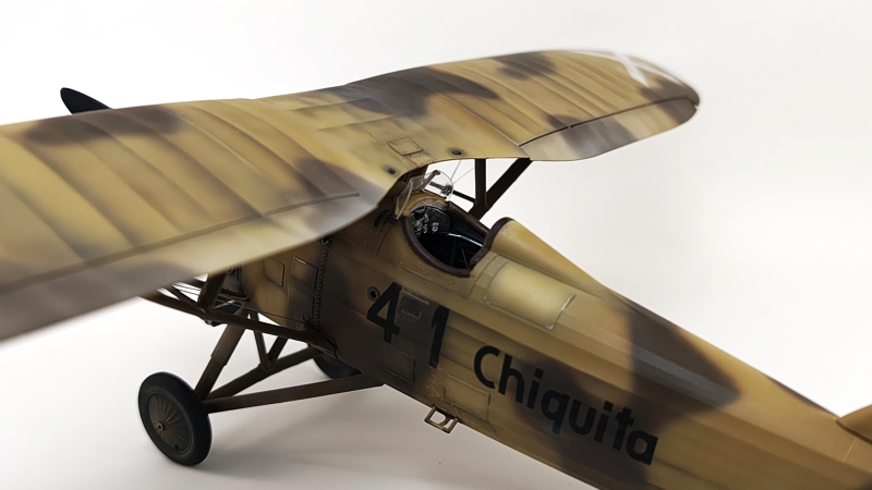

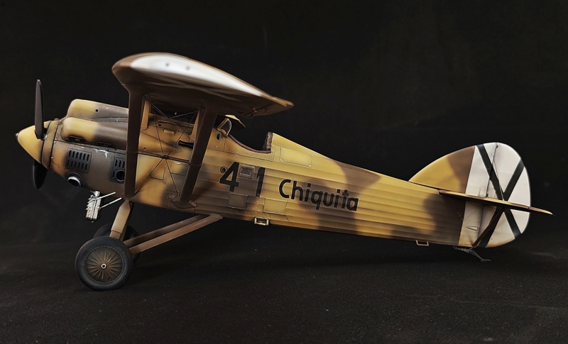

Here is my first finished 3D-printed kit. This was the first Polish-produced fighter. Twenty were sold to Spain in 1937, where it was mainly used for training purposes.

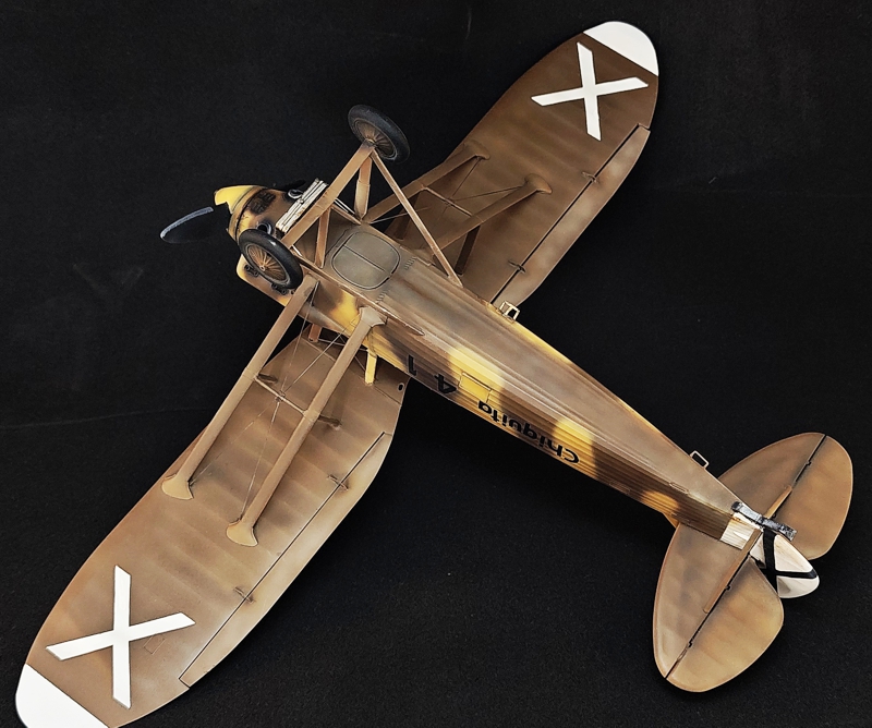

I recommend it only for experienced modellers. It has some moments in which patience is needed. You need to have a good mini drill; I used it for drilling holes for all steel rods. The elevators need some reinforcement before gluing it to the horizontal stabilizer (I made hole and placed a needle there). The stabilizer also needs some adjustment when fitting to fuselage. Struts in the top of fuselage need to have their locations swapped (in instruction there is an error).

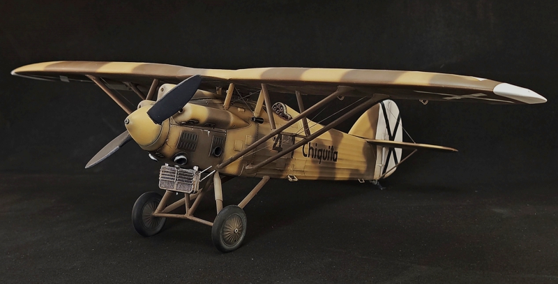

The landing gear is prone to break because of the weight of the model so you must be careful. I reinforced the struts/landing gear with steel wire.
Decals and PE are from kit. The insignia are painted with my own masks.
Enjoy!
