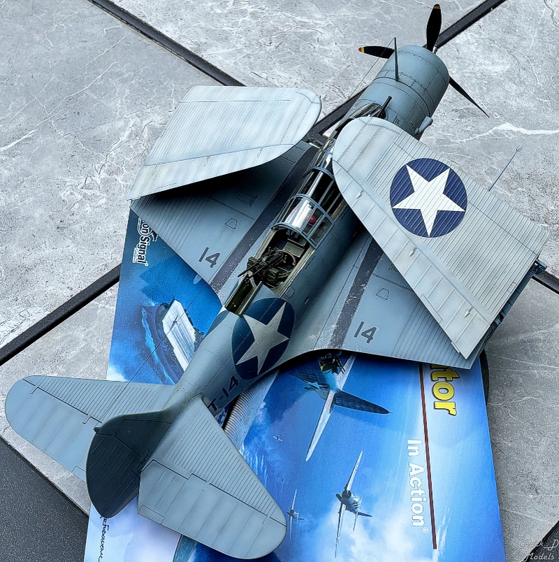

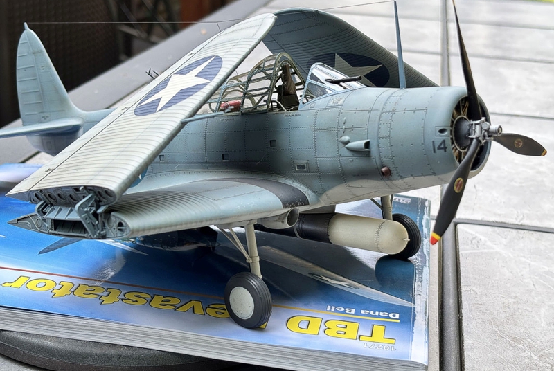

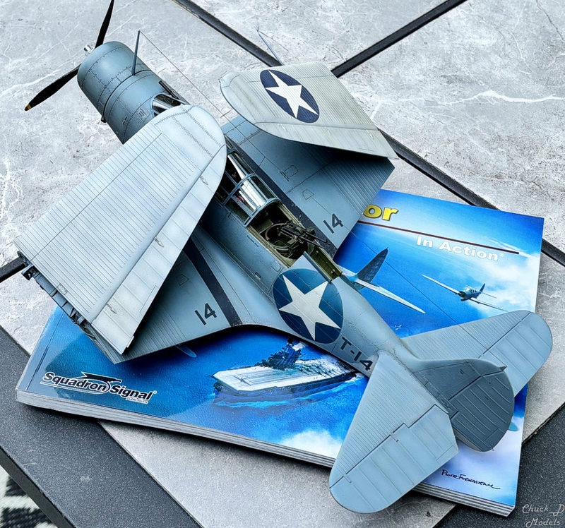

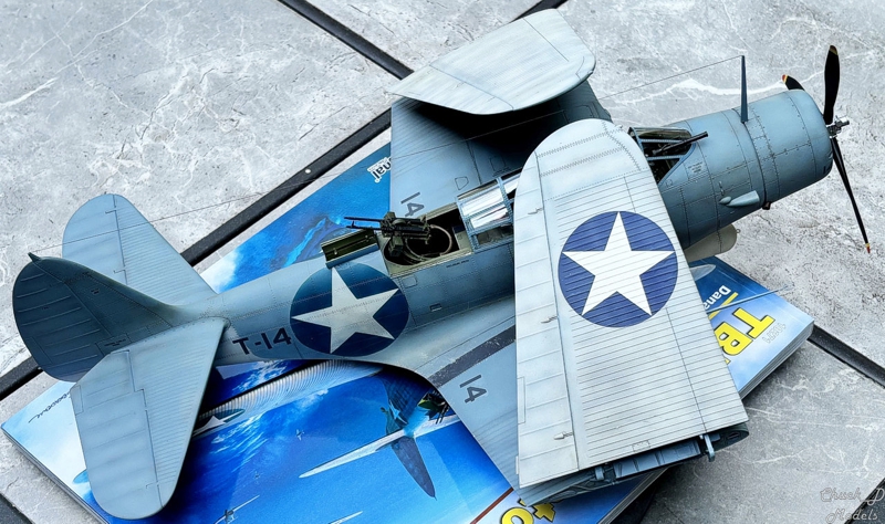

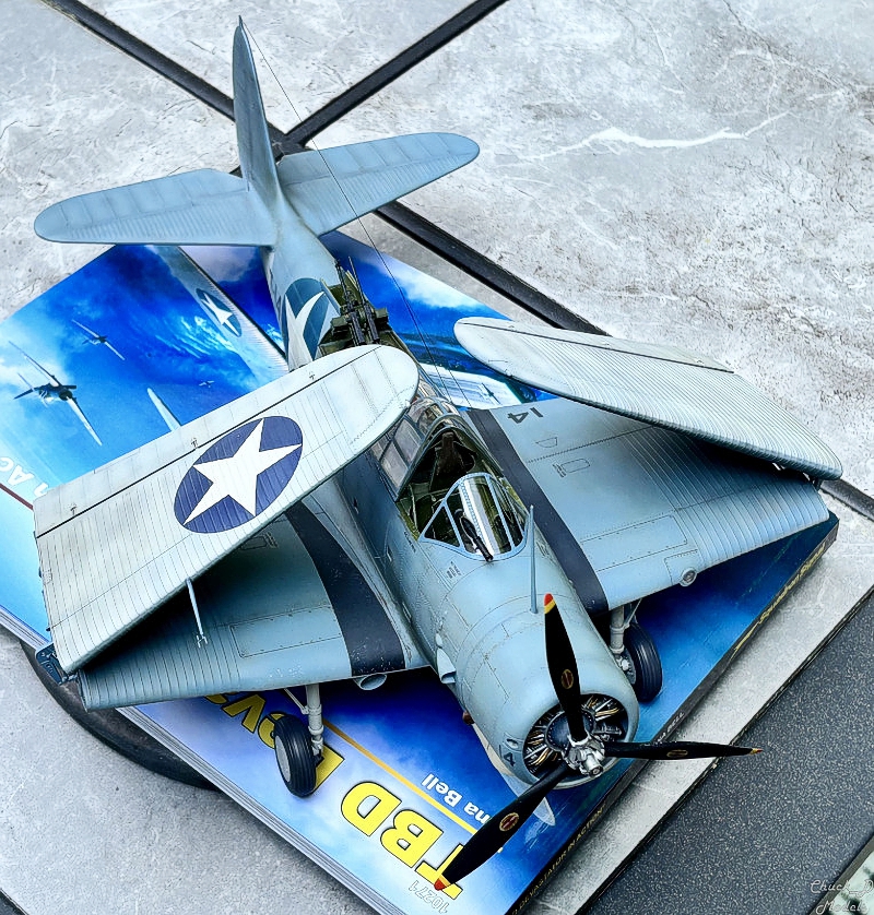

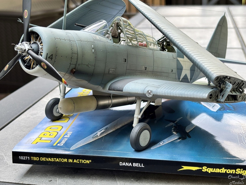

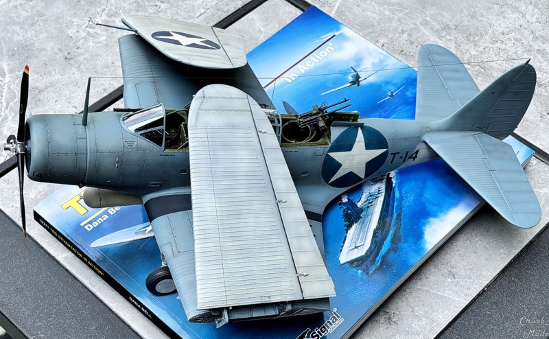

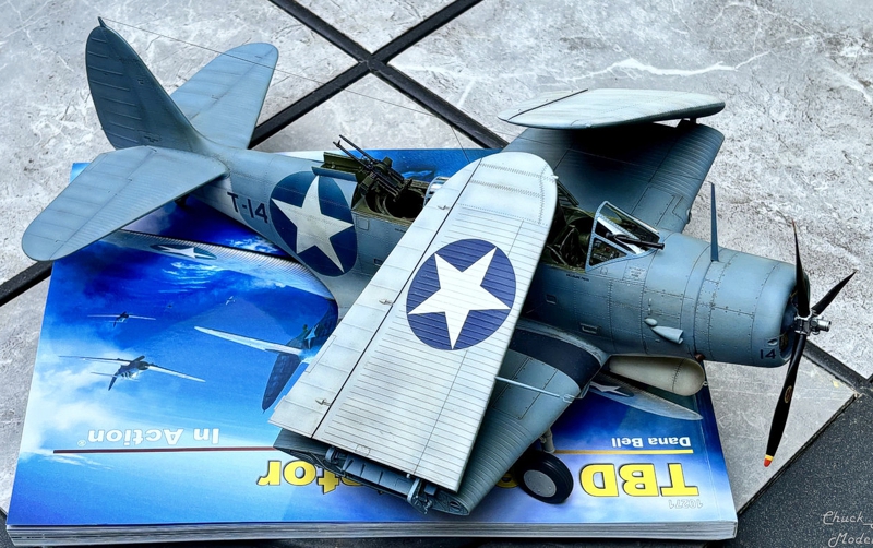

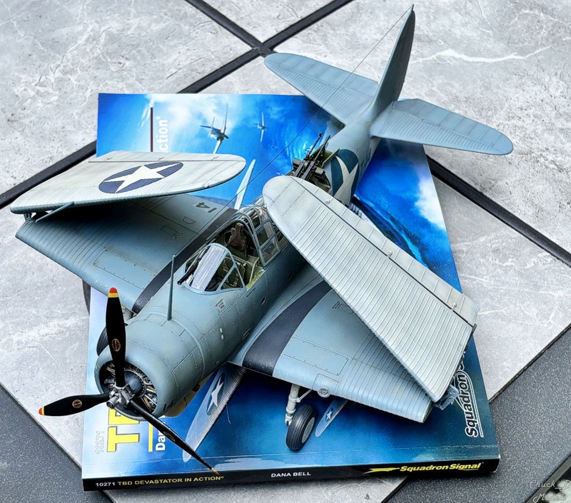

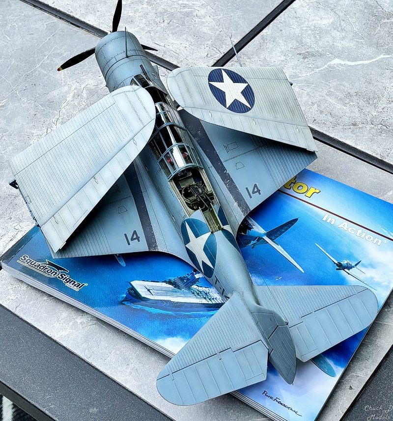

I was really geeked about the Devastator kit when it came out, but in my opinion, Trumpeter managed to put out an aggressively mediocre kit. In that regard, I guess Trumpeter managed to capture not only the form of the real airplane, but it's whole vibe too. So, kudos to them on that front, I guess.

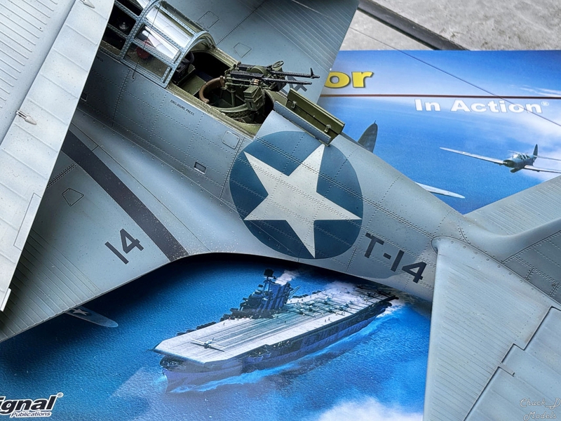

It fought me most of the way, but by the time I'd gotten really frustrated with it, I was too far along to pitch it. That said, I'm more or less happy with the result. The decals caused me fits, and you'll see quite a bit of silvering which is just super frustrating. I opted for decals as I wasn't confident that I would be able to get masks to lay down in the wing corrugations. Turns out the decals didn't feel like doing it either. Oh well.

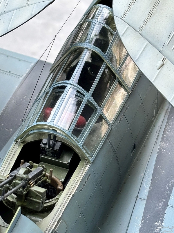

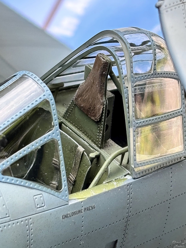

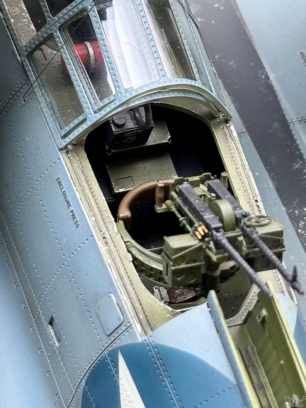

Anyway, the fit was okay in general, but I had it in my head to really detail up the interior, only to find that it's really, really spartan. The whole bomb aimer's area is just pure fantasy and doesn't line up with any of the reference photos in Dana Bell's recent book. So, it made it a real challenge to try to do any extra detail work on the interior. I suppose in the end absolutely none of it would be seen anyway, especially with the wings folded, but I would have known.
That said, I did use Airscale's PE and 3D printed products to add detail where I could. I can't recommend these highly enough and they're almost a requirement in my opinion. Off the top of my head, I used the interior set, the prop, wheels, gunsight, wing fold, and twin .30 mount. All fit pretty well without having to do much fiddling with adjacent parts and the added detail was/is lovely. Thanks Airscale!
I ordered the ASK stencil set as the kit-provided stencils are ridiculous. However, I would also suggest that the ASK set is only slightly less ridiculous as they are rife with spelling errors and their instructions seemingly have you placing them randomly around the airplane. Weird. I used the Gold Medal decals for the aircraft markings and, fortunately, they came with stencils and much more plausible placement instructions. Any issues with them laying down on the model are mine, not theirs. I highly recommend the Gold Medal set.
Also, if you don't have Dana Bell's recent TBD reference book, just buy it. It's a fascinating walk through a really weird, esoteric, and utterly mid aircraft.
I digress. This is my rendition of T-14, George Gay's aircraft from VT-8 on the day he became the sole survivor of his group's attack on the Japanese carrier fleet at Midway. If anyone's not familiar with it, here's a short primer on the whole thing.
Enjoy!
