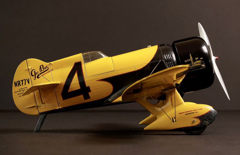

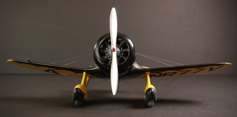

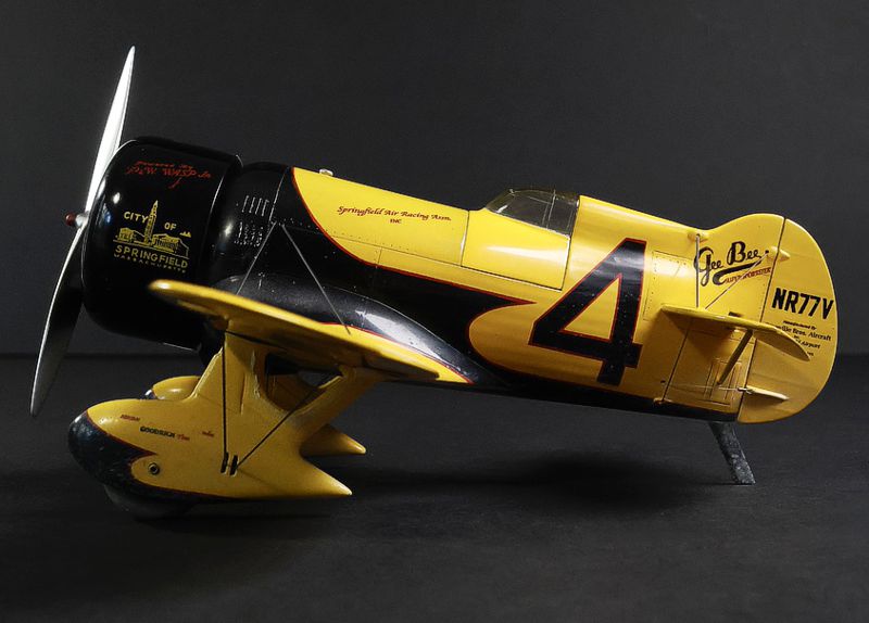

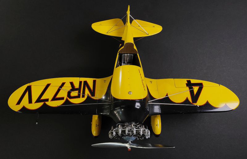

The Williams Bros. 1:32 scale Gee Bee Z that I built was the original 1979 boxing, with the bright yellow plastic. It is a lovely little kit that captures the shape of the aircraft well.

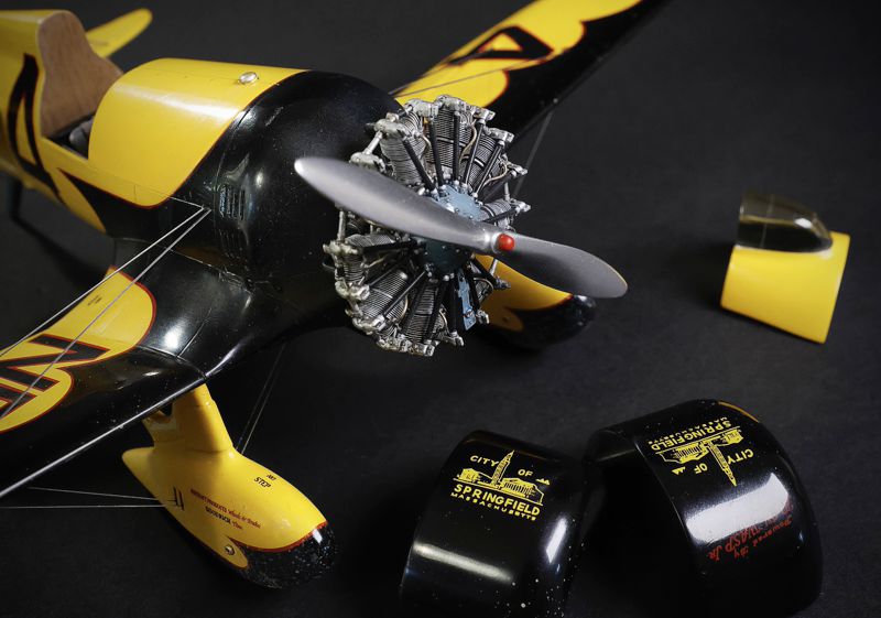

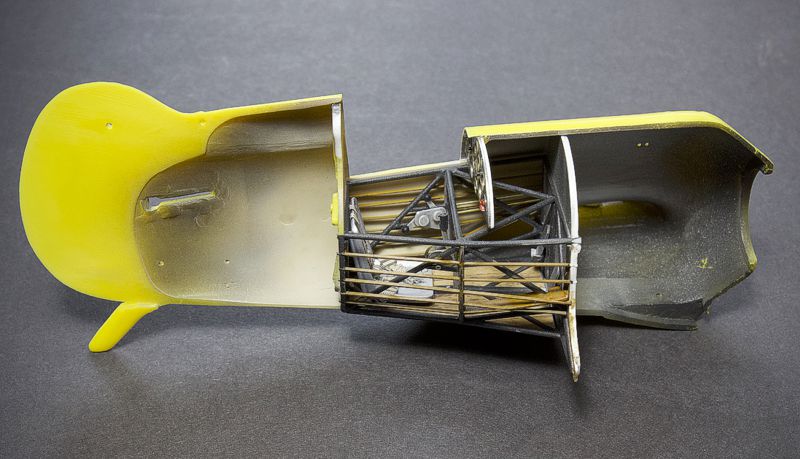

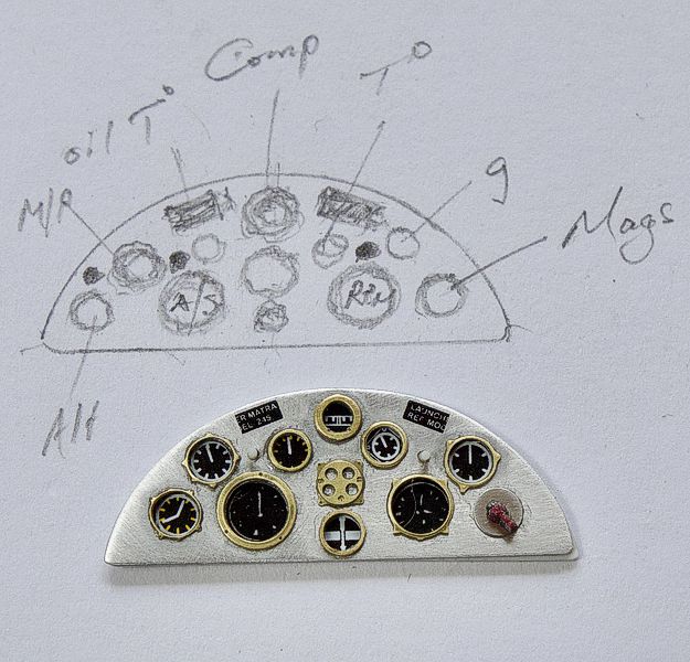

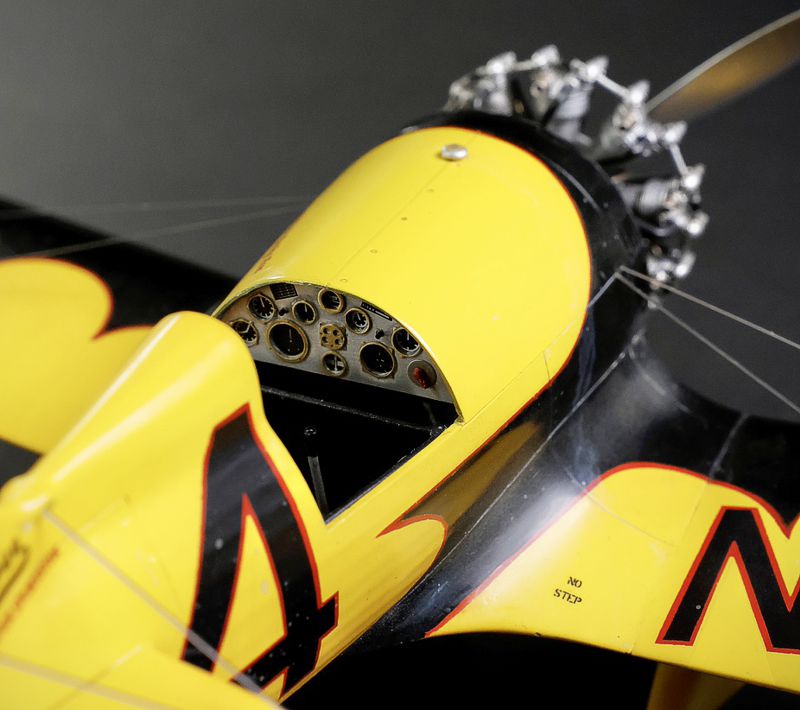

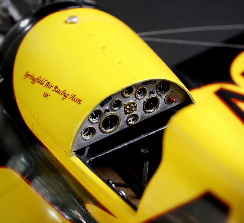

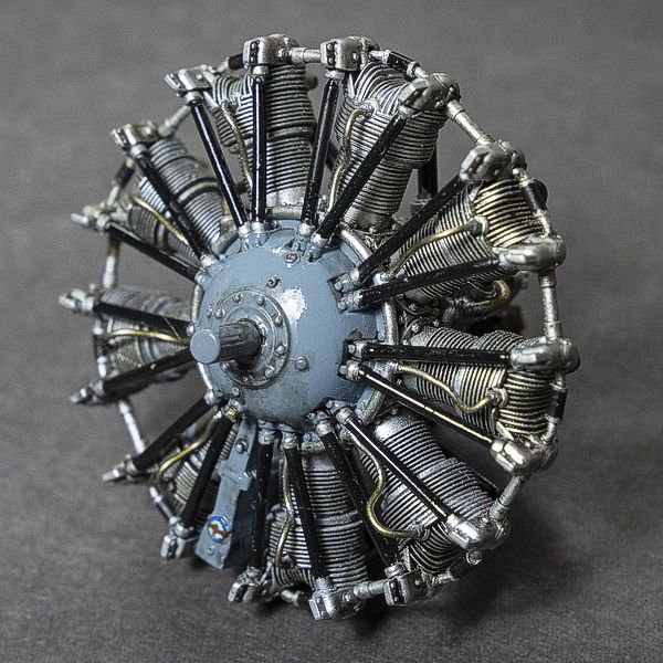

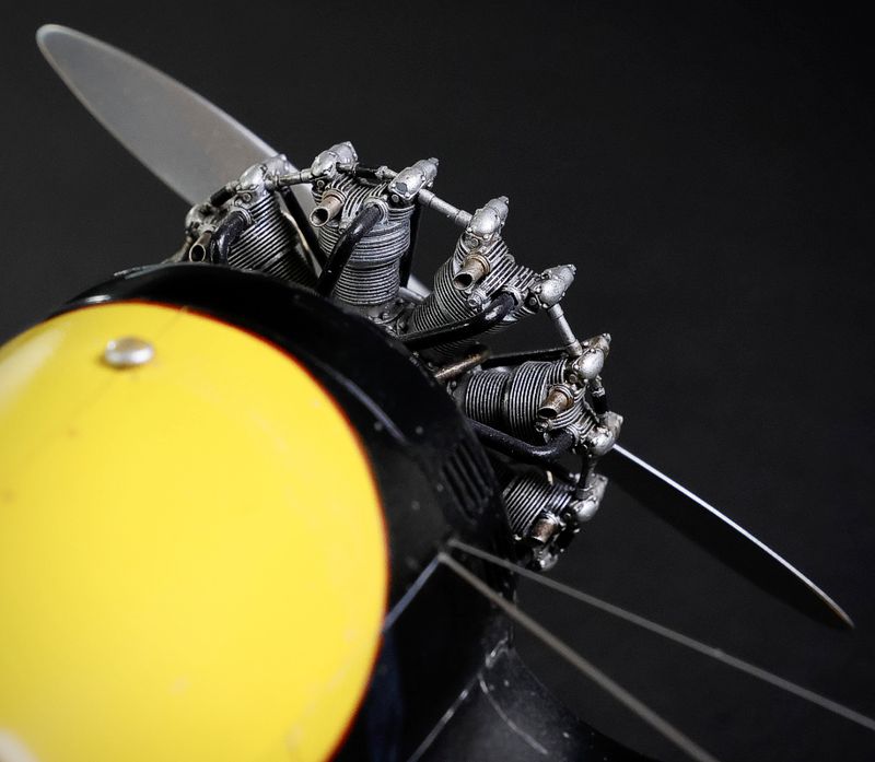

I wanted some more detail in the cockpit, and a more accurate engine. The cockpit would be my problem, but the engine was beautifully rendered by Armory from the Ukraine.
It took a bit of experimenting to get the look I wanted for the black. It was too glossy with several layers of X-22 on its own, so I lightly sanded the high-gloss finish with a 2000 grit cloth and then buffed it to a semi-gloss with 8000 micromesh.

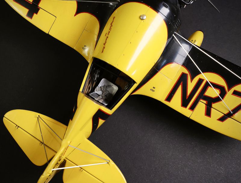

The mostly unusable 46-year-old decals nearly undid the build though, as I elected to print some of my own, instead of sourcing replacement ones (which Williams Bros. actually did print years later).
Despite numerous mishaps, here it is - minus a couple of decals, but good enough for my wife's desk. If you'd like to find out more, check out my build thread in the Work in Progress forum.
