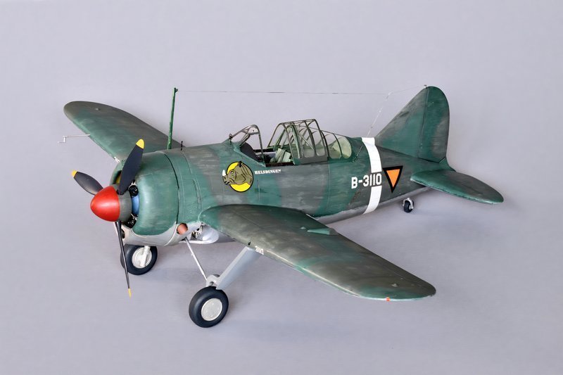

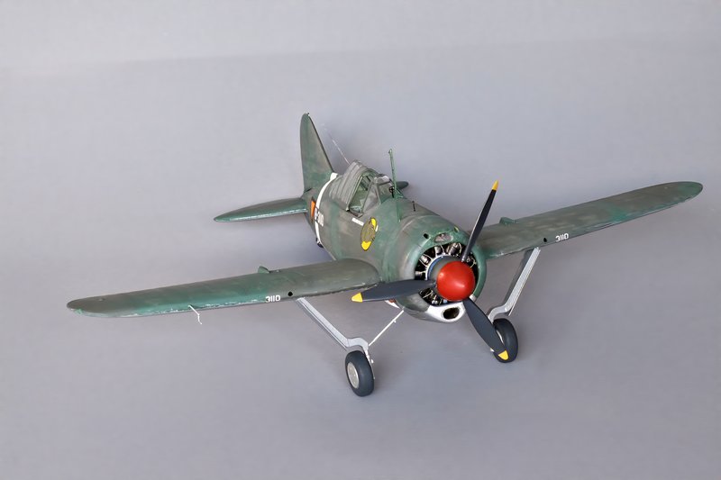

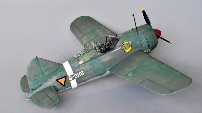

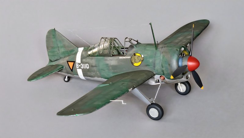

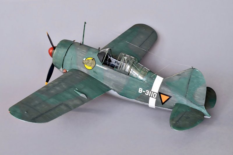

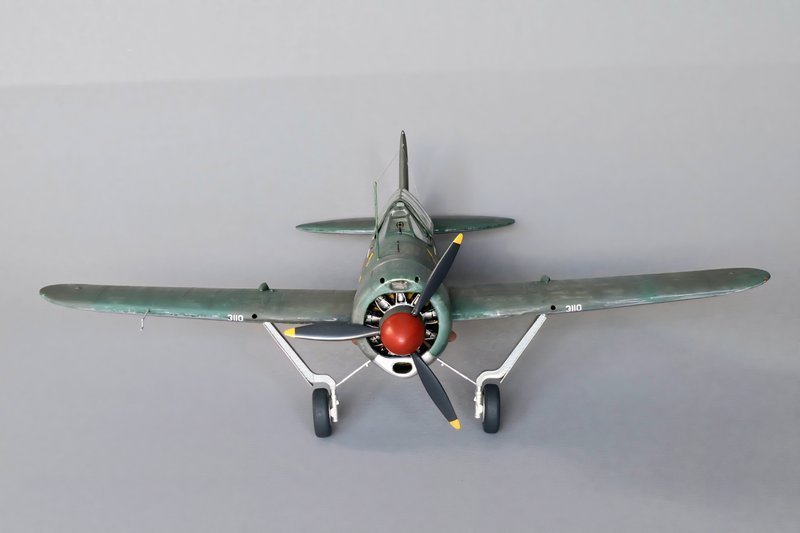

The kit contains some PE and resin parts. It assembles well, however the tail cone didn’t fit flush to the fuselage. The trailing edges of the wings, rudder and tailplanes are rather thick but this can easily be rectified. The undercarriage is a bit flimsy. The model was airbrushed with XtraColour FS 34092 and FS 34088 and heavily weathered. Decals are Dutch Decal and Flevo decals. Antenna wire is Uschi van der Rosten, pitot tube is Master’s. I scratch-built the upper and lower intake ducts in the front of the engine cowling.
