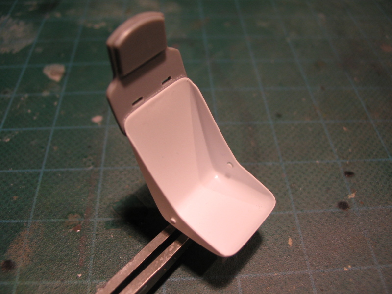

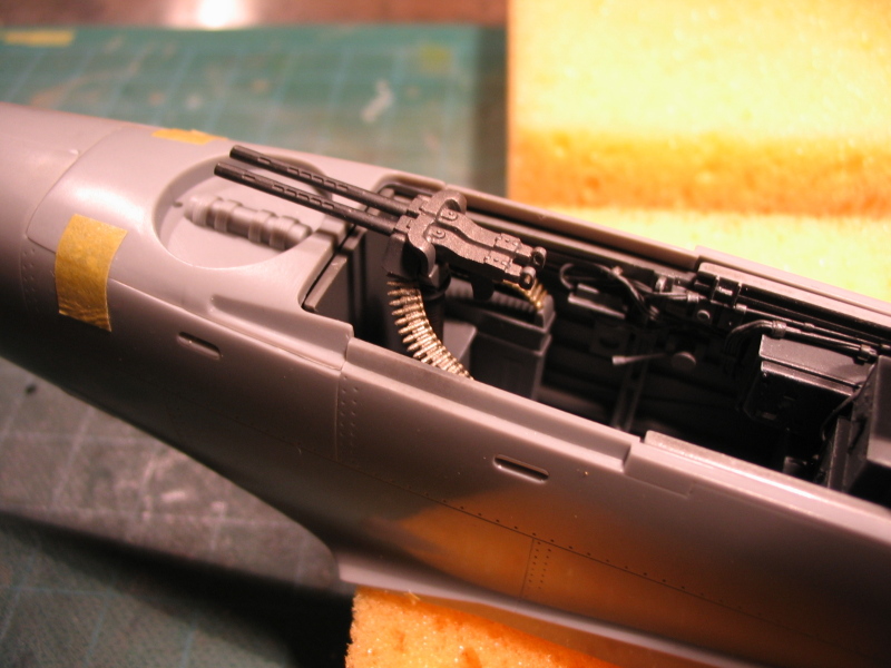

This has been one long build... and a very big step for my building and finishing skills! The kit needs no introduction, so I will skip right to the build… the cockpit was detailed up using stretched sprue and other scratchbuilt parts. The seatbelts are paper with Eduard buckles from their 1/32 scale Luftwaffe details. The rear machine gun has 1/35 scale MG42 ammo belts from a Dragon second generation kit – this addition to the rear compartment adds so much realism as the rounds are 3 dimensional rather than 2 dimensional (as in PE parts). The finish is Gunze aqueous RLM 70/71 and the cockpit is RLM 66.
