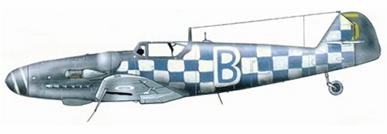

I had such a great time finishing my 1/32 Hasegawa Messerschmitt that I immediately began searching for another scheme for my next 109. I wanted to do a scheme that was "unusual" and not with Luftwaffe markings. When I finally ran across this scheme in a profile by Jan Mace I was hooked.

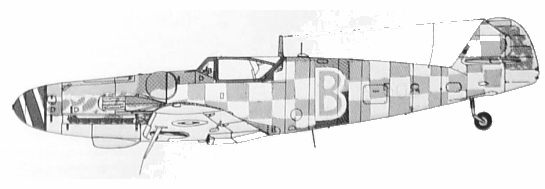

Of course during the research that followed the scheme took on new aspects and presented challenges around every corner. But I decided early on that no matter what I found out about this ship during the build, that the Mace profile was to be the heart and soul of the look I was after.
![](/articles/images/573/fin_g6.jpg)
The acorn: Jan Mace's profile of MT-508 Image copyright Jan Mace 2004
Shortly after finding this profile I ran across a project for skinning a flight sim (European Air War) over on the SIMHQ Bulletin Board, where a team had tackled this ship. It was here I found out why this Messerschmitt was decked out so boldly.

Within the Stenman volume is also this alternate profile. The third profile I do not have a credit for as I received it without a proper resource attribute.
![](/articles/images/573/profile_2.jpg)
Image copyright © Pentti Manninen and Kari Stenman 2001 - 2004 used with permission from the publisher
![](/articles/images/573/Mt-508-2.jpg)
With the above resources in hand, and a mandate to myself to stay true to the Mace profile I came up with the following interpretation of MT-508. One thing to note is that while the markings in the photo and the above two profiles are crude, I made a choice to "straighten" them up, especially with regards to the checker pattern. In the Mace profile the checkers are much more regular and trued than the actual paint job probably was. However ultimately we must build and paint what moves us, and spending long hours replicating a sloppy checkerboard did not move me.

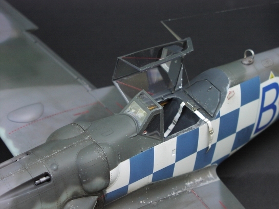

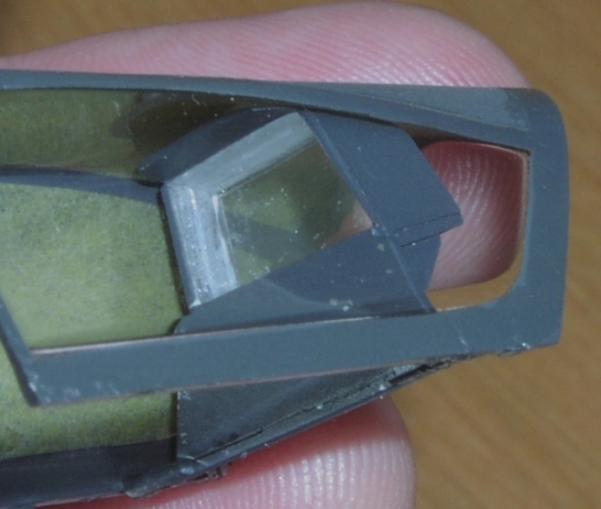

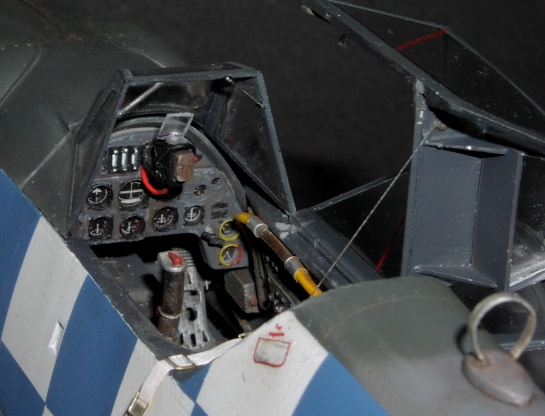

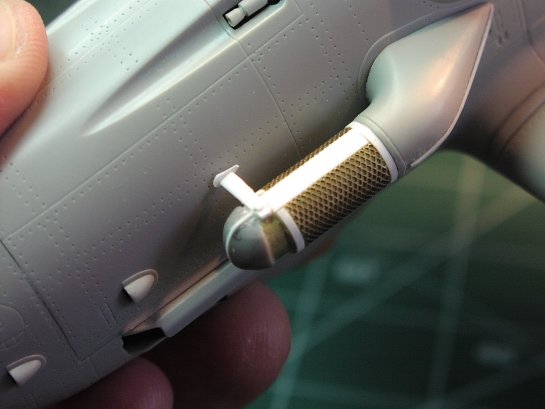

Trumpeter kit is well engineered so the build went fairly smooth and as such there's not much to tell. A few items needed to be scratch-built to represent the 6/Y but nothing too fancy. Some creative trading got me most of the parts I needed and all I had to fashion was the tropical filter, the distinctive "Galland Panzer" armored headrest, the DF loop, and the underwing antenna.
![](/articles/images/573/trop_2.jpg)
Tropical Filter made from sheet plastic, brass screen, and a spare 500lb bomb in 1/32
![](/articles/images/573/panzer.jpg)
Galland Panzer armor done with some kit elements, polycarb sheet and plastic sheet
![](/articles/images/573/DF_loop.jpg)
DF loop, all plastic sheet, the base formed with a Dremel.
The excellent "Luftwaffe WWII Fighter Harness" set from MDC was used with great results, and beyond that and the notes above, the build was OOB.

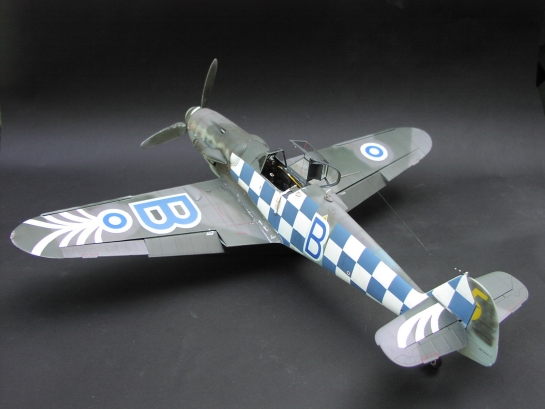

Well this is where the rubber meets the road on this build.Having such a unique scheme this ship required lots of planning and thinking.

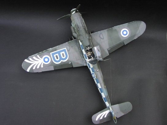

Basic paint scheme was standard Luftwaffe RLM 74/75/76, all shot with Polyscale Acrylics through a Badger 150 using the medium needle and tip. After the camo I hand-sprayed the "covered" Luftwaffe markings (crosses and swastikas) with RLM 80 and 76 (top and bottom). Then moved to the "covered" war-time Finn roundels with RLM 75.
![](/articles/images/573/mt508_5_detail.jpg)
The exotic racing markings consisted of the blue and white checkers, the blue and white "B"s and the distinctive wing and stabilizer designs in white. I used a few different techniques here and used Tamiya "Gloss White" enamel from a spray can for the white areas to offer a hard resilient base for the blue, which was done with Polyscale acrylic. Most of the racing markings were done with hand cut masks and masks from Aeropoxy.

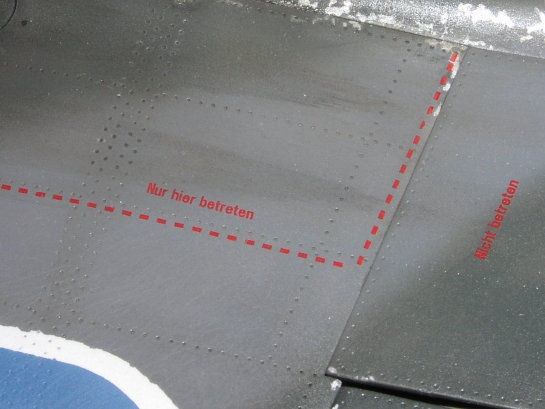

The center Blue roundels were home made inkjet printer decals, and all the stenciling was done with the excellent dry transfers offered by Hobbydecal.com.
![](/articles/images/573/stencils.jpg)
Detail of the dry transfer stencils from Hobbydecal.com
Weathering was done with oil paint washes of Umber and Black, some dry pastel dusting in earth tones, and paint chipping was done with a Primsmacolor Silver pencil except for the propeller blades which were done with Testors Model Master Buffing Metalizer, sealed with Future Floor Wax, then painted with Polyscale acrylic RLM 80, and finally chipped with a sanding stick.
