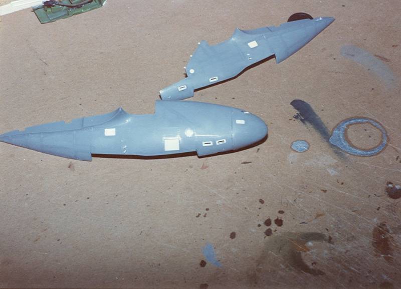

This is a 1/32 scale Revell P-38 Lightning I built roughly 12-15 years ago, I can't really remember. It was my intention to add as much detail as I thought necessary to make for an attractive display, as well as be a competitive model. To that end, several things were done. Several small plates and framing around shell discharge are were done with plastic strips.

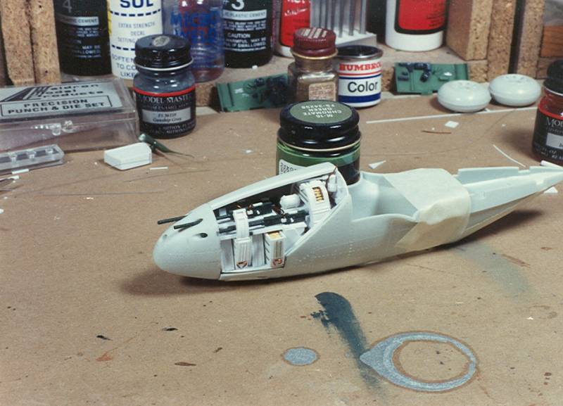

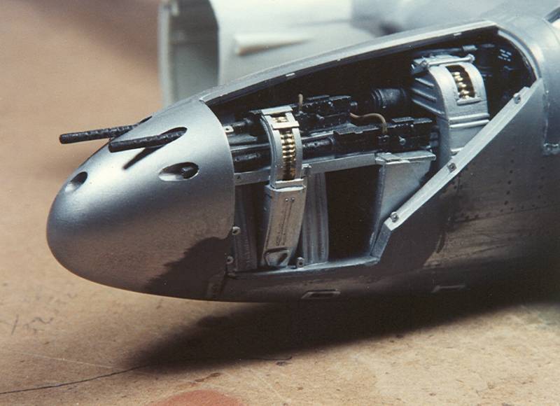

Gun bay, including 20mm cannon, ammo feed chutes, ammo boxes, access door, etc. was completely scratch built using rods, tubes and sheet plastic, (as well as a healthy dose of reference materials).

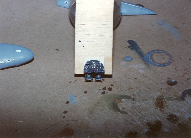

Cockpit for the most part, including instrument panel, was scratch built, and/or kit parts heavily embellished using standard methods. Some items had to be faked, as I had very limited access to reference resources.

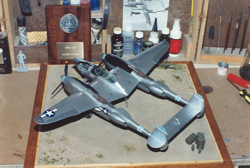

No additional detail to speak of except for scratch built boarding ladder, tires painted over a screen to simulate diamond block pattern. Fine mesh screen was added to radiator and oil cooler inlets. Main gear was shortened, nose gear extended to give a nifty tail heavy sit. Lots of weight was crammed into nose and boom fronts to compensate for the natural tail heavy sit. One boom had to be "liberated" from a spare kit, as I severely mangled the original somehow. Entire airframe was painted with MM Metalizers of various shades using wet newspaper as masks. Kit was not re-scribed, although I did consider it; rather, entire airframe was heavily sanded to reduce rivet and panel line contrast. All in all, it all worked out OK I guess.
