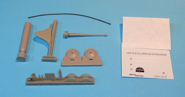

The envelope contained an instruction and colour call-out sheet in typical Aero Bonus style with parts list on one leaf, rudimentary instructions on the opposite leaf and colour call-out and decal placement advice on the rear.
The resin comprises the smaller items, the main gas bottle, the framework, extinguisher nozzle and wheels all on separate pour stubs. Aero Bonus also supply a short length of silicon tube to use as the hose.
There is a small decal sheet offering a number of white bands, a data plate and "Carbon Dioxide" stencils.

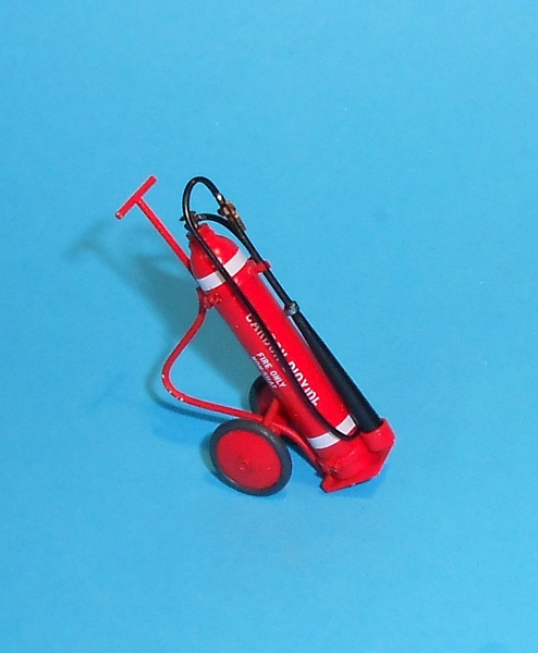

A lick of paint came next. I primed the resin in white then used Vallejo "Red" for the extinguisher and Citadel Miniatures Chaos Black for the nozzle.
The decals are very thin and conform well to the model but I'd advise caution and copious use of water to help position them. They do like to fold in on themselves too so watch out for that because if it happens, there's next to no way to retrieve them.
The tyres were hand painted in Vallejo "Black-grey" and the various brass components were again hand painted with various metallic shades from the stash.
With a little bit of help this little kit builds up into a nice model. It is a great basis for a little extra detailing and will look neat next to an aircraft model.
