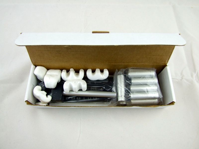

The product ships in a neat, sturdy cardboard box, which is packed full:
The contents are as follows:
- 1 sturdy die assembly
- 16 metal punches
- 1 small hammer
- 1 small sheet of instructions

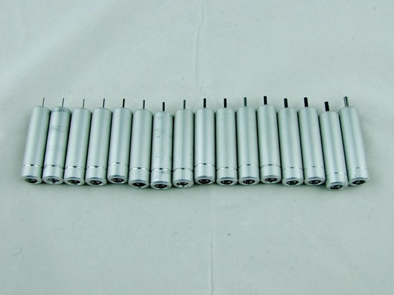

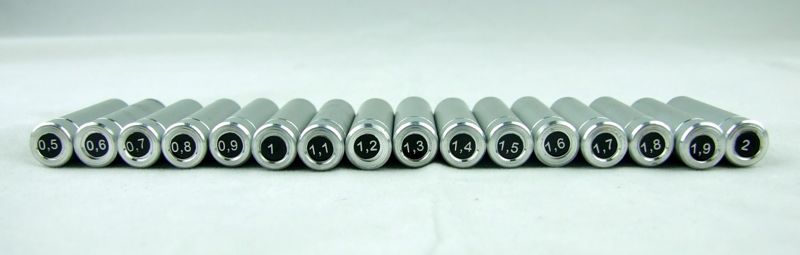

As you can see, this is quite a substantial package, with a massive 16 punches in the set. These range from 0.5mm to 2mm, and each is labelled on its end.

The instructions handily warn not to use material of a greater thickness than the diameter of the punch itself, which seems like sound advice to me. As you can see from the photos, the punches differ from the traditional Waldron type, in that the punch element is embedded in a much larger, and much sturdier, metal cylinder. This is a superior arrangement in so many ways. Firstly, it allows the punches to be labelled with their diameter - always useful. Secondly, it gives the hammer or mallet a much greater target to work with than a tiny punch. And most importantly, it protects the otherwise delicate small punches from being bent or damaged by blunt force trauma. Excellent!
