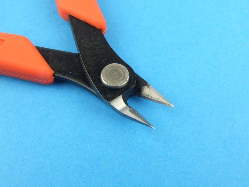

The business end of these cutters is protected by a chunky sleeve, made from soft, clear plastic:

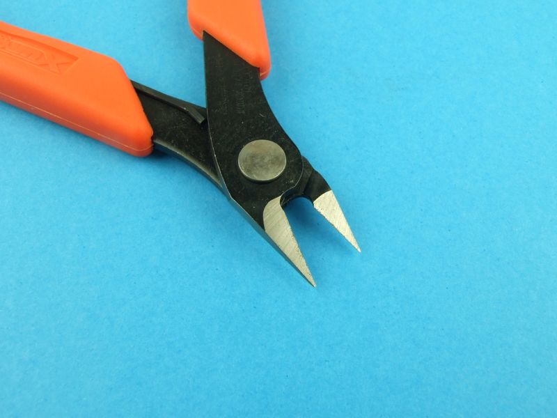

The cutting tines are relatively short, and taper to a fine point. One side is flat to enable flush cutting, while the other side is wedge-shape to form the cutting edge:

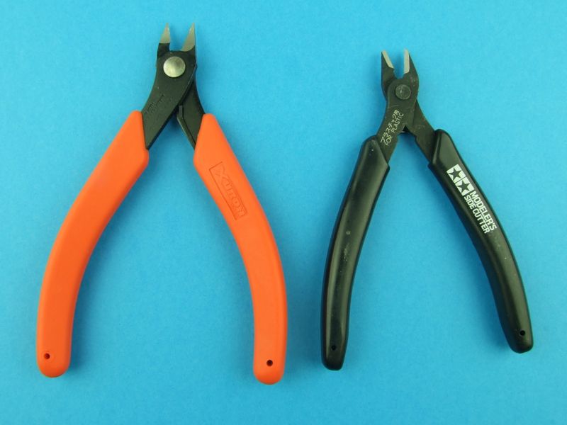

My go-to sprue cutters at the moment are the black-handled ones from Tamiya, so I thought it would be interesting to perform an A/B test, comparing the Xuron and Tamiya tools:

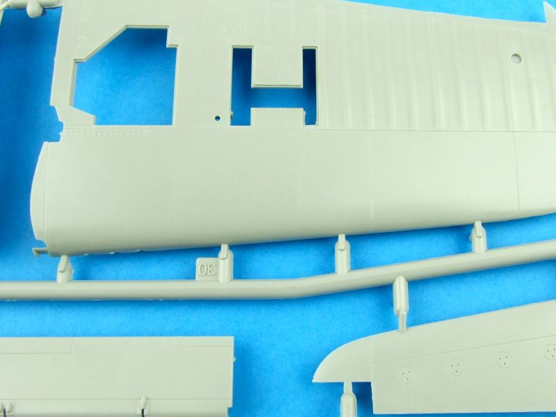

The Xuron cutters are larger than the Tamiya ones, and have a stiffer action. I found both tools quite comfortable to use, though the Xuron set allowed for more force to be applied, which may be useful for thicker sprue gates. My test subject was the wing from Trumpeter's 1/32 F4U-1 kit:

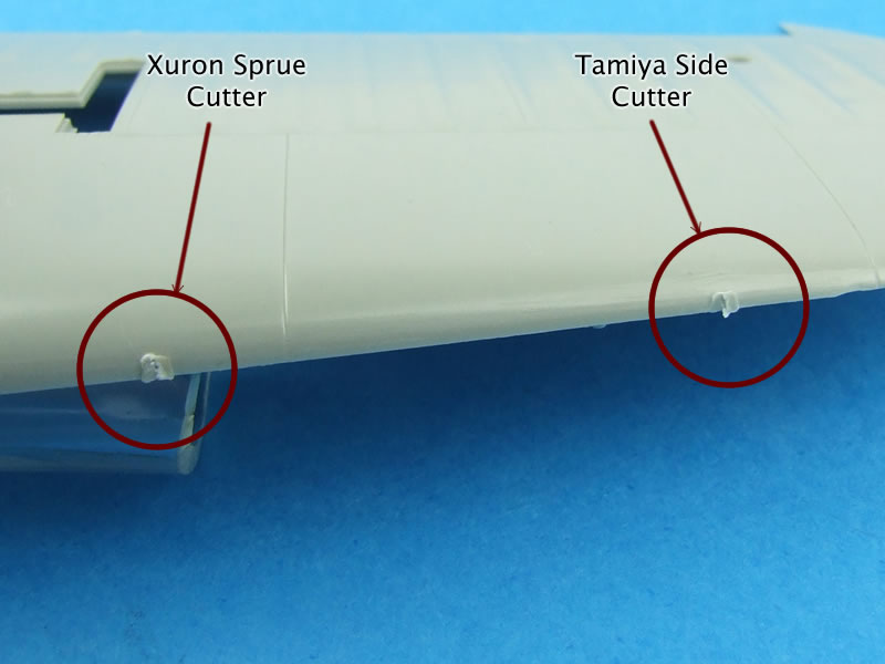

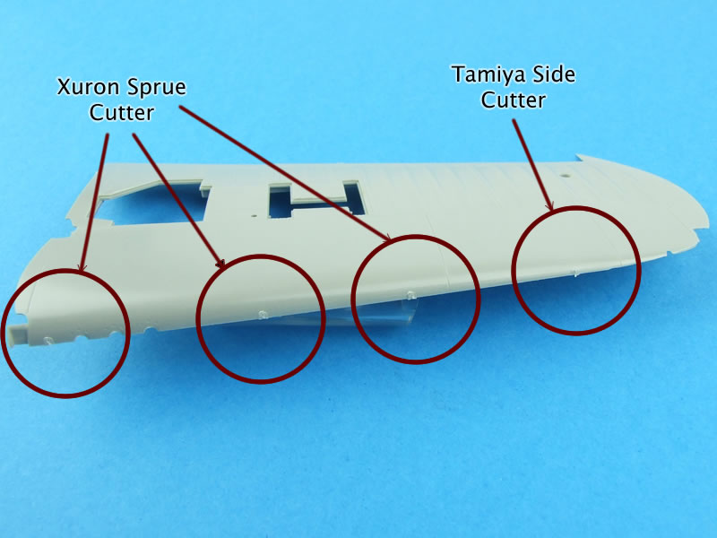

The sprue attachment points are solid, and encroach slightly over the part itself. I made the first sprue cut using the Tamiya cutters, and the rest with the Xuron tool:

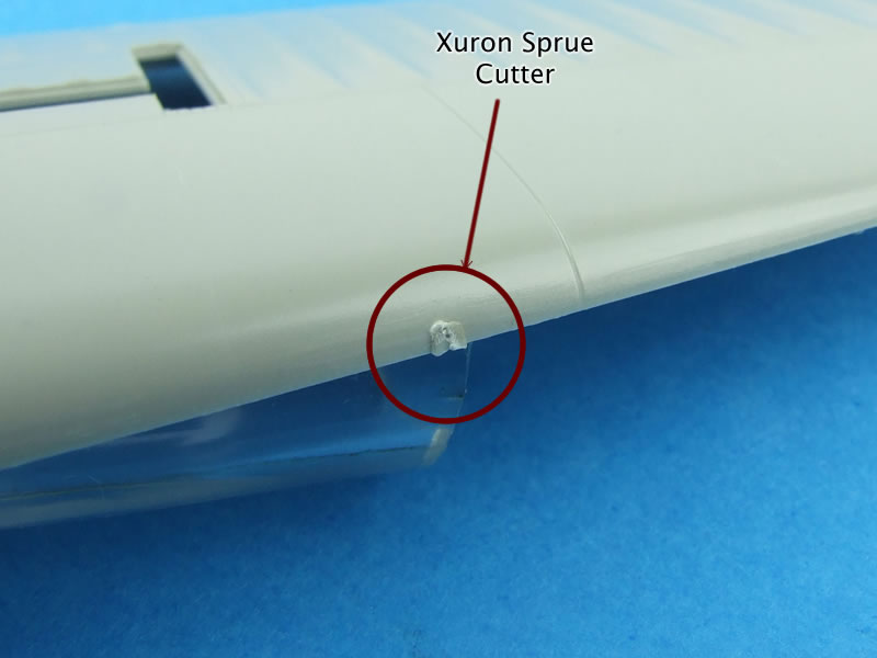

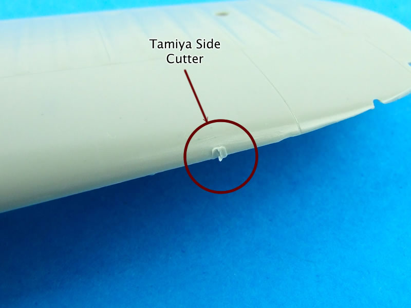

In practice, both tools produced a very similar result, and I'll refer you to the close-ups below for a better look:
No sprue cutter was ever going to be able to produce a flush cut on a curved surface such as this wing leading edge, so in each case there's some residual plastic to clean up. The Xuron tool seems to produce slightly less compression damage than the Tamiya cutters, but there's not much in it. Note that the attachment point handled by the Tamiya cutters was the smallest of those along the leading edge of the part. And it's useful to remember that this hardly constitutes exhaustive testing.
