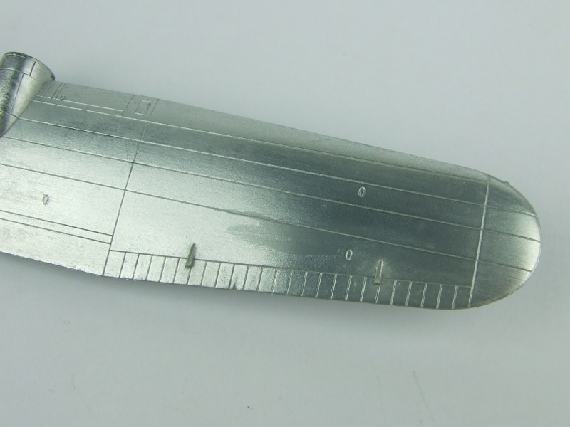

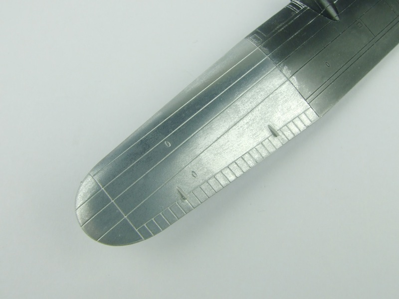

The paste itself has the consistency of gritty toothpaste, and initially flows off the brush with alarming ease - so much so that it's hard not to feel that you're using too much. Within a few seconds though, the wax starts to congeal, and just like brush-painting any kind of paint, it becomes highly susceptible to brush marks. Unfortunately, these don't level out like they might with a good-quality hobby enamel. Here's the result of the first pass:
The first thing to note is that, with this particular application technique at least, the underlying colour had no effect on the end result. Secondly, as you can see in the close-up below, the brush marks are quite evident, and the overall finish is highly uneven:
Rather than simply apply more, I decided to see if polishing would rectify or otherwise improve the finish. The instructions give no indication about 'drying' time, or how long it takes to become safe to handle or polish, so I attempted to polish the surface more-or-less immediately after taking the photo:
It certainly polishes nicely, and doing so brings out quite an authentic metallic sheen. But polishing made no improvement to the unevenness of the finish, and in some respects made it worse:

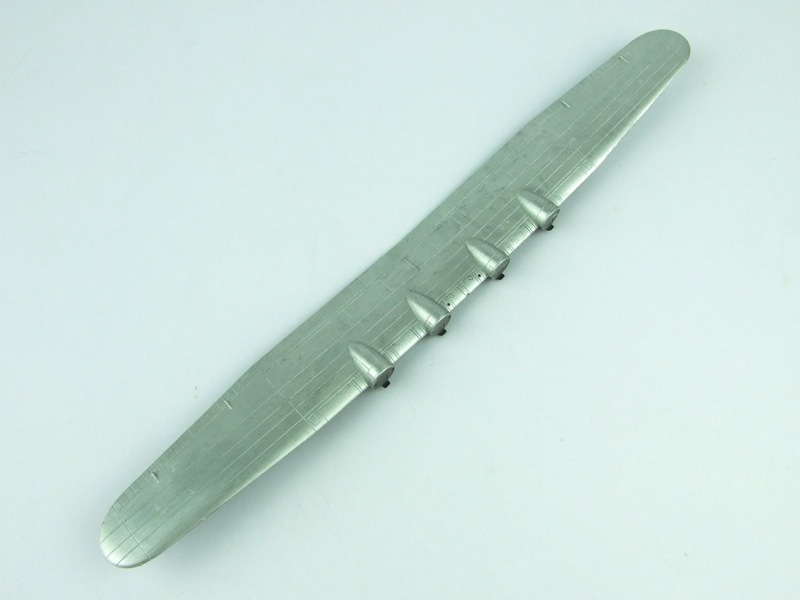

The overall effect, however, was the best so far:

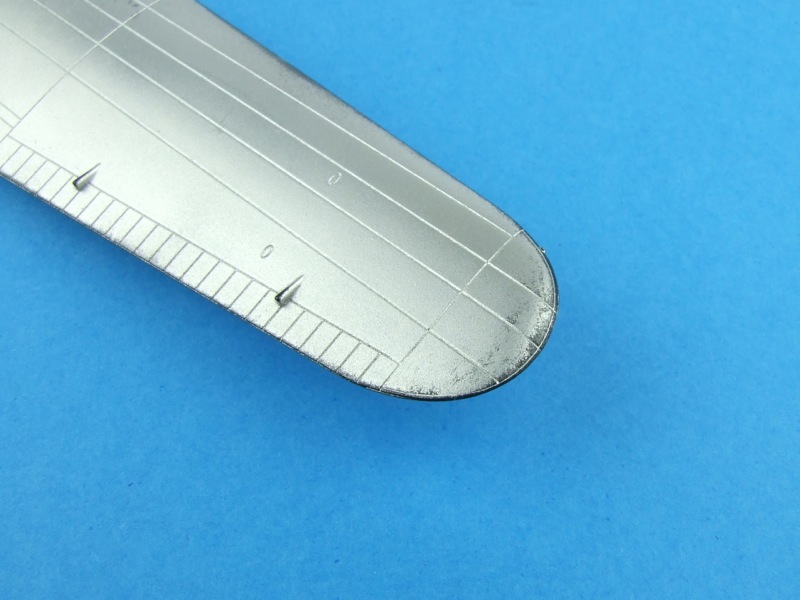

Success! My airbrush still sputtered and complained, but the result was a smooth, if dull, aluminium finish. The result proved to be substantially more fragile than the painted-on version, and breaking through to the primer wasn't difficult to do:
But still, it looked decent enough overall:

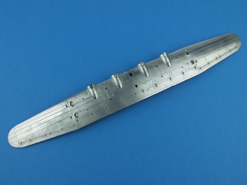

I even re-sprayed the underside to good effect:

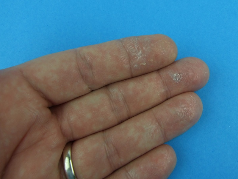

This was, however, a lot of trouble to achieve a finish not quite as good as I can achieve more easily with other methods. What's more, the resultant finish is exceedingly fragile, and comes off easily on your fingers:
