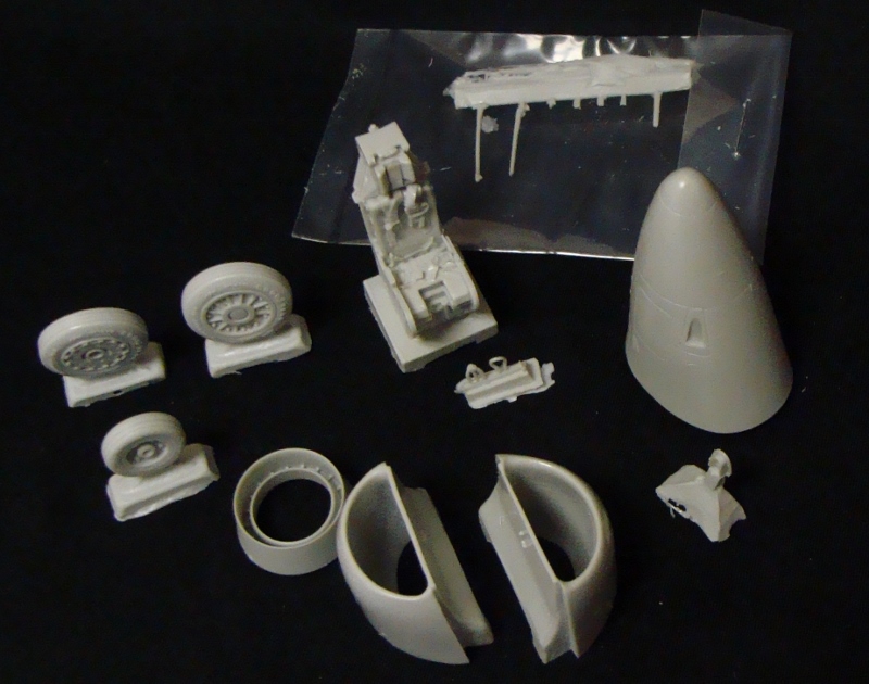

The Resin Conversion

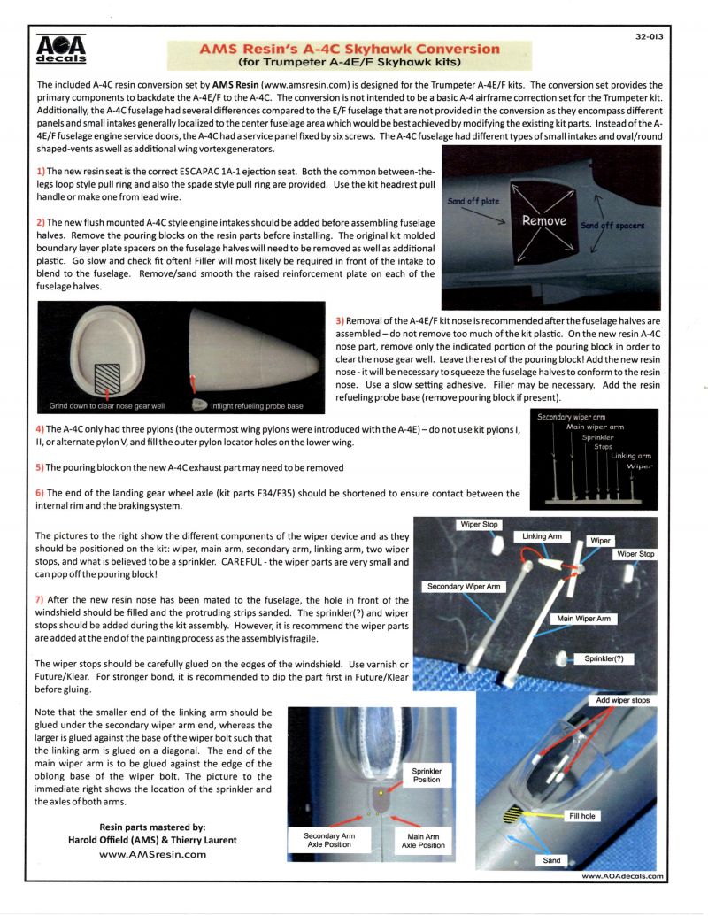

The conversion set provides the main components to backdate the kit to the earlier A-4C - new short nose, windshield wiper assembly, short intakes, new exhaust, and also includes correct ESCAPAC ejection seat and earlier spoked style wheel hubs.
You also get a pretty comprehensive guide to help you use your parts including instructions on what needs to be cut off, filled in/over or added to make a correct A-4C.
