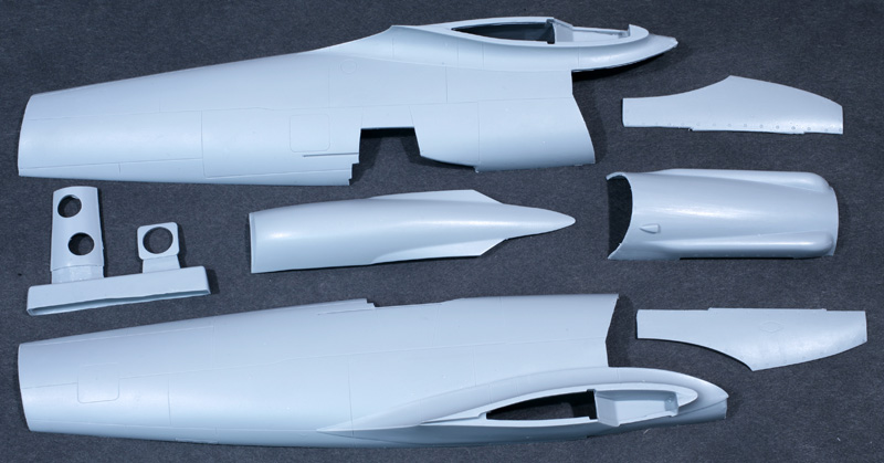

The fuselage is conventionally cast with thin walls. The engine compartment is made up of an inner frame with four panels enclosing it plus two parts containing the twelve exhaust outlets. Separate parts are provided for camera ports if you decide to build VB895.

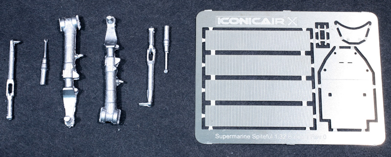

Main landing gear are done in white metal and are well cast with very little pitting and clean up needed. The metal does not appear to be too soft and I think will support the model just fine. The tailwheel is a one-piece resin affair similar to what Hasegawa typically provides, i.e. wheel and fork are one piece. PE is provided for the radiator screen faces and cockpit armor.
