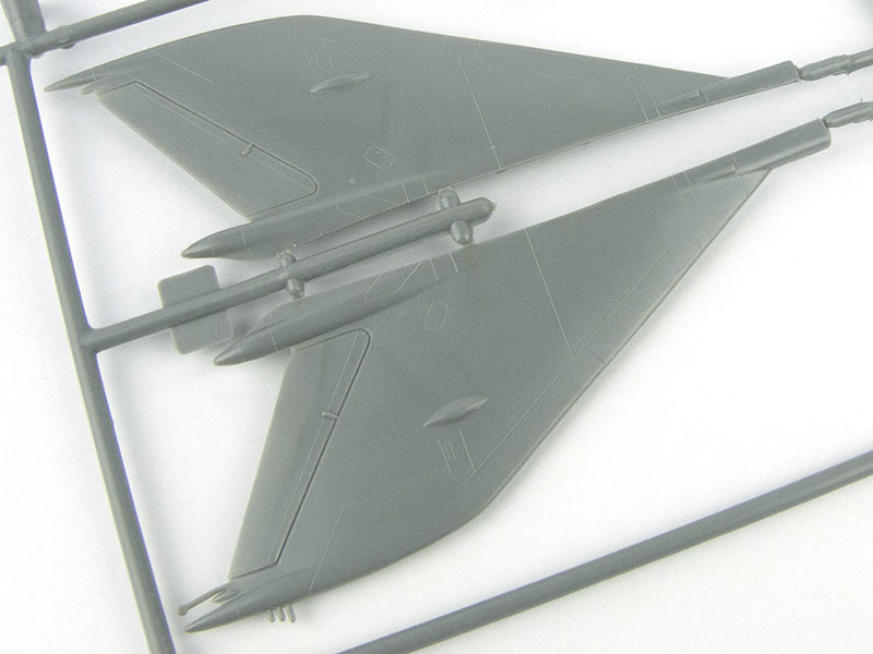

In order to put these new paints through their paces, I dragged a pair of Revell 1/48 MiG-21 tail fins out of the spares box:

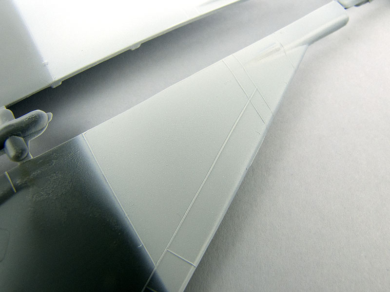

I did nothing more to prepare the surface than give the parts a wipe-down with a cotton bud dipped in Windex (an ammonia-based window cleaner). Scott told me that these paints were good to go over bare plastic, but I decided to give one of the fin halves a couple of light coats of Tamiya Fine Grey Primer, just so that I could test both scenarios:

I started with the white, and added some to the colour cup of my airbrush. It seemed a little thick to me, certainly much thicker than Mr. Paint straight out of the bottle. However, it sprayed nicely, and produced a respectable finish after only two light coats:
I was especially impressed with the pigment density and resultant coverage, which was easily as good as any white I've ever used. This may account for some of the additional thickness, but I'd be opting to thin it slightly in future, and build up the opacity in thinner layers.
The paint performed pretty much the same over both the primer coat and bare plastic, with no visible difference in the coverage or opacity in each case.
Another really impressive feature of these paints is the drying time, which, as you'd expect with a lacquer-based paint, is quite fast. In this case, I was able to apply a second light coat of white to the first fin half as soon as I'd finished applying the first coat to the second fin half. It was literally touch-dry in seconds.
Up close, some slight orange-peel is noticeable, but thinning the paint to something closer to a milky consistency is all that's required to deal with that.

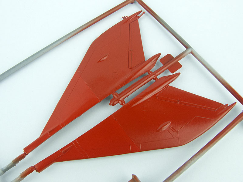

It was clear that the red paint would need thinning before it was capable of producing the expected results through an airbrush, and I was somewhat surprised that it sprayed as easily as it did. So, I gave both fin parts a light polish, thinned the paint to a 50/50 mix with Mr. Color Thinner, and proceeded to cover the white sections with the thinned mix. This time, the results were much closer to what I had been expecting:
The paint layer itself is glossy, smooth, and rich in colour depth. The small imperfections you can see in the photo are due to inadequate surface preparation on my part, rather than any failure of the paint itself. This time, I was much more impressed, and I feel like the paint was finally living up to the promises Scott had made for it.

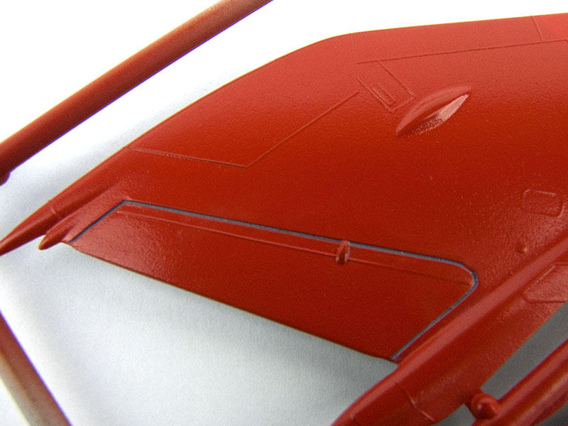

Testing a panel line wash is really not a complicated affair: shake the bottle, load up some product on a small brush, and flow it into a panel line. The hallmarks of quality oil-based washes are that they flow well into details over a gloss finish, that there's little-to-no pigment break-up, and that excess wash cleans away quickly and easily.
I used the SMS Grey Panel Line Wash on the engraved rudder line of the MiG-21 fin part that was still glossy, and found all of these things to be true. The result, while not necessarily the best colour choice for this particular example, is exactly what is required, no more, and no less:
As you can see, the line is consistent in colour density, and the excess has cleaned up without any staining or tide marks. And best of all, no mixing!
