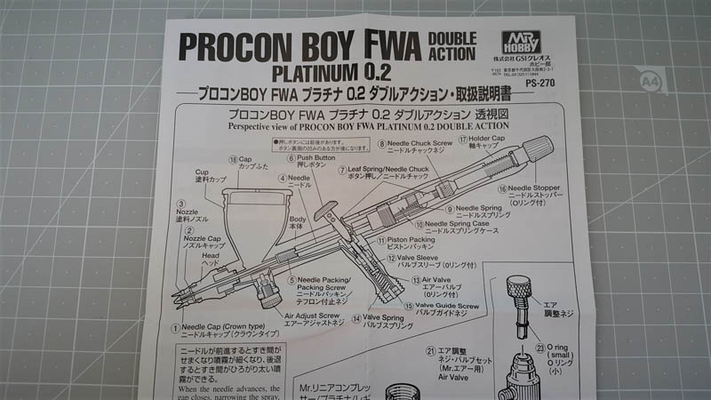

On the back of the box there is a profile drawing of the airbrush, with abundant description of its features, unfortunately in Japanese. And since I am not fluent in that language, although I respect it a lot, I will try to give my own perspective about PS-270 led by experiencing it.

Once you open the box the first thing that you get your hands on are the instructions. There are two sheets inside yet again – in Japanese mostly. The first one is the troubleshooting and maintenance guide which is in Japanese only. Fortunately, there are very cute drawings of a boy who does stuff with the tool and explanations how to cope with everything. The numerous drawings makes it self-explanatory though.

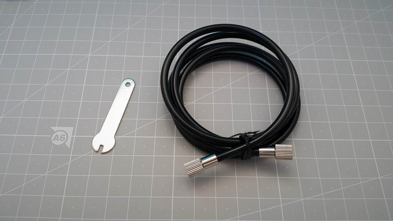

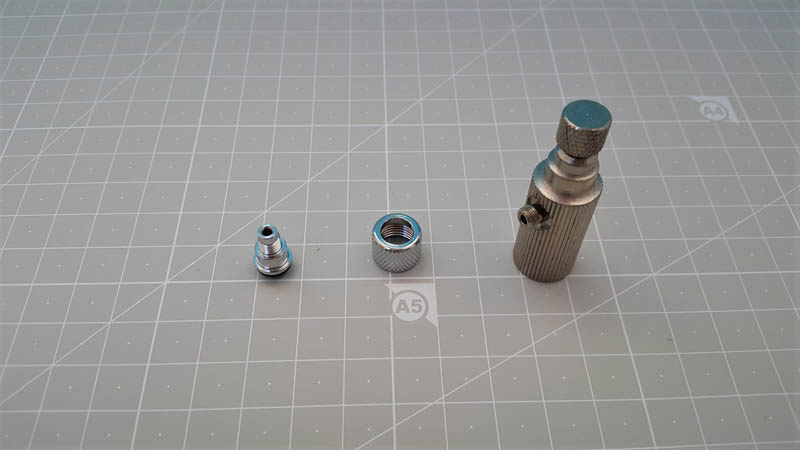

The other sheet is a leaflet-like instructions, with English translation of most of it. Here things are more serious. Installation for example, depending on what air supply you are using made great impression at first glance. If you are supplying with a can (something that I doubt anybody will want), there is a connection included in the set. If you are using compressor – there is another way. The one we all know.
The regulator beneath the color cup is explained thoroughly enough, for those who are stepping up and are using such airbrush for the first time. Nicely hinted is that if you are using metallic paints for example, you might want to play with it before you apply on your model.

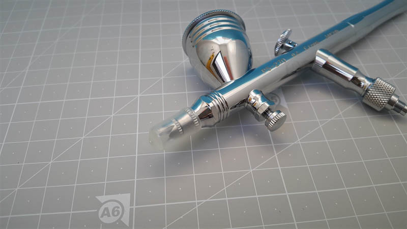

The airbrush itself is very very comfy. It Isn’t heavy, the trigger is soft-ish, but with just the right amount of force needed. At least judging from my personal perspective. Needle stopper is very light to operate with, which you might think can be an issue if you accidentally move it unwillingly. However, I found that this isn’t the case with PS-270.
The airbrush itself feels a bit longer in a hand than usual. Well balanced, a bit pointed in the front and definitely different than the most-widely used airbrushes. One thing I need to point out is, that if you are used to painting with both hands (when supporting the front while precise work is done), the fine regulator at the bottom of the airbrush might be an issue. But that goes for most of the higher-precision airbrushes and it is a matter of time and habit.
The trigger is round and a pleasure to be operated, somehow leaving you with a feeling of precision. Actually the whole airbrush does that, probably because of the quality of the tool itself. It reminds me a lot of old Olympos airbrushes, but here everything is refined.
The Crown Cap
The only needle cap available in the set is a crown cap. That screams precision of course and the whole look, with that sharp and pointy front end creates that feeling overall. The .2mm needle/nozzle combo is evidence that that was the main idea behind the PS-270.
I love working with crown caps, since they let the air go away and high precision work can be done without removing the cover of the needle completely. In some cases that is needed, but mostly, crown shaped cap does the job just fine.
