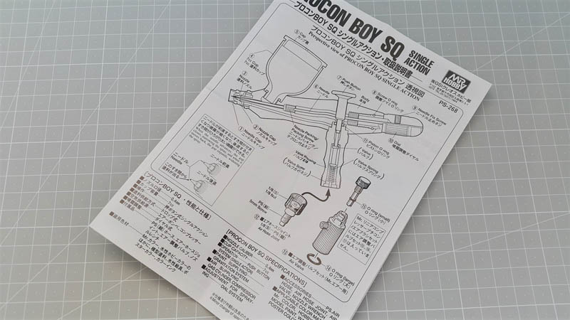

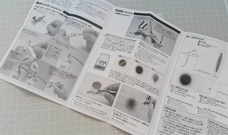

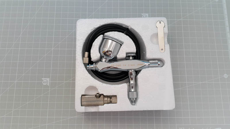

It comes in a box that is simple and it is designed mostly for store placement, made of thin material with a top opening showing the airbrush. Inside there are instructions, a Styrofoam holder for the airbrush and the add-ons. I have no idea how it is done with the colored versions, but the Styrofoam used instead of the regular foaming makes it look a bit cheap. Luckily, that has nothing to do with its performance.

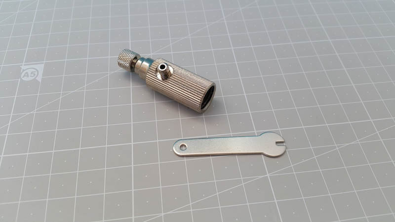

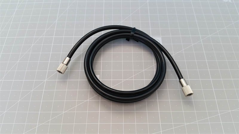

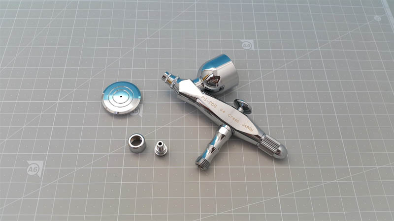

Inside of the box there are a wrench, a hose with small fitting, suitable for can air supply available from Mr. Hobby and a metal attachment, meant to be used with that can. That latter one has the same fitting as the hose and additionally the airbrush has a connection that converts it from standard 1/8 to the smaller fit mentioned above.
Airbrush and Add-ons

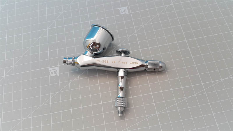

PS-268 airbrush is short and thick chunk of metal, with a weight of over 140 grams. It sits well in your hand and it is made in that modern short appearance, lacking the tail and featuring a design suitable for slightly different work. More often than not, people tend to press the trigger with their thumb here, probably led by the short appearance.
Apparently, that is a successful idea of engineering, since Iwata M1 and M2 Revolution airbrushes have similar appearance and rather high price, while still being a popular sellers. The performance is obviously satisfactory!
PS-268 features 7ml cup with a lid and .4mm nozzle. It has a swivelling tail, which is the end of the short needle and helps you adjust your nozzle aperture. Although limited, while used adequately, this gives you a decent amount of control over the spray lines. I have seen 24th scale Stuka with nice mottling, made solely with single-action airbrush, and far behind the quality of PS-268. Hence my point up there.
The add-ons are a bit controversial. The wrench is mandatory of course, but using air can supply is a heresy in my eyes for whatever application in scale modeling. I still bear the scars of the nightmares of Revell air can supplies, featured with their single-action airbrushes. They are expensive, ineffective and more often than not, left you out in the wild without enough juice to finish the work started.
So even though featured here, the hose, the transition on the airbrush foot and the air can attachment are useless for me. One must be very desperate to go down that road in my opinion. Well, if electricity is down for some reason or your compressor fails – maybe yes. But still. Sparmax offers compressors on batteries, so again – no thanks.
