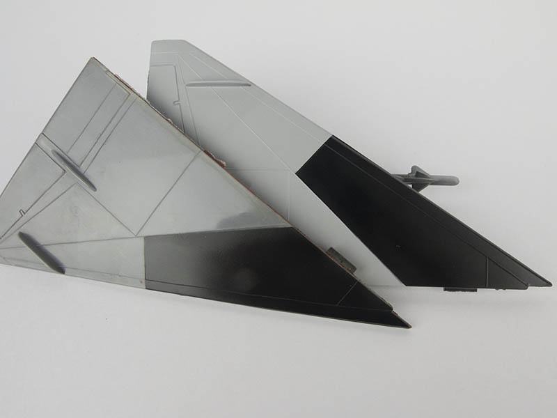

I found myself without a suitable test subject for this review, so I stripped the paint off the wings of an old paint mule, breaking them off in the process! I then sprayed one with a couple of light coats of Tamiya Fine Surface Primer (upper), and left the other in bare plastic (lower):

I decided to start by testing the airbrush performance of the unthinned paint, straight out of the bottle. I masked off a section of each wing, and put five drops of MRP-A012 Black into the airbrush cup. To my surprise, the paint flowed smoothly and easily, and quickly laid down a nice coat of paint, with good, even coverage:
Note that the appearance of there being two colours on the lower wing in the image above is a trick of light! There's some slight blushing evident to the naked eye on each wing, but I suspect that's a result of my perfunctory surface preparation, rather than any attribute of the paint itself.

I wanted to test the adhesion of the paint, over both the primer and the bare plastic, so I let the black cure overnight—roughly 12 hours or so—and then masked over it with full-strength Tamiya tape. Note that there's a recommendation on the bottles themselves to use a primer, but I'm happy to report that when I pulled the tape off after spraying the next colour, the black paint remained completely intact and unblemished in both cases.
The second colour in the photo above is MRP-A010 Zinc-Chromate Primer (WWII U.S.A.), but this time I added two drops of the MRP thinner to five drops of the paint, and painted in the triangular sections you can see on each wing. I immediately noticed a degradation in its performance. The flow out of the airbrush no longer felt as smooth, and the paint hitting the model's surface appeared to be more watery - too thin, in other words. I could achieve a decent finish with good coverage by really backing off the airflow, but I was surprised that the effect seemed so dramatic when adding so little thinner.

For the next test, I decided to try using my trusted go-to paint thinner, Mr. Color Thinner from GSI (Gunze). Using the same ratio as previously (two drops of thinner added to five drops of paint), I sprayed the yellow rectangular areas you can see in the photo above. Coverage seemed better, with a less watery result, but paint flow out of the airbrush was worse, with a tendency to spit or 'dump'.
