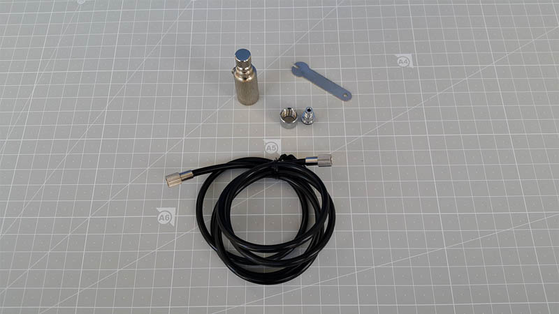

As with other Mr. Hobby airbrushes that I tested, PS-275 WA comes with a wrench a hose in the set. The hose is with smaller fittings on both of its sides and to fit the 1/8 on the airbrush, Mr. Hobby added a transition fitting, looking like the one you will have on your quick release valve. That is in case you decide to use Mr. Air can air supply. And for that last one there is another transition, with regulator and the fitting suitable for the hose too.

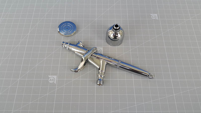

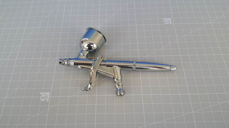

Procon Boy WA PS-275 comes in a size smaller than what I expected. It doesn’t have a handle in the box, like you get with Sparmax GP series or NEO TRN by Iwata, which makes it look even smaller. Last ones are bigger than a conventional airbrush, while with PS-275, we have a size even smaller, due to its length and very delicate appearance because of the trigger.

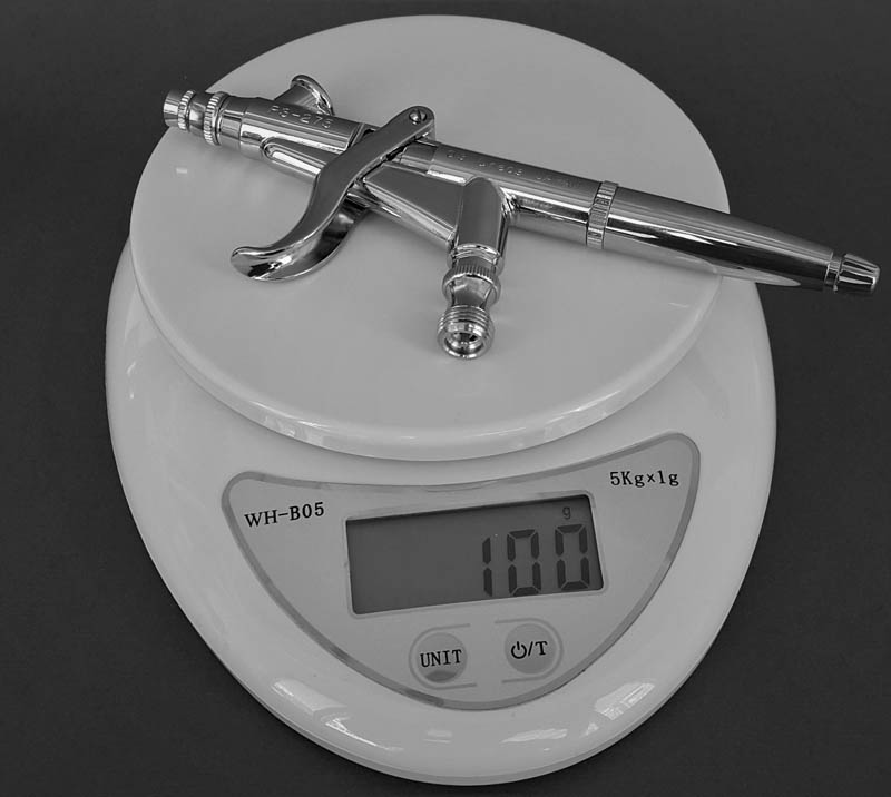

The weight of the airbrush without the color cup is 100 grams and with the cup 128 grams – grams. It can be used without it, in case only small areas are to be painted. The cup can be screwed in to the airbrush, but the bed holding it still allows for couple of paint drops to be used without the cup attached.
The other reason for the small size is the relatively shorter tail, featuring the trigger stopper. Most definitely, that was a decision based with the smaller appearance in mind, because making that part longer is one of the easiest thing to be done. Even if the weight increases, a cutaway still can solve that problem.

PS-275 comes with a nozzle typical for conventional airbrushes and that is .3mm. Probably the one that is most widely used. Performance-wise it is comparable with the other airbrushes featuring similar nozzles and that isn’t something unexpected.
The trigger here is what adds to that. If one struggle with the top-index finger control, here mastering the sole backwards movement of the trigger will be easier. First comes the air, than the paint and pretty much that limits the amount of errors that can be allowed. That is, not limiting the performance but still keeping it and that is the magic of the trigger style airbrushes.
