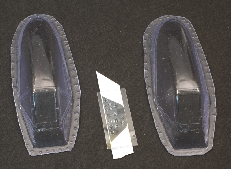

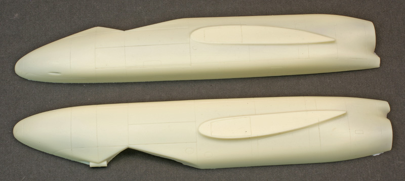

Primarily a resin kit, it is composed of 55 (by my count) resin parts, some brass rod, a pair of vacuform canopies, a piece of film with the instrument dials, and a small sheet of generic decals. No nose weight is included, they call out for about .88 oz of weight to be placed under the cockpit, and the design of the aircraft with most of the weight in front of the main wheels will not need much to keep it from being a tail-sitter.

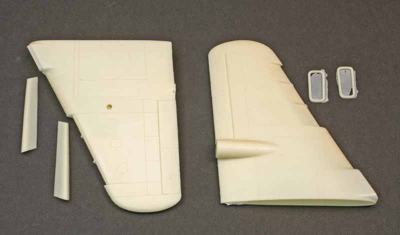

The resin is well cast, just requiring the usual clean up of flash and seams, plus the removal of a few casting blocks. The wings are cast as single pieces with about the first third hollow. Details look good for the most part though some repair of small details and panel lines may be required. Separate leading edge slats and intake rims are provided. Ailerons are fixed in a neutral position.

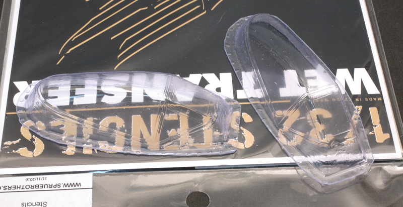

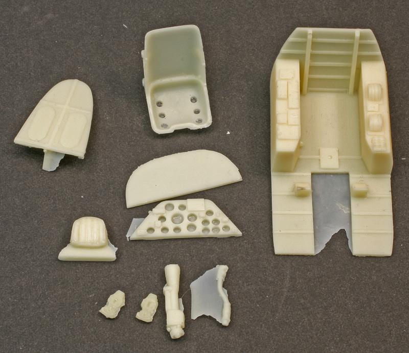

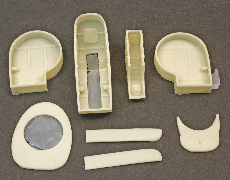

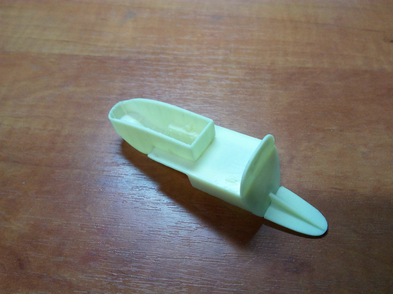

The cockpit is pretty basic. It appears to be based on the wood mock up of the design which from photos show just the essential components installed. The right side of the cockpit only had wooden shapes with controls drawn on. LEM includes some photos, I think from the internet, more than the few in my Luft ’46 reference books, to help the modeler. If more detail is desired, especially on the side walls above the consoles, I suggest (and plan on doing myself) adding detail items based on the Fw190D or Ta152 series of aircraft. I would definitely replace the rudder pedals with some PE types as the resin just don’t do them justice. The sandwich style instrument panel should look pretty good. The two vac canopies look quite clear and should really sparkle with a dunk in Future. From photos in the references, you may want to add a cylinder to the rear of the canopy, which was supposed to help fire the canopy off in an ejection. The photos show a framed canopy instead of the bubble canopy provided, but as this is a what-if aircraft do what you want. References also show fuel tanks behind the pilot so maybe add some filler caps back there, as well as on the rear spine behind the canopy? You will also need to add your own seatbelts.

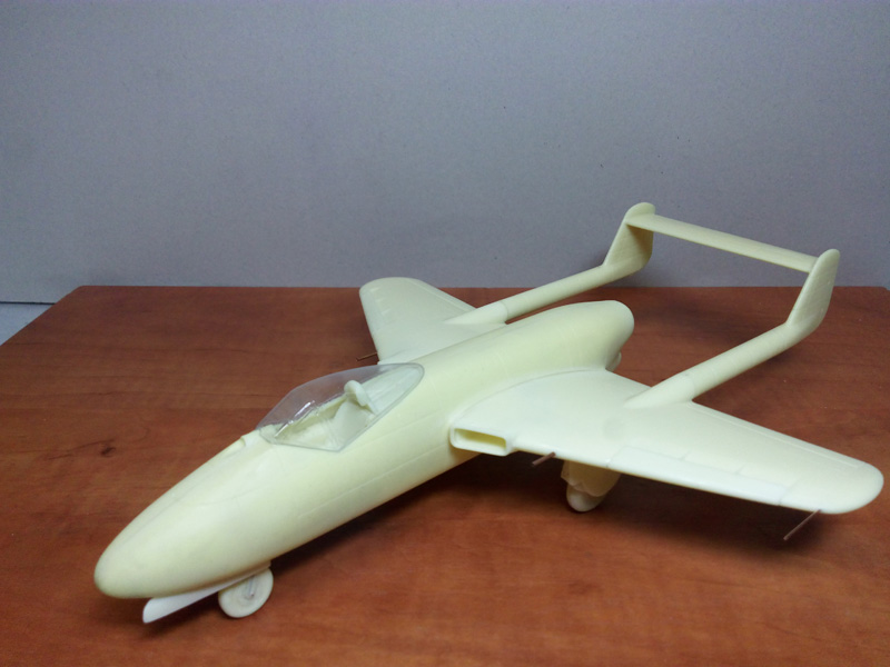

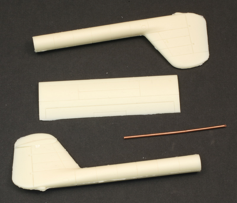

The tail booms are separate parts combined with the rudder. The elevator is mounted high between the two rudders. They are best pinned together, and the assembly then pinned to the fuselage. A length of copper wire is provided for this purpose. A jig would come in handy to keep everything aligned.

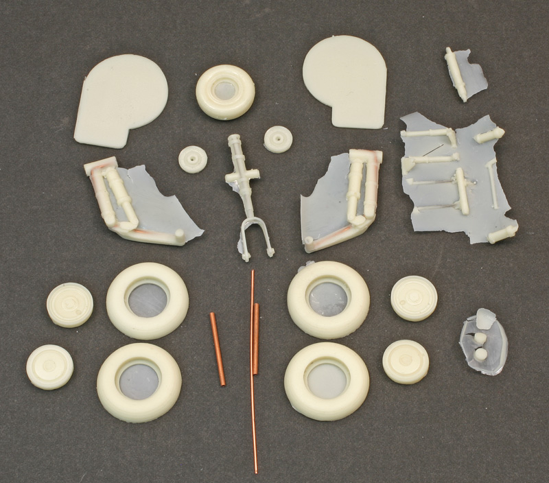

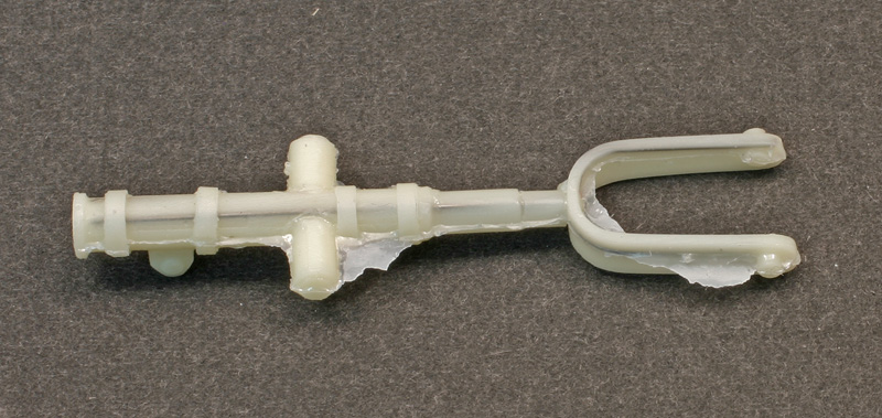

The landing gear consists of several parts. The gear itself is resin with metal wires cast inside for strength. You can see them in the photos, but it doesn’t appear they poke outside the resin anywhere. There are several actuators to add, and lengths of rod are supplied for axles and piping. The wheels look pretty good with light tread detail, but the mainwheels are cast in halves which I hate and hopefully tread detail won’t be lost while working the seams.
Wheel wells are separate and have nice structural detail in them, though no piping.

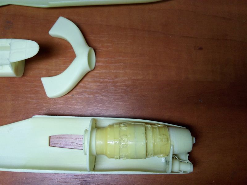

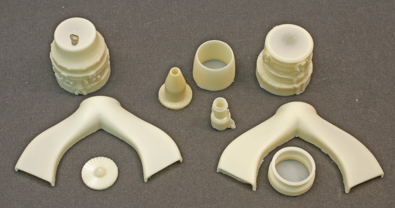

Nine parts make up the engine an its intakes. The intakes are split in two thinned-walled halves which should make smoothing the seams interesting. The engine seems well detailed with piping and fittings cast on the exterior of the parts, although the interior is smooth. Thankfully the engine parts are not split in halves so no seams to worry about. A fan face is also provided to defend against the dreaded pen lights at the competition tables. The small nozzle represents the rocket engine outlet. A couple of bulkheads are also included to help align the engine and strengthen the fuselage assembly.
