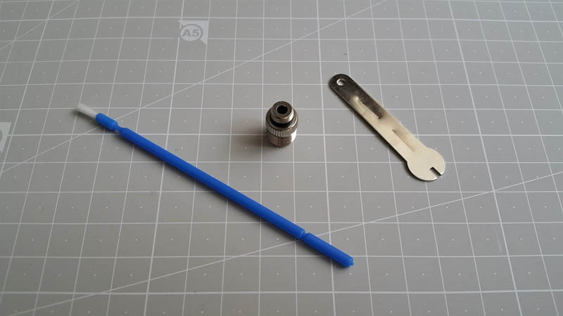

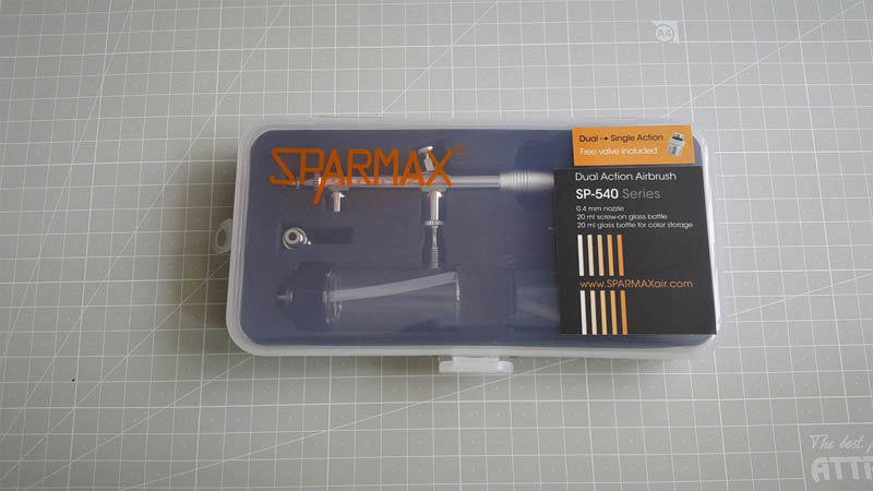

The boxing is simple plastic clamshell with transparent appearance. It holds the airbrush, a wrench, a dual-to-single action transition valve, one screw-on 20ml bottle and one additional bottle, exactly like the first one, but meant to be used for color storage. There is also an instruction sheet on the bottom and a cleaning brush, made from blue plastic and synthetic material, great for cleaning the tip or paint residue on the needle cap.
The clamshell has a hanger outside and a foaming material inside, so you can easily hang your airbrush on your tool wall and be sure that nothing will fell from its pre-determined position. All this is rather light in weight. In total, everything described above weights 193 grams. The airbrush with the bottle weights the surprising 91 grams and without it – only 72 grams.

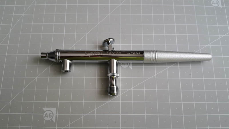

Sparmax are famous for their top feed airbrushes. SP-540 is a bottom feed one. It has the classical shape of such a tool and the biggest benefit from my point is the screw on bottle. The bottom feed airbrushes with non-screwing paint containers are very risky in my eyes. Spills are possible, but worst of all are the chances of loose attachment of the paint cup. Even though that can be predicted, sometimes accidents happen. With the screw this is impossible.

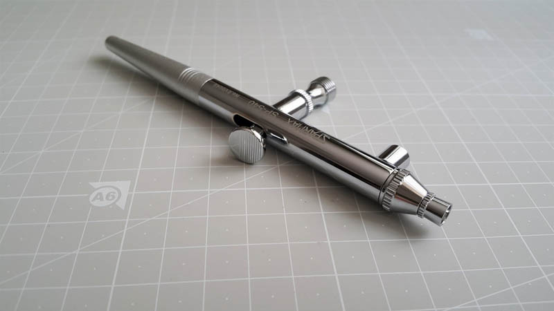

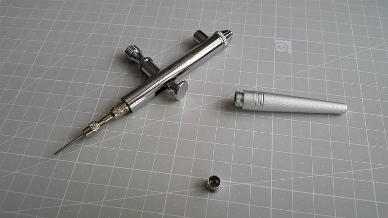

There is a simplistic and odd looking tail covering the back end of the needle. It is not made from polished metal and does not have a tail stopper. By itself, this is the only thing that gives out the idea of this airbrush being at the lower end of the Sparmax tools. It doesn’t look that posh.
However, even though SP-540 was contemplated as a starter or general purpose tool, in the hands of experienced painter, it can do a lot more. The needle is .4mm, which is exactly the same as the Sparmax MAX 4. The latter one is considered a high-end tool though. Of course, it is also sold as MAX 3, which has .3mm needle/nozzle set-up, but still one can get the idea.

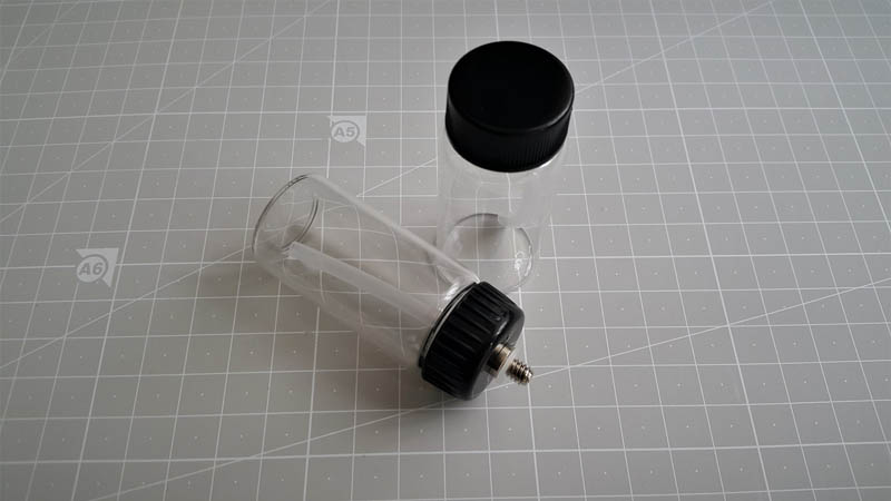

The other things that gives out the design ideas implemented in SP-540 are the 20ml color bottles. They are way too big for precise work. Those combined with .4mm on the other hand are perfect from priming and varnishing a model, especially one from the Large Scale realm. The nicest thing about the bottles is that they are made from glass, not plastic. Plastic ones tend to fog with time and the real paint color and sometimes even level are hard to be seen. Not here.

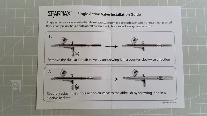

The single-action transition is also something that can be used in priming/varnishing direction. Especially with Alclads or any other metalizers or clear coats, where the amount of medium needs to be as even as possible.
