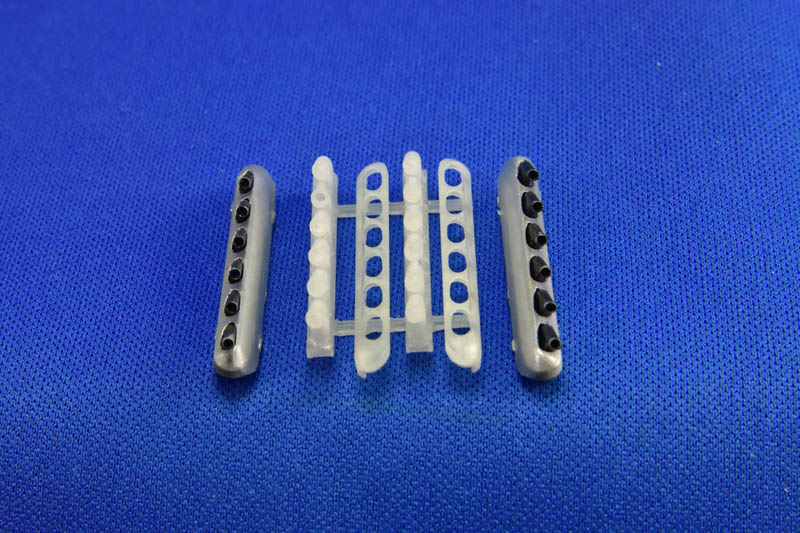

The new set includes the exhaust shrouds as well as the exhausts themselves as seen below:

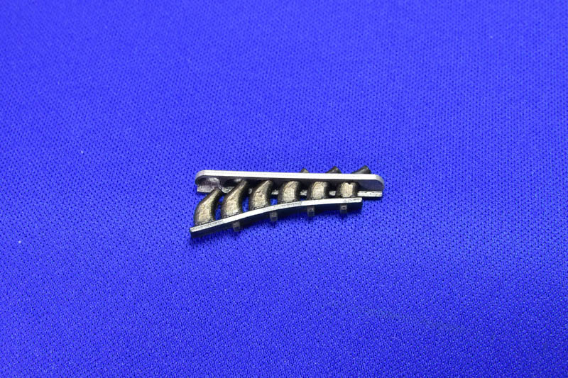

The shrouds can be installed from the outside (making masking so much easier!) but the exhausts themselves differ slightly from the original exhausts. The main difference is that the mounting plate for the exhausts is both narrower and shorter than on the original exhausts which may be seen below:
![](/reviews/images/2109/2109-6.jpg)
For the original exhausts it seems to be necessary to slightly shorten the front of the mounting plate – which helps with mounting them in the correct position on the aircraft. All of the positioning lugs on the bottom of the mounting plate should be removed as well.

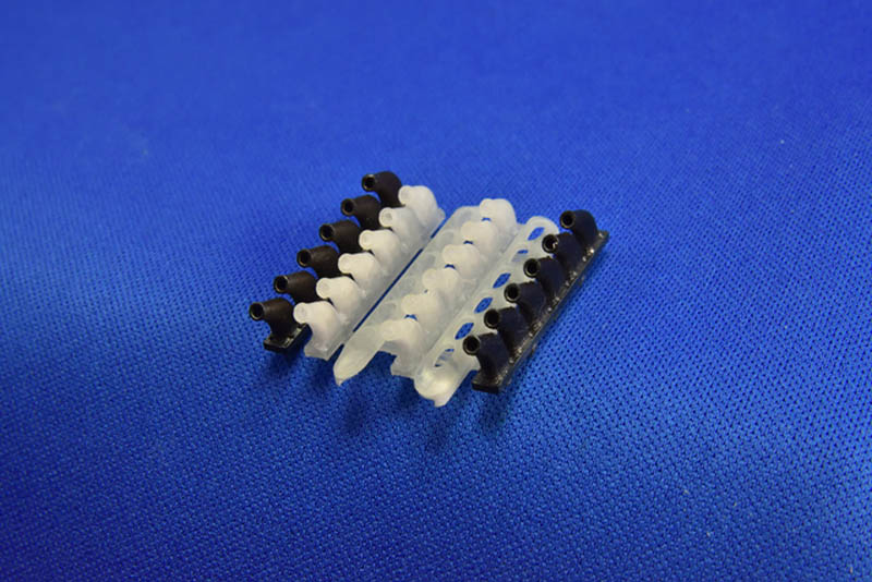

Here is a picture of the unprimed shrouds, with the original exhausts fitted:

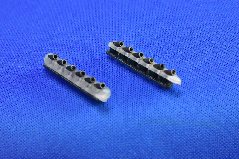

And compared to the Eduard exhausts in the kit shrouds:
![](/reviews/images/2109/2109-7.jpg)

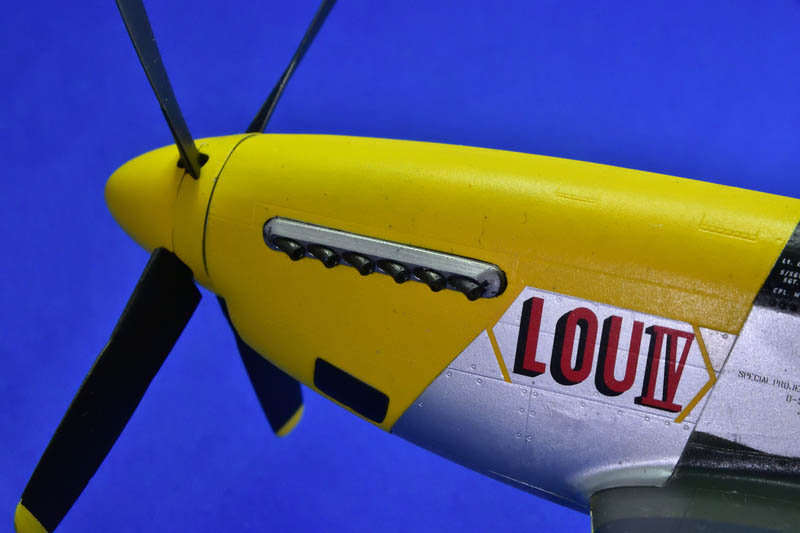

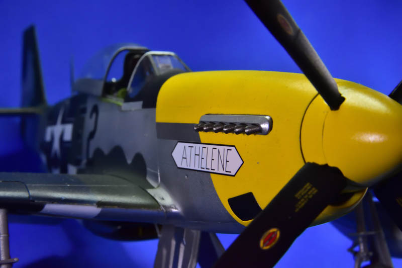

The Model Monkey exhausts are rounder and larger than either the kit exhausts or the Eduard exhausts and I think look better. Here they are installed on my Revell P-51D Mustang:
![](/reviews/images/2109/2109-4.jpg)
![](/reviews/images/2109/2109-5.jpg)

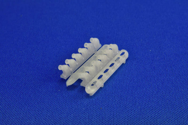

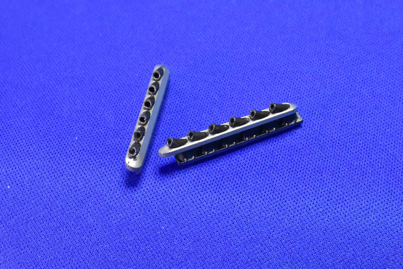

What I found is that the exhausts do not just slip into the shrouds as do the kit exhausts or the Eduard exhausts – rather a method I found works very well is to slightly bend the exhausts to help align the individual exhaust tubes as shown in the picture below. I found they go in much easier this way (actually, it’s the ONLY way I’ve been able to get the exhausts to fit).
![](/reviews/images/2109/2109-2.jpg)
