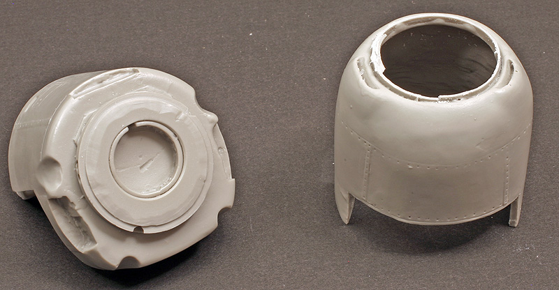

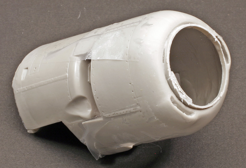

The conversion set consists of 23 resin parts, plus a new vac-formed canopy. The largest parts consist of the new cowl and accessory compartment, a major re-work of the F4U-7 parts. There are a few wobbles to the curves that could be smoothed out, but Karl did a nice job re-doing the exhaust cutouts and cowl intakes to represent the F4U-5 variant.

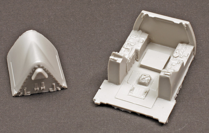

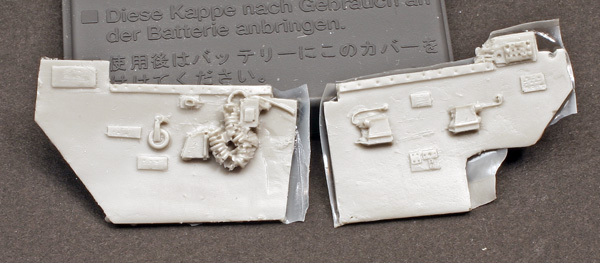

The cockpit and the fuselage insert for the raised canopy is pretty close to what was offered in the original F4U-7 conversion. The cockpit has the correct features of the -5, although the details are a bit soft. The oxygen hose, which is something I believe Karl added, did not survive the casting process well in my example. I think that is because my copy is a later casting as I have seen earlier castings where it looked much better. The voids of the hose no doubt create problems for pulling from the RTV molds. No big deal as that detail is easily removed and replaced with new hose. The softness of the sidewalls and detail on the consoles can be cleaned up with careful knife work and painting.

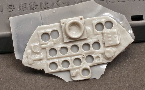

The instrument panel has been modified to include the radar screen and Karl did a very good job with it.

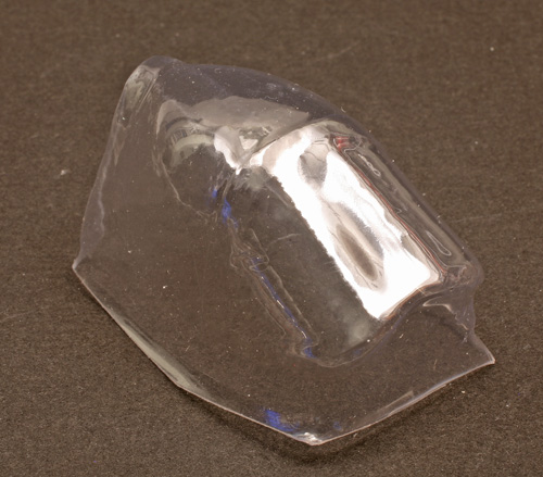

The vacuform canopy looks to be the correct shape and has good overall clarity. There is a bit of graininess on one side, but it will not be that noticeable if left in the open position.

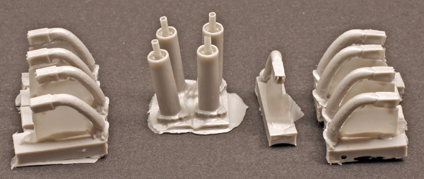

The new exhausts look very nice and have the correct flash suppressors. The 20mm cannons also turned out very nice. Rocket stubs are left to the builder to scratch build. See the link to Karl's build below to see how he made them.

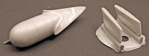

Harold created the -5's version of the radar pod and it turned out very nice. The two large, inner pylons also are included.
