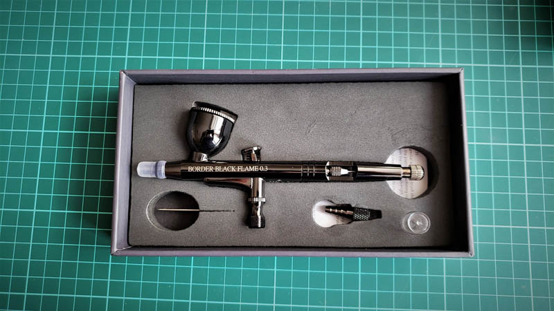

Border airbrush in question is called Black Flame and this sample is apparently version 2.0. It comes packed in a nice and sturdy cardboard box, made from quality materials. It is thick and it is far better than the regular box that you get your airbrush in. At least visually.
On the sides and the back of the box there is additional information about the airbrush, including basic airbrush parts guide on the bottom of the box from the outside. Inside, there is some foaming insulation, separating the airbrush from the top of the box and of course, a bed designed specifically to hold this particular airbrush.
There is a semi-transparent front end cap, covering the business end of the airbrush, and a small plastic container holding an additional crown cap. There is also a wrench and a braided transition for those who use regular pneumatic hoses and not specifically airbrush-oriented ones. Aside from that there are instructions on the bottom of the box, beneath everything else.

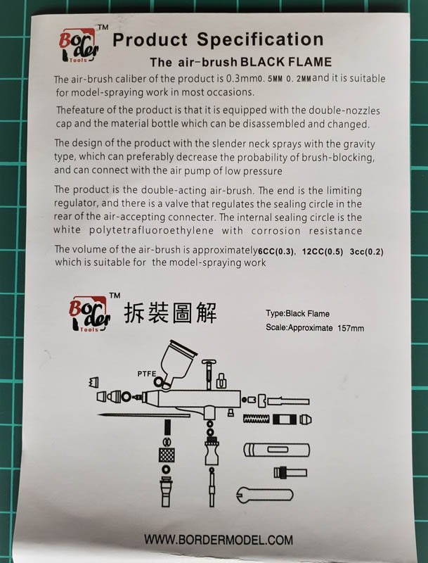

Instructions
The instruction sheet is double sided and is more like a leaflet with basic info. On one of the sides everything is written in Chinese and on the other there is a translation in English. Unfortunately, the translation resembles the old Trumpeter box descriptions. Something that was being done without the proper attention.
There is also a QR code with additional information about the airbrush, which hopefully you’ll be able to use scanning directly from the pictures here.
The instruction sheet in general is a let-down, but bear with me for a little longer to see the overall conclusion. It is quite different in the end.

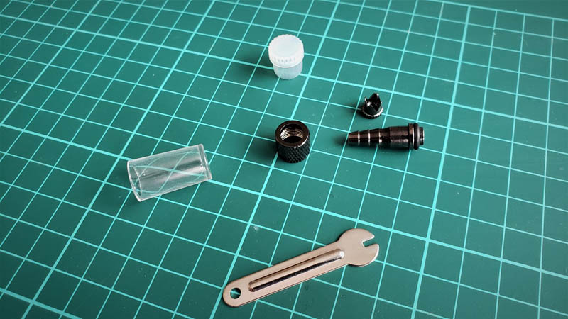

Add-ons
As mentioned above there is a transition for attachment to a standard pneumatic hose, which many will find useful. Somehow this became a standard for many airbrush producers and Border did their part accordingly. In my opinion this is clever, because it allows for quick connection of more than one airbrush to a single compressor and with minimal investment. Besides, with the clear pneumatic hose any moisture is quickly visible, unlike with the braided non-transparent airbrush hoses that most of the companies offer.
The wrench included is something that does not need any comment or attention, especially considering that most of the people reading LSP articles are already experienced enough and know their way around airbrushing and modeling in general.
There is a crown cap on the other hand, which is something that I value in an airbrush set. It costs some decent money if we are talking major airbrush brands, and only few others offer their sets with one provided for free. However, this is indispensable add-on, especially for those who like to spray fine lines.
Many will remove everything and spray with bare needle tip, but that is too risky and in time, it will cause some mishaps. Here the crown cap comes to the rescue and luckily, we have some in this set, packed neatly in a small transparent container. It allows for the air to escape around the cutaways, permitting close and more precise work. Also, it keeps the distance from the needle to the surface protecting the most precious thing in any airbrush: the needle tip.

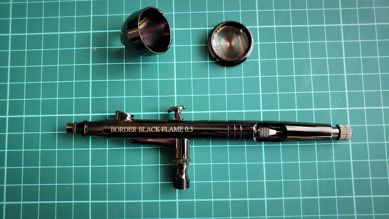

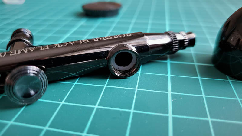

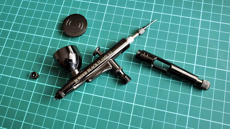

Border Black Flame ver. 2.0 looks very attractive because it comes in black. Aside from the color though, it is pretty much the standard looking airbrush, which you can get from Iwata, Sparmax, Grex, Mater or any other airbrush maker.

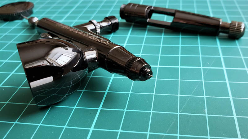

There is a standard nozzle cover at the front, a tail cover with a cutaway on the back and removable paint cup on top. The paint cup has a lid and an interesting addition, non-typical for other airbrushes. That is the Teflon O-ring that you can find once you remove the main cup. A smaller /part of the main body/ color container is embedded, which can be used for short and quick spray sessions, holding only few drops of paint. Not sure how exactly the Teflon seal will help with that, but probably when some time passes, it will help sealing better the connection in between the body and the color cup.
The cup itself has a nice coating, although I can only speculate about its service life. Some coatings look brilliant but they are worn out quickly, while others are not-so-good looking, however they seem indestructible. Only time will tell which one of those is applied here.
The lid of the color cup fits nicely and compared to any Chinese cheapo, you can immediately tell that there is significant difference in quality.
The other thing interesting is the tip of the nozzle cover, where you can find the needle. It has somewhat different appearance compared to the regular airbrushes that I use. They are more round, while with Black Flame, we have flatter surface, just where you can find the needle tip. It might be just an appearance trick, or a designer’s decision. All I can tell is that it looks different.
Overall craftsmanship is very good and once you put the color cup in and get the airbrush in hand, you can hardly tell that the cup is removable. There are no gaps in between parts and everything looks pretty nice. Which leads us to the next part:

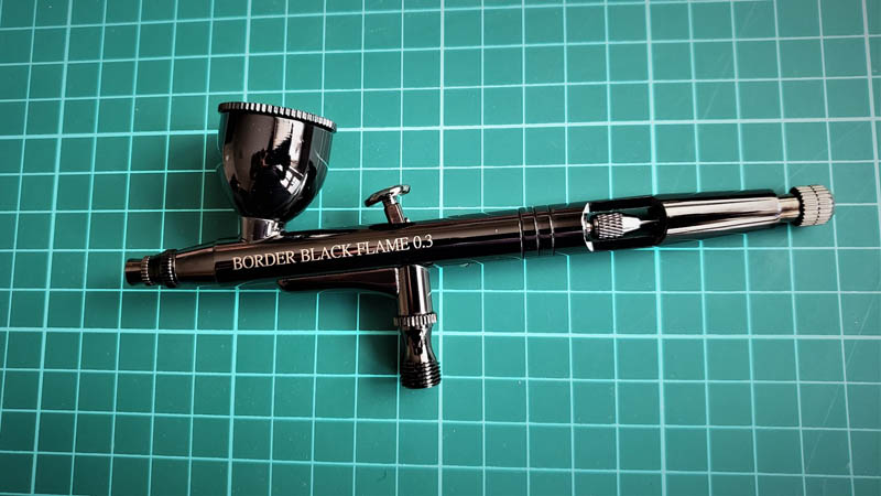

Trigger, Stopper, Ergonomics
The trigger is round, without cutaways for position orientation. It resembles a single-action airbrush trigger. It moves freely and again, good craftsmanship can be felt from the get go. This might not be the case for each and every Black Flame airbrush, but just for the sample that I have. However, considering the quality of the rest of Border’s products, I would say that probably they will do just fine.
The tail stopper is something that is valued in an airbrush. Last airbrush that I had for review had a faulty one and it was quite annoying. On the contrary here, the stopper works perfectly fine and the threads are nicely done. The movement is smooth and trouble-less. The trigger is stopped properly once you set it up and you shouldn’t expect any surprises.
With the above mentioned, I can only say nice things about Border. However, I have to add that in order to get the best out of your airbrush, you should not forget to lube it and fine tune it before starting the work with it. Especially if this is going to be your main airbrush.
Ergonomically, it is pretty standard. I cannot say much more, because I am used to this type of airbrushes and I have no troubles working with it what so ever. It is heavy enough to provide you with nice grip, but not overly heavy to tire your hand in long spray sessions. Also, removing of the cup does not cause any significant imbalance, which is very important from my stand point.
