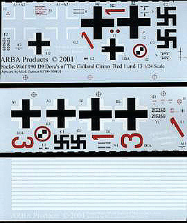

The parts include the following items. Left & Right engine cowling, left & right tail section with the fuselage extension molded in, new radio and fuel hatch, new rudder, upper gun decking, radiator gill ring, radiator grill and cowl, new spinner, three keyed prop blades, exhaust stacks, lower cowl and wheel well, DF loop antenna and mount, YZ 16 antenna, new wheels with manufacturer name and tire size molded in, and the super charger intake.
There are also two COMPLETE sets of decals for two different aircraft from Jagdverband 44. Red 1 w. nr. 600424 and Red 13 w.nr. 400240 with the correct style crosses and pilot's motto's on the fuselage side. The decals are of the individual variety and are extremely thin so they appear to be of the type that have been coming out of the Czech Republic. The art work was done for ARBA by Mick Gannon.
Also included are the underside white striping for the red undersides. I cannot say how this set goes together as I have just received these for resale , but if I hear anything I will definitely pass it along. As a comparison to the J. Rutman set I can only go by what I have seen of Jerry's set on the web.
I know Jerry's products as I have purchased a few of his sets and am very pleased with my purchases. Both sets have their plusses. Jerry's set is very well detailed and includes a detailed wheel well set the rear engine accessory area and the fuselage stiffeners.
The ARBA set has what I think are better exhaust stacks, the perfect keyed prop blades which will give you a perfect prop pitch on all blades instantly, and the beautifully done decal sheets.
