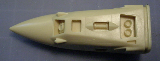

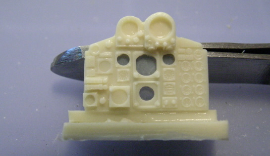

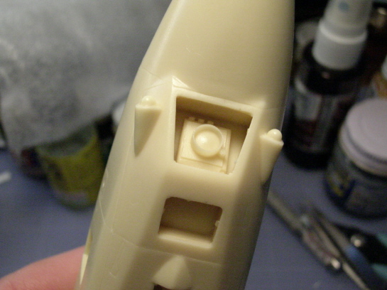

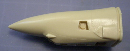

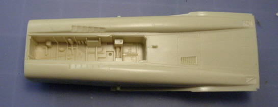

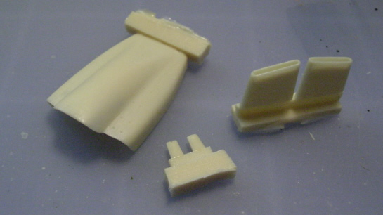

Black Box has released a conversion for those who wish to build a 1/32 reconnaissance Phantom, but prefer the Tamiya kits to Revell’s. This set is intended for the F-4E kit, but it looks like it can also be used to build an RF-4C using the F-4C/D kit. The set includes two massive castings for the nose and lower forward fuselage, two air-conditioning intakes, clear plastic sheet for camera windows, new instrument panel, and a new instrument panel coaming. My set also has two small parts that look like TACAN antennae but are not mentioned in the instructions. New nose gear doors are not provided since the flat doors from the C/D kit are still included in the E kit. All of the parts are cast in Black Box’s typical high quality, with only a few small flaws in the large nose casting. These can be easily removed with a couple of swipes from a sanding stick. The corners of the lower fuselage section also had a couple of small bubbles that can be easily fixed. The camera fairing under the nose is the early, angular version, and the overall shape of appears to be accurate. The instrument panel has nice, sharp detail and includes a cutout in the back so the kit clear parts can be used.

- The instrument panel coaming is missing the ribs that cross over the top of the RF-4C’s coaming, although they are shown in the scale drawing. I wasn’t able to find a good photo of this area on an RF-4E, so I don't know whether or not the ribs should be there for this version.
