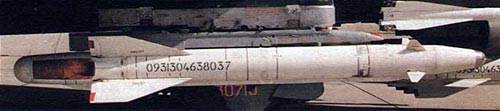

The Soviet/Russian Kh-25ML is a variant of Kh-25 series of air-to-ground missiles. The missile is equipped with a semi-active laser homing seeker head and carries a 198 lb (90kg) warhead. The target is laser designated by the carrier aircraft, another aircraft, or target designators on the ground and the missile.
![](/reviews/images/32/09.jpg)
The NATO reporting name for the Kh-25ML is AS-10A “Karen” and it is the Soviet/Russia equivalent of the AGM-65 Maverick. The Missile is used on the MiG-23/27, MiG-29M/K, Su-22M, Su-30/33/34/35, Su-25, and Su-24, and various other Soviet/Russian aircraft.

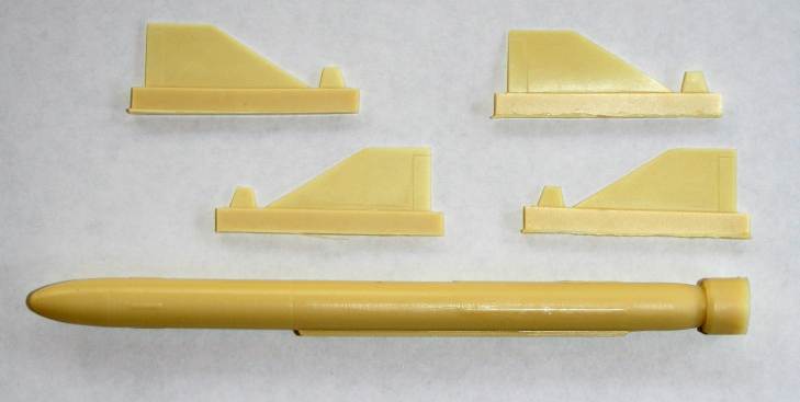

Here is my review of CAM's 1/32 Russian Ch-25ML Missile set. This is one of the newer resin sets in CAM's line. My goal here is to give a fair and honest review. It is what fellow modelers expect and deserve.
![](/reviews/images/32/02.jpg)

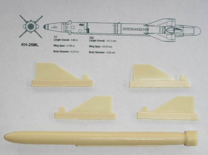

The proper designation of this missile translated from Russian should actually be "Kh-25ML". But as you will see that is just the beginning of mistakes with this set. Here are my observations:
1. The missile body is far too long by 15.5 mm. That would extend the realKh-25MLby almost half a meter.
2. The diameter is too wide by a very visible error of 1.5 millimeters. Fattening upthe actual Kh-25ML by about 4.5 centimeters.
3. There is no representation what so ever of the rocket nozzles on the missile sides. The rocket nozzles are very prominent features on this missile. Omitting them is beyond unacceptable.

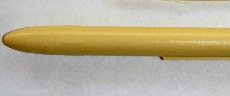

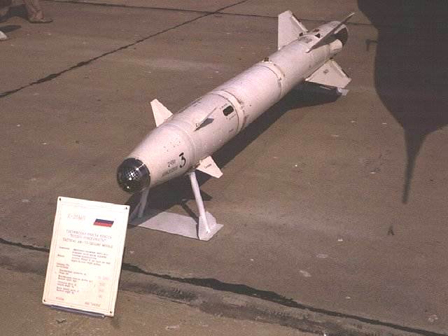

4.The seeker head does not even remotely resemble the actual thing. Seeker heads on the Kh-25ML are distinct for this variant being tapered not rounded and this took some effort to get so dismally wrong if any references were even actually used.
![](/reviews/images/32/04.jpg)
5. The distinctly rounded base of the missile is not represented. Instead, the base is flat and attached to a pour plug.
