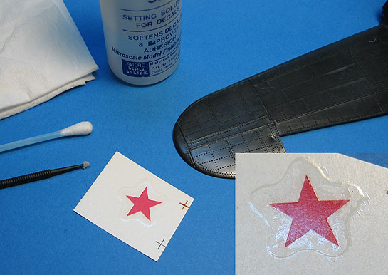

You may be wondering: 'Ok, just another swastika decal sheet'. Nope. This sheet belongs to the FCM Elite decal series. So what? Well, the first thing you note in these Elite decals is an awful, rather thick clear decal film, like if a pool of Future has dried over each decal.
This is not incidental: The clear layer is designed to be removed once the decal is dry!!! You apply the decal like any other, but the instructions advise you to avoid setting solutions. Once applied, the stuff looks like those temporary tattoos. You can clearly see the overly thick clear film around the printed layer:
Don’t panic. Wait it to dry for 24 hours. Then use a hobby knife or your favorite tweezers to lift the border of the clear film, and carefully remove it from the printed layer:
If you do everything right, only the printed artwork will remain over your model.
Well, this is what makes this type of decal so different. When correctly applied, there’s no clear film to bother you.
Now the bad news: I found the method very difficult to work in areas with raised surface details (panel lines or rivets). In these cases, the thick film resist to conform the surface, and as a result some chipping (of the printed layer) occurs when you remove the film. Maybe I should ignore the instructions and use some mild setting solution. I'll make a few more tests and keep you informed. All in all, I had success in three out of each four trials. Maybe it is just me. I have been talking to some folks and I discovered that this is one of those hate it or love it stuffs. The 1/72 guys reported almost 100% success (probably due to the small size of the decals), while 1/48 and 1/32 modelers are still complaining. Anyway, in my faulty tests it was just a matter of retouching the (small) chipped areas, and the absence of a clear film to bother you may compensate the extra work.
